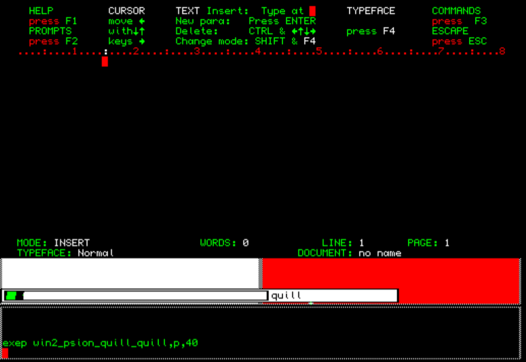

Now I might be wrong, but last time I used EXEP it was particularly useful to limit the ram grab from PSION programs. However, it seems to matter what I try on QPC they still grab most memory available.
Shouldn't the following just reserve 40k for Quill?
exep win2_psion_quill_quill,p,40
...I'm probably missing something totally obivous, right?

NormanDunbar wrote:Maybe this helps?
thanks Norm - right, this is the expected behaviour I'd like to see, what I see with QPC (4.05, SMSQ/E 3.28) however is this:

I know - still I'm curious why/if exep isn't working here...
Posts: 2492
Re: EXEP on QPC
Maybe there's a problem with how EXEP collects the RAM parameter off the stack, or works out how much free RAM there is?
Just thinking out loud.
