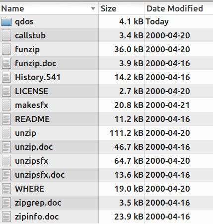

I unzipped the "unzip541xq.bin' file in my Windows 7 computer - this is the easiest option to me. Its output is a folder named as upzip541xq with various files.
I have transferred the whole folder back to my Xubuntu laptop. Inside the folder, there are these various files (see screenshot below) and one of these files is called unzip which is what I need.
My next challenge is how to run the unzip command inside uxql2017 emulator.
I can map the upzip541xq folder to MDRV_1 or whatever.
I can also put the four zip files of Abacaus, Quill, Easel and Archive (Psion Suite) inside the same upzip541xq folder too.
What commands inside the uqlx2017 window do I need to run the unzip command to unpack the four zip files of the Psion Suite?

Good evening !

Re: Xubuntu 16.04 and uqlx2017
Evening drdtyc,
as the QL executable files need data from the file header, unzipping on Windows/Linux will lose said header. The files are effectively unusable.
You must copy the file, as is, to your uqlx and lrespr, or alchp, lbytes, call it to self-extract a working
QL executable plus all those support files.
Try that first.
Once working try exec unzip --help (or -h or -?) or with no parameters and it should tell you what it is looking for on the command line.
Try that first.
