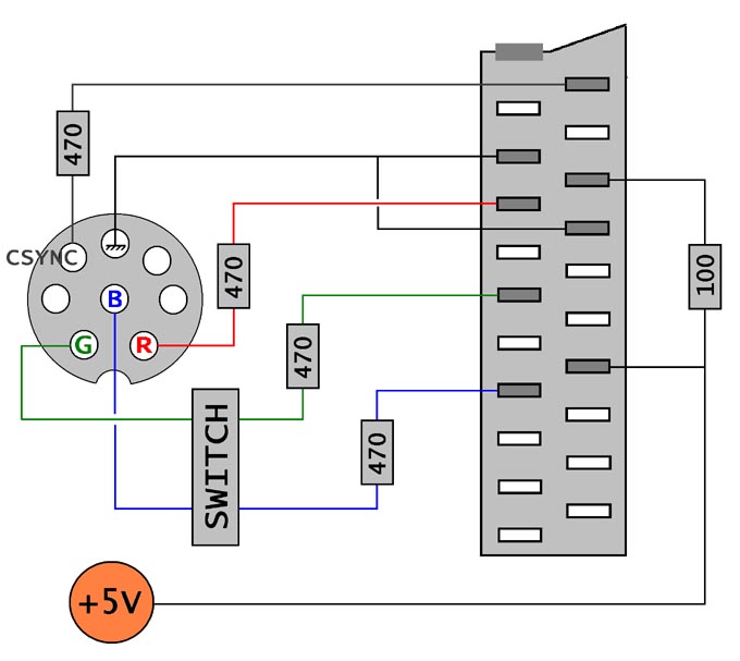

Hi all,
This is my SCART cable, I built two of them (for both my original QLs) and they work well (on ancient TVs and also on all my recent flat-screen TVs).
Two things to be noted :
1/ you need a 5v on some pins of the SCART. I picked it inside the QLs and output it on a supplementary plug beside their video output.
2/ I added a "SWITCH" to exchange the green and blue signals, for stereo graphics using red/blue goggles.
May the forth be with you !
Polka
