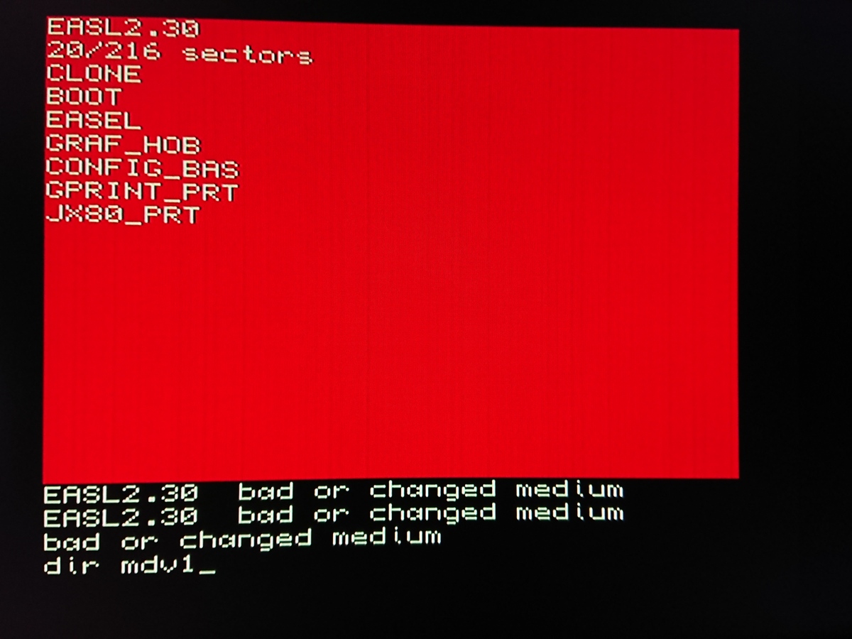

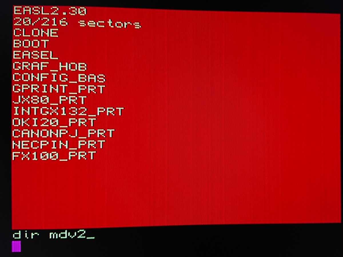

Anyway I also wanted to try again cleaning my MDV1_ and I had some results... now the microdrive reads something like in the "MDV1_ picture"... the cart is ok since it's correctly readable by MDV2_ like in the "MDV2_ picture".
I have check what's in the 3d you sent me everything seems ok:
1. the cart felt is ok;
2. I have cleaned twice the heads;
3. the roller seems in the right position but it also seems is more slicky and a bit smaller than the one of MDV2_.
My idea is that surely the heads had (are?) to be cleaned very well but also the roller could be an issue and I do not want to make strange tests risking to ruin the carts!
I have used alcool to clean the head: what do you think? Other suggestions?
Apart other ideas about the cleaning process, now I wait the new MDV1_ with the fear about the difficuly about mounting it!
Thank you
