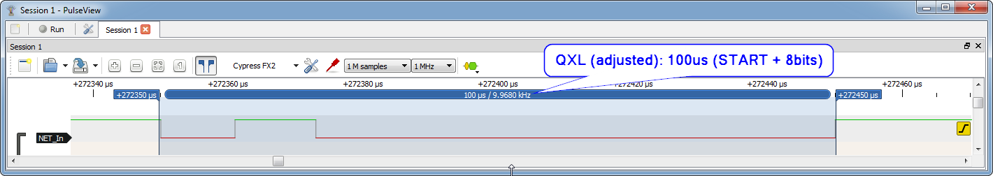

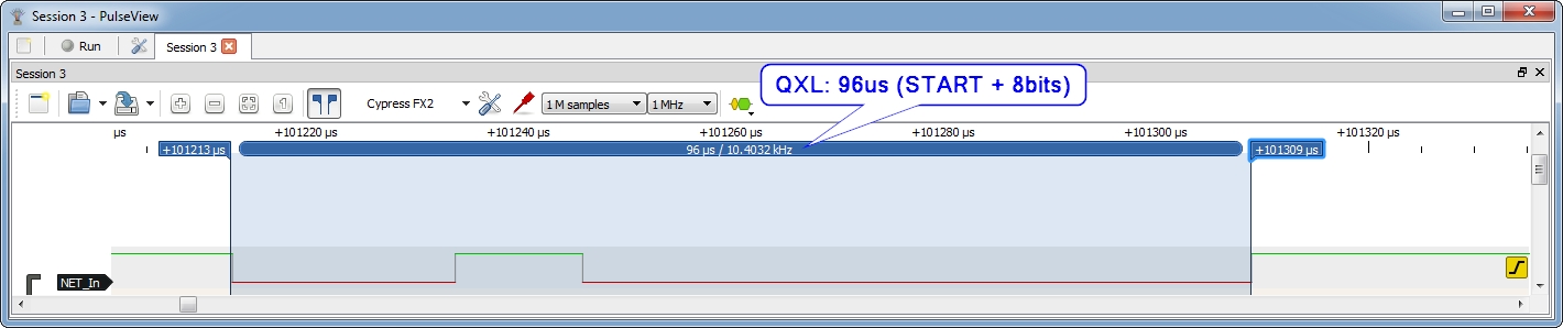

Attaching my cheapo digital analyser, I see that the bit-timings are just a bit too short to allow reliable connection with the QL. By adjusting the timings on the QNET/USB adapter, I can read the packets from the QXL OK. The difference is just 5% off - accumulatively (?) half a bit-time after 9-bits (START+8-bits) - and just enough for the receiving QL to misinterpret the STOP bit as the final/MSBit of the sent byte.
QXL also delivers a relatively shorter set of STOP bits, but the QNET protocol takes that in its stride.
See attached screen-captures - the nominal QNET bit-timing is 11.2us, resulting in 100.8us for the 9-bit (partial) frame. The QL meets this, but the equivalent QXL frame runs to only 96us. The sample rate was only 1Mbps, so to the nearest 1us...

With thanks again to Wolfgang in identifying a further adjustment to the start of the NET timing-constants table (ndt_ctab) held in the DDB of the NET driver, I can confirm that an adjustment of 5% to each of the timing-constants allows successful net operation on the QXL.
Whether the original timing error was specific to my QXL card, or might be relevant for other QXL users as well, I can't say, but for the record I present here the original and adjusted timing-constants as held in the DDB:
Note that the adjusted constants here may not be 100% correct - but sufficient to get the network running again.
Here's the end-result: Here's also the SBASIC I coded to make the changes directly in the DDB: My next step would be to update the QXL SMSQ/E source and re-compile with the adjusted timing-constants (not what you see above, but the original micro-second values that are used to calculate the final values.) But that's for another day.
