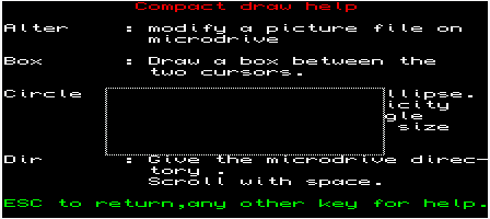

From within a SBASIC daughter job. I want to start another SBASIC daughter job, which auto runs a BASIC program.
Leaving the original daughter job running.
I am using EXEC program_name_bas to start the new SBASIC program
The problem is it starts with a window (#0) drawn on top
If I press any key to to get the next page, then the window disappears
And does not reappear again, unless I BREAK into the program.
Can I start the SBASIC daughter job without the #0 window appearing?

SBASIC operation is quite complex. Briefly, however, depending on how you start up an SBASIC daughter job, unless you explicitly open the three default channels, any IO sent to one of those channels causes channel #0 to be opened and the IO to be directed there. Thus PRINT or PAUSE without an explicit channel number will cause the channel #0 window to appear, as shown in your first illustration.

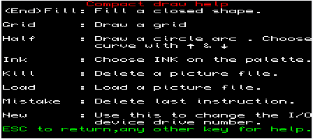

Here's the start of the program
10 DIM var87C4$(1) : OPEN #1,"con_448x200a32x16"  : PAPER #1,0  : INK #1,7  : BORDER 1,7  : CLS  : CSIZE #1,2,0
20 INK #1,2  : AT #1,0,10  : PRINT#1,"Compact draw help"\\ : INK #1,7
30 PRINT#1,"Alter    : modify a picture file on"\"           microdrive"\\"Box      : Draw a box between the"\"           two cursors."\\
40 PRINT#1;"Circle   : Draw a circle or ellipse."\"           Choose the excentricity"\"           with ¾ & ¿ ,the angle"\"           with ¼ & ½ and the size              with < & >"\\
50 PRINT#1;"Dir      : Give the microdrive direc-"\"           tory ."\"           Scroll with space."\\
60 INK #1,4  : PRINT#1;"ESC to return,any other key for help." : INK #1,7
70 var87C4$ = INKEY$(-1 ) : IF (CODE(var87C4$) = 27) THEN QUIT : END IF
80 AT #1,1,0  : CLS 2
90 PRINT#1,"(End)Fill: Fill a closed shape.    "\\"Grid     : Draw a grid"\\
100 PRINT#1;"Half     : Draw a circle arc . Choose           curve with ¾ & ¿"\\"Ink      : Choose INK on the palette."\\
110 PRINT#1;"Kill     : Delete a picture file."\\
120 PRINT#1;"Load     : Load a picture file."\\"Mistake  : Delete last instruction."\\"New      : Use this to change the I/O           device drive number."
I'm gussing it's line 70 that's causing the problem. As #1 is opened explicitly.
Which fits, as the screen is drawn before the window appears, which I thought was a bit odd.
