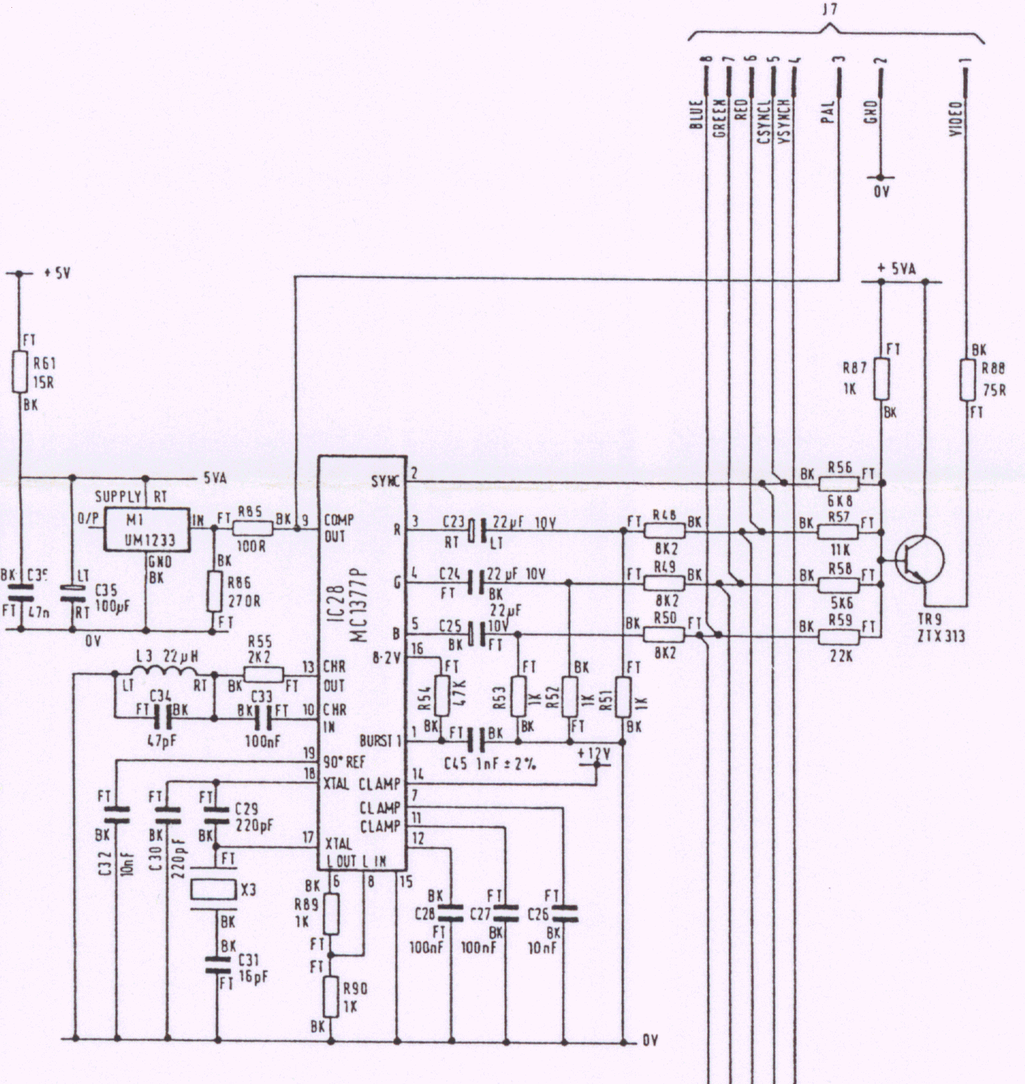

to get red/blue stripes like that in what should be solid red suggests video is taken from the output of the MC1377, and that is not operating correctly - possibly +12v supply is not working correctly?
I think it's pin 14, but my circuit diagram I printed is tiny..

The chrominance subcarrier is losing synch for some reason. There are quite a few reasons why this could happen. One of my Issue 7 boards does this. I have never found the cause, but I never looked too hard either.

If you want to validate the advice given thus far, you might want to see whether using the composite monochrome output fed to your VGA upscaler renders a solid - albeit grey-scale - image where you currently see the blue/red unstable stripes.
The upscaler should cope with this and it would simply involve temporarily disconnecting the 2 wires connected to pins 1 and 3 in your QL Monitor plug and reconnecting the wire from pin 1 (PAL colour video) to pin 3 (monochrome video).
If this produces a stable solid 'colour' (ok, grey) where the wavy red/blue were, then the components around the MC1377 could be at fault.

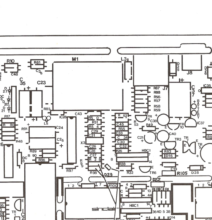

My guess? Either the 4.43MHz crystal oscillator X3, or the phase delay sub-cct involving the inductor (L3) and capacitors (C33 & C34).
Those crystal oscillators in particular can get mechanically damaged due to being raised from the cct board and are cheap and dead-easy to replace/re-solder.

Look at how the white area is perfect. Only the red area goes to green and back. This is interesting, because in the Y-UV model, the V axis is +red/green-. The red signal itself is intact, otherwise white areas would show cyan banding. So the signal path from the 8301 pin 30 to the red input on the 1377 (pin 3) is likely ok. There is no chrominance signal during white.
As Martyn stated, L3, C34 and C33 are a good place to start - that, with R55 also changes the impedance from 10 to 50 ohms. The B-Y and R-Y clamps on pins 12 and 11 (through C28 and C27, respectively) null any residual color subcarrier (I'm just quoting from the datasheet here 'cos it's fiddly!)
What would help us would be to divide the screen into a red, green and blue area. Or to have a video: type MODE 4 then do PAPER 1 then CLS then PAPER 2 then CLS then PAPER 4 then CLS. It helps to know if/which colors shift to which. This will tell us if one or both axes are toggling. This gives us a big clue if the problem is external (just one axis) or timing or internal (both axis)...
