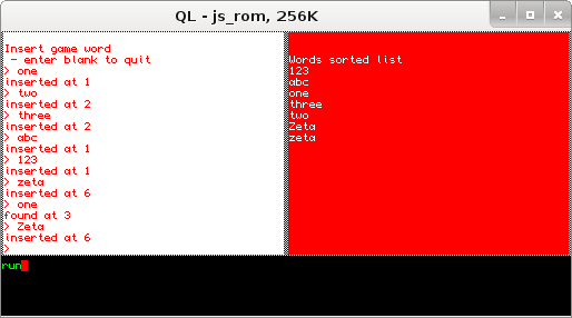

Re: Sorting And Searching
I was able to code a simple quick search and insert, it works with integer arithmetics, that may be faster only to interpreted basic once compiled. To this end `'res' and 'i' variables may need to be also declared as integers.
I do not see a simple way to pattern matching and wildcards.

100 REMark String Quick Search & Insert
110 REMark (c)tcat, 2017 Tomas Kral
120 :
130 REMark Globals
140 size%=0 : max%=100
150 DIM words$(max%,16)
160 :
170 :
180 DEFine FuNction Find% (str$,id%)
190 REMark Quick search returns:
200 REMark 0=not found, 1=found, id%=position
210 LOCal top%,bot%,mid%
220 top%=0 : bot%=size%
230 :
240 REPeat find_loop
250 mid%=(bot%+top%) DIV 2
260 :
270 IF top%>bot% THEN
280 id%=mid%+1 : RETurn 0
290 ELSE IF str$ = words$(mid%) THEN
300 id%=mid% : RETurn 1
310 ELSE IF str$ > words$(mid%) THEN
320 top%=mid%+1
330 ELSE IF str$ < words$(mid%) THEN
340 bot%=mid%-1
350 END IF : END IF : END IF : END IF
360 END REPeat find_loop
370 END DEFine Find%
380 :
390 :
400 DEFine FuNction Insert% (str$,id%)
410 REMark Inserts String at position id%
420 REMark Returns 2=ok, -1=array full
430 LOCal i
440 :
450 IF size% >= max% THEN RETurn -1
460 FOR i=size% TO id% STEP -1
470 words$(i+1)=words$(i)
480 END FOR i
490 words$(id%)=str$
500 size%=size%+1
510 :
520 RETurn 2
530 END DEFine Insert%
540 :
550 :
560 DEFine PROCedure Main
570 REMark Main user loop
580 LOCal word$(16),id%,res
590 CLS: CLS#2
600 :
610 PRINT#2,\\"Insert game word"
620 PRINT#2," - enter blank to quit"
630 PRINT ,\\"Words sorted list"
640 :
650 REPeat main_loop
660 INPUT#2,"> ";word$
670 IF word$='' THEN EXIT main_loop
680 :
690 res=Find%(word$,id%)
700 IF res=0 THEN res=Insert%(word$,id%)
710 SELect ON res
720 = 1: PRINT#2,"found at"!;id%
730 = 2: PRINT#2,"inserted at"!;id%
740 =-1: PRINT#2,"array full"
750 END SELect
760 :
770 CLS
780 PRINT,\\"Words sorted list"
790 PRINT words$(1 TO size%)
800 END REPeat main_loop
810 END DEFine Main
820 :
830 Main
840 :
850 REMark END
