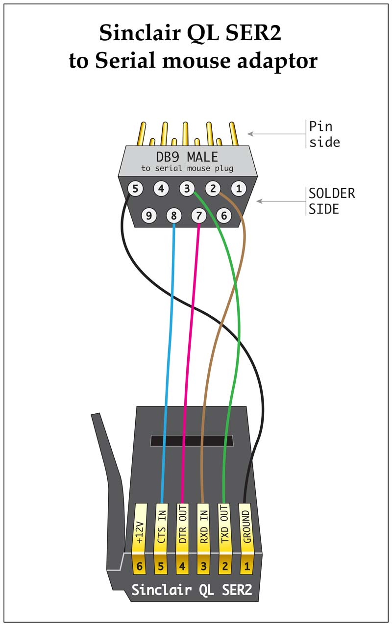

I solved.
A) The 12V must not be connected.
B) The pin 4 from SER2 (DTR out) must not be connected to the corresponding DTR pin on DB9 plug, but to the pin 7.
Now my adaptor works 8-) I made a wiring scheme: please feel free to utilize it if you need:

Cristian wrote:I solved.
Now my adaptor works 8-) I made a wiring scheme: please feel free to utilize it if you need.
Here below the link:
https://dl.dropboxusercontent.com/u/397 ... daptor.jpg
Wow!!!
Great Job Cristian!!!

even if I solved and my mouse doesn't need the 12V imput, thank you very much for your important information. Your topic and findings are very interesting and I'm going to study them.
I hope you found my Sermouse connection scheme (previously linked). It's a very little thing, but it might be useful somehow.

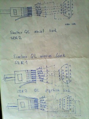

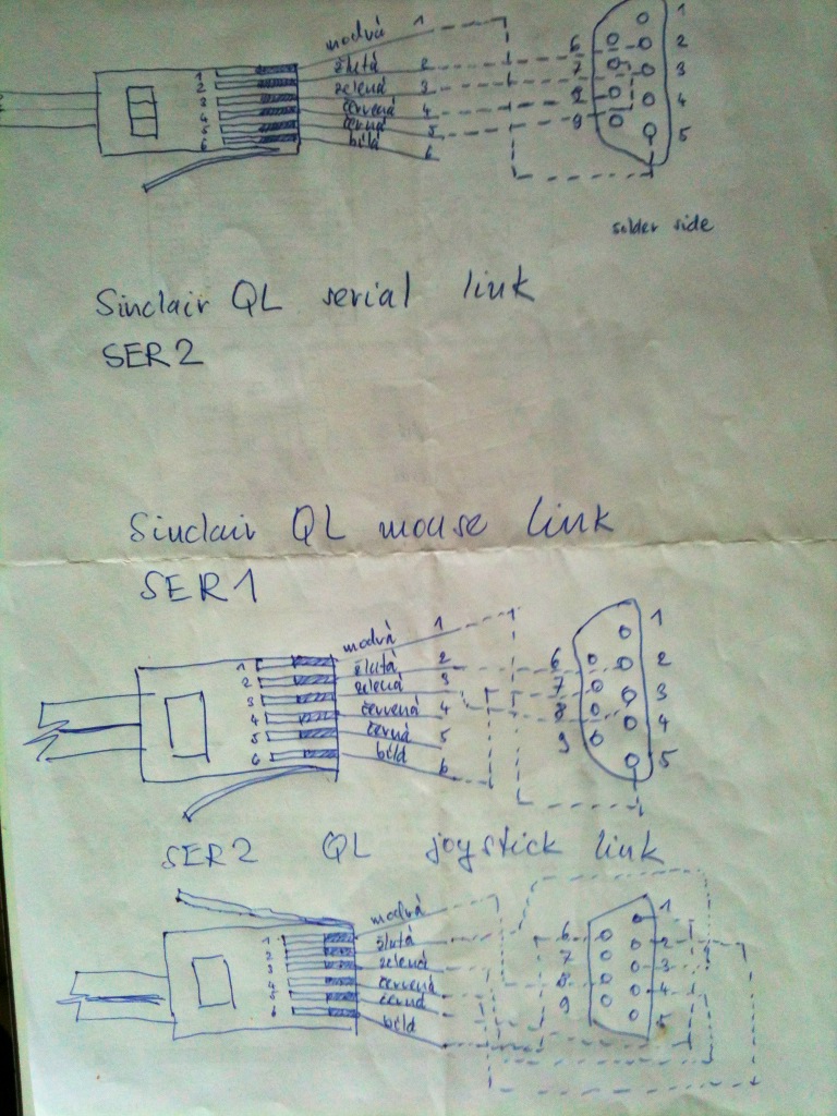

Whenever I see your drawings, I am jealous of your art skills, my drawings are more like this. What tools do you you use to make them?
wiring used on ser{1,2}
Tomas
