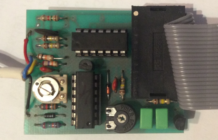

Hallo,
I’ve recently got a centronics printer interface, but unfortunately its original plug has been cut and lost. Probably it had been modified for other computers (ZX spectrum, I guess?).
In any case, I have to restore its wiring in order to match the Sinclair 6 pins SER1 port.
The interface is the white one; please see the pictures linked here below.
There are 4 cables: yellow, red, blue and black. Could someone help me to reveal the 4 signals in order to find the correct wiring for the non-standard (UK style) SER1 port please?
Thanks

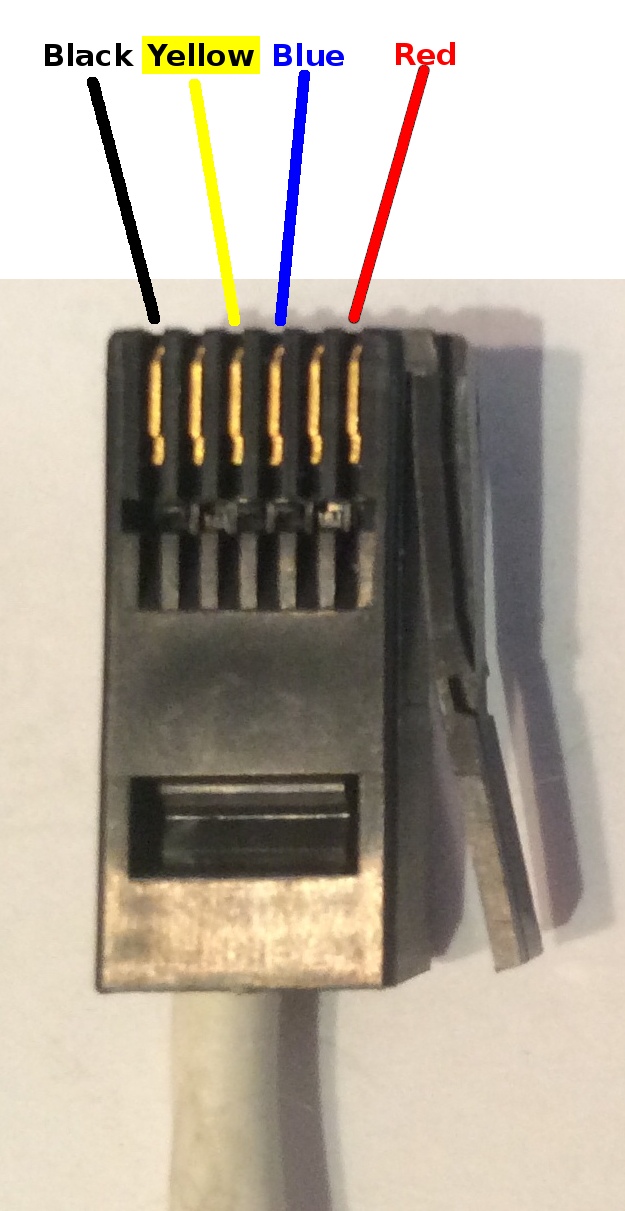

Okay, here is a picture showing how the plug is wired on mine
My interface is slightly different to yours, mine has a diode on the back instead of an extra transistor
The plugs used are no longer made. They sometimes available second hand, but not very often.
However, with some handiwork, a 6 way BT type telephone plug can be used.
You can modify either the QL socket with a sharp knife and a needle file, a standard 6 way BT type telephone plug can then be used. Or instead, you can cut grooves in a 6 way BT type telephone plug then the QL socket does not need to be modified.
If you need more pictures, shout out
Anyway, I hope this helps
Mark

Do you think this could be a sort of homemede modification (for some unknown purpose), or a possible "standard" modification by Miracle Systems?1024MAK wrote: My interface is slightly different to yours, mine has a diode on the back instead of an extra transistor

So the red wire seems connected to the 12V pin, black->grnd, yellow->RxD, blue->DTR(=RTS).
Your pictures are almost professional and crystal-clear; many thanks also for your valuable help
I'll make some proofs and let you know

I don't know, I don't think it's homemade. On mine, they have removed the markings of the two chips.Cristian wrote:Do you think this could be a sort of homemede modification (for some unknown purpose), or a possible "standard" modification by Miracle Systems?1024MAK wrote: My interface is slightly different to yours, mine has a diode on the back instead of an extra transistor
So I suspect that yours is either an earlier version before they thought of this "lets remove the markings so it's harder to copy" idea, OR by that time they had given up removing the markings!
It may be that the transistor on yours and the diode on mine are effectively doing the same job. Without working out how the circuit works, we can only guess
Mark
