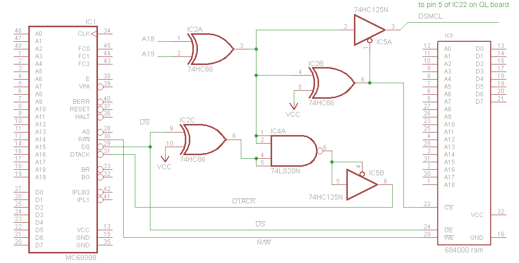

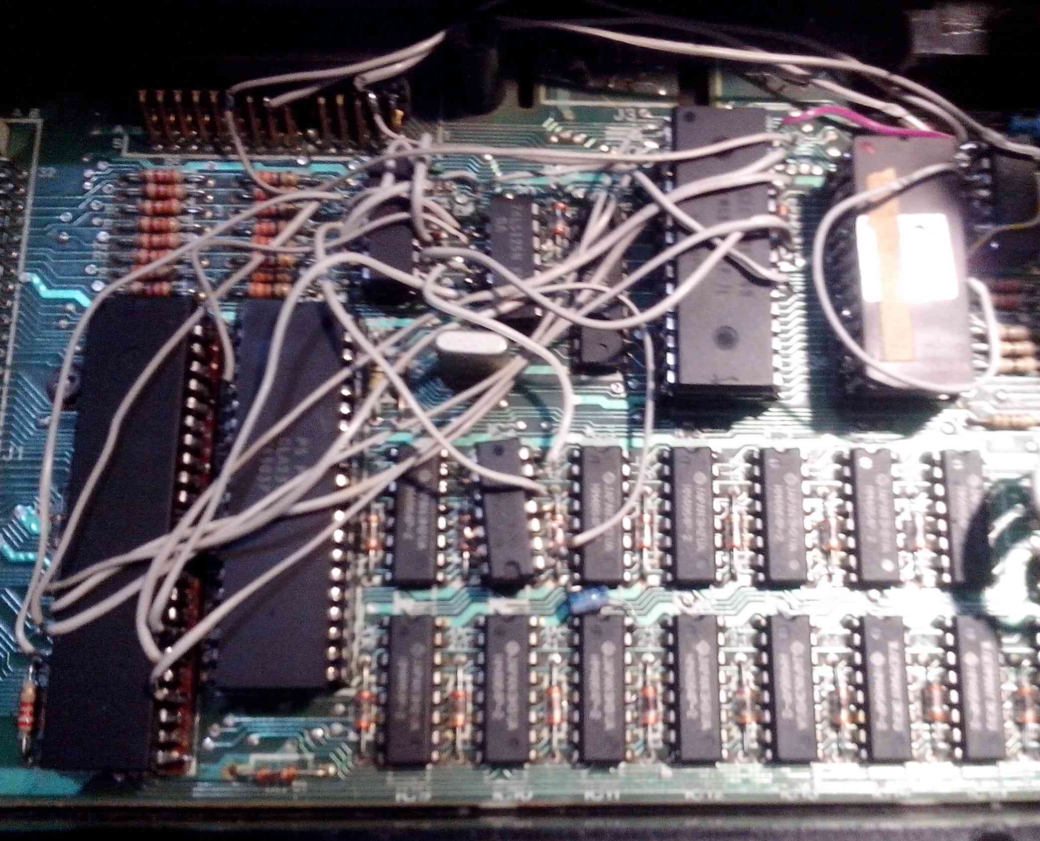

I did an internal ram upgrade to 640K to my old QL using simple logic chips. The decoder was based on 3 logic ics that I already had in my drawers and I did it without making a PCB, it looks a mess but it seems to work fine. I used a 512k x 8bit static ram 684000 ram.
Here is the decoding circuit:

It looks like this:

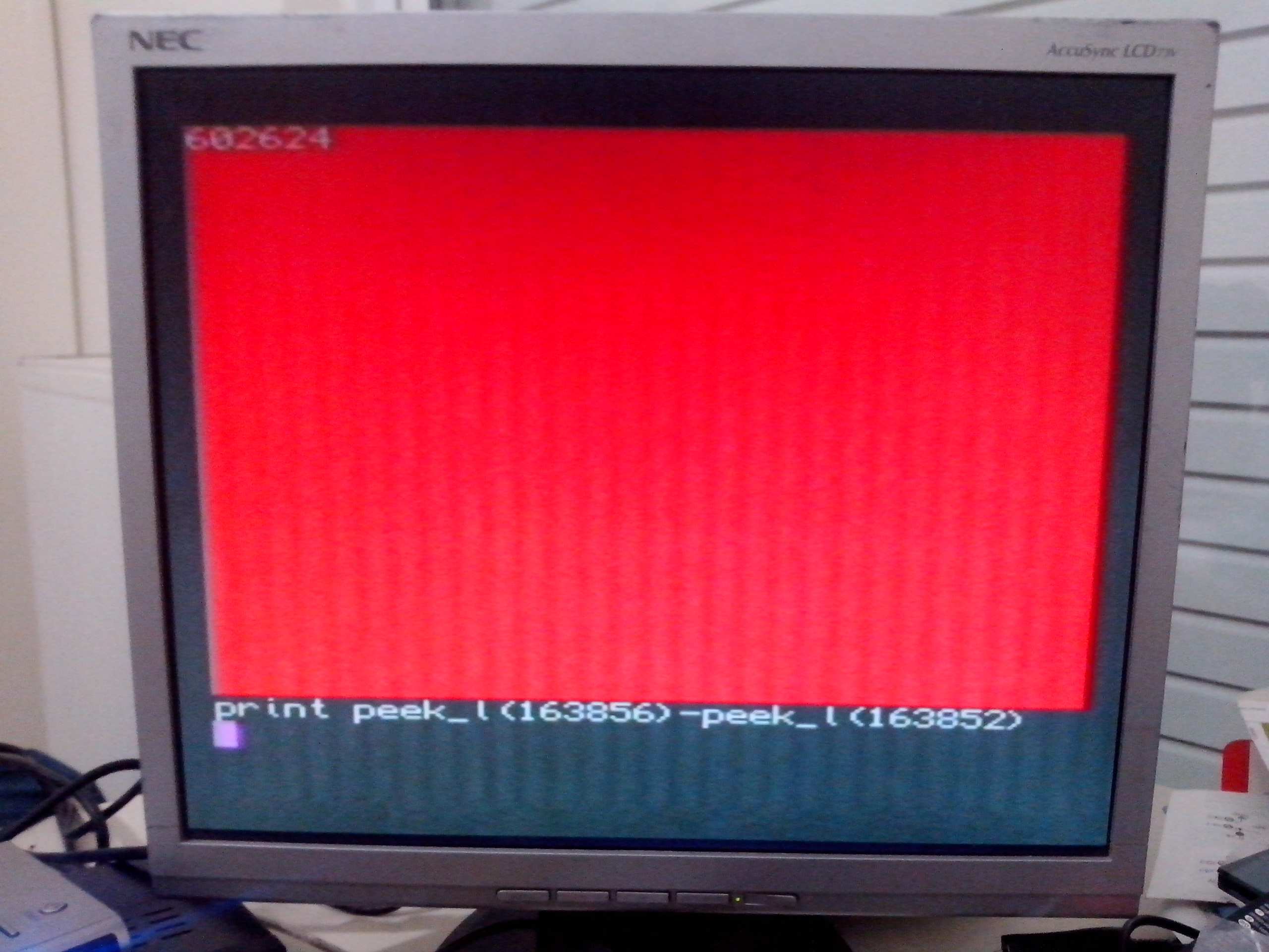

And it seems to work fine:

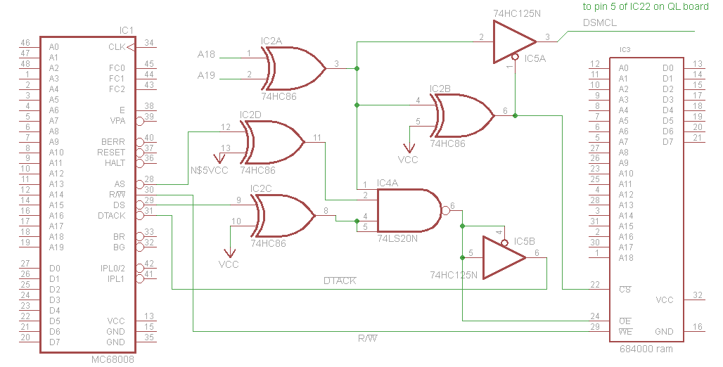

Although I haven't seen any problem with the previous decoding circuit I made a more "complete" version of the decoding circuit that takes into account both DS and AS without the need of more logic ics, the following that I'm going to try soon.

Ok this works too.
It also loads the cpu DS line less.

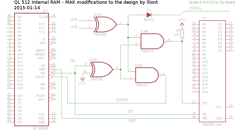

May be this... (can't think of any simplier design using standard logic chips)
