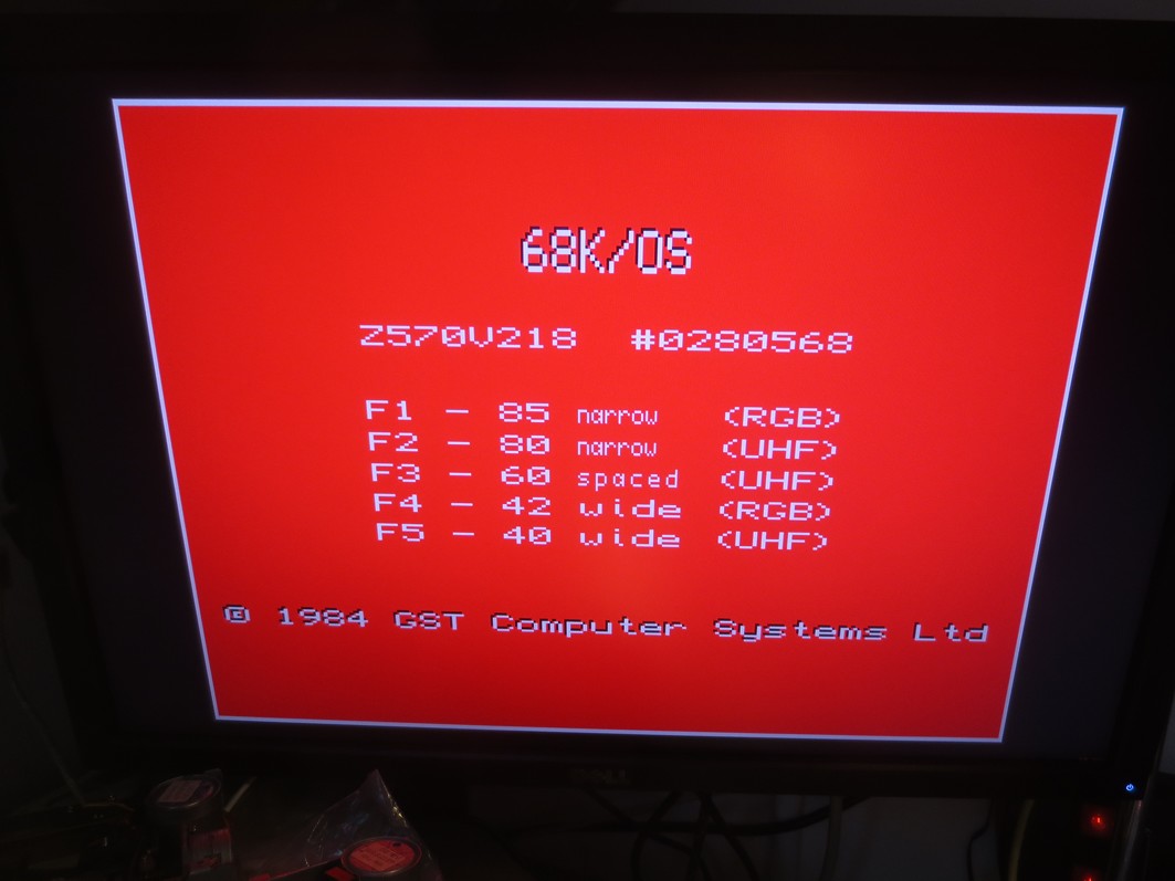

This is a 64Kb ROM image (32Kb GST 68K/OS + 32Kb ROM Disk)
The 32kb ROM disk is the same as the 16Kb ROM disk but with the EDIT program added (like on a real card)
Have only tried in Q-emuLator so far, but will try on a QL later today if my 64kb EEPROMS arrive as expected

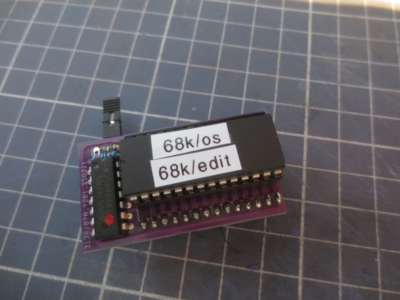

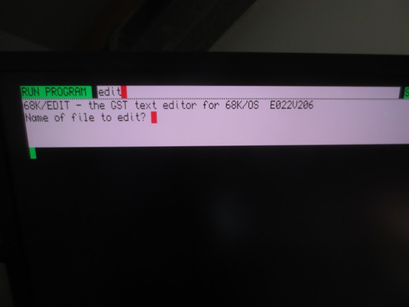

Posts: 1209
Re: 68K/OS "ROM" based disk attempt
Works fine in a real QL too
Obviously it needs to be installed in a board/device that allows 64kb ROMs (48Kb+16Kb@$C000)
I didn't think it was working properly at first as EDIT program wouldn't run, but I then realised I had $C000 disabled on the ROM board. Doh!

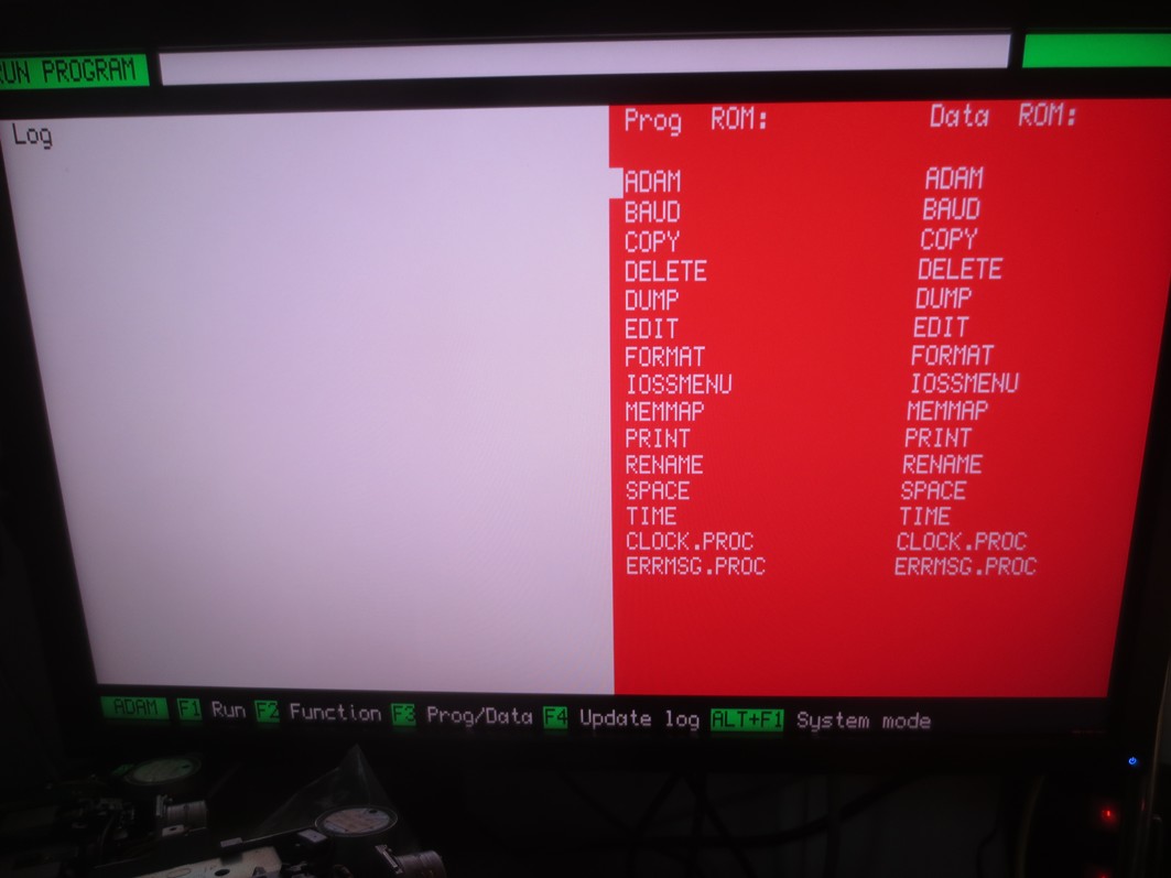

Looking at the minimum required files they are
ASM_PROG              17576 bytes
68KOS_IN                23145 bytes
SYSPROG_IN            14539 bytes
EDIT_PROG              11412 bytes
Obviously ASM_PROG & EDIT_PROG can't be reduced and they total about 29KB of the 32 KB available
But the _IN files are mainly comments & empty space
When I have time I'm going to try and strip both _IN files down to remove all the spaces & comments to see if they'll fit in 3KB, if they do I'll build a couple of RAM disk ROMS
I think the ASM_PROG can be split across the disk ROMs, otherwise the whole thing is a non-starter!
