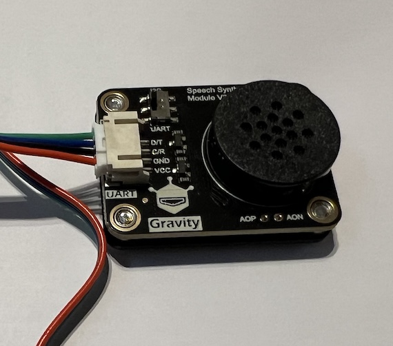

Next up Text-to-Speech (DFROBOT Speech Synthesis Module)
This has an address ID of &80 (i2c_io &40) - which clashes with HTU21D Temp/Humidity, so to use both will need a mux (thanks XorA)
So far, for some reason that I'm looking into, I can only get the same female voice regardless of the [m] option setting
EDIT: it seems the device only has 1 voice looking at the forums (despite the IC data sheet specifying it being able to support multiple voices)
Downsides of this module (other than using &80) are that the "English" voice has a distinct Chinese twang (no offence!) and the built-in speaker is a bit "tinny" (improved by lowering the volume) so will be trying the audio out to my QL monitor when I get a chance.
This is a VERY basic test program, will eventually create a full library of the available functions and settings
The basic BASIC code
100 c$=CHR$(164) & CHR$(HEX('AA')) & CHR$(255)
110 r$=I2C_IO(c$,0,HEX('40'),1)
120 c$=CHR$(1) & CHR$(188) & CHR$(255)
130 r$=I2C_IO(c$,1,HEX('40'),1)
200 PAUSE 50
500 t$="[x0][t5][v3][s6][m3][g2][h2][n1]This is a test of speech"
510 c$=CHR$(164)
520 c$=c$ & CHR$(HEX('FD')) : REMark command header
530 c$=c$ & CHR$(0) & CHR$(LEN(t$)+2) : REMark command length
540 c$=c$ & CHR$(1) & CHR$(0) : REMark synth text
550 c$=c$ & t$ : REMark text to speak
560 c$=c$ & CHR$(255)
570 r$=I2C_IO(c$,0,HEX('40'),LEN(t$)+5)
The device for those who haven't seen one before

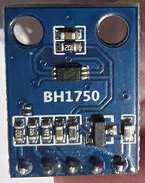

Next up BH1750 Light Sensor
This uses address &23 by default, but can be changed to &5C which I had to do as &23 is used by the TI LCD (though I've just remembered that I could of just changed the address on that. Doh. (of course the &5C clashes with the "phantom" address of the 32kb eprom so had to re-jumper that as well)
I don't have a light meter so can't validate the Lux reading, but the lux value increases/decreases depending on the light shone on it
The code
100 REMark Perform a power on and clear last measurement for testing purposes
110 c$=CHR$(164) & CHR$(HEX('01')) & CHR$(255): REMark Power on to allow clear
120 r$=I2C_IO(c$,0,HEX('23'),1)
130 PAUSE 5 : REMark need pause after power up?
140 c$=CHR$(164) & CHR$(HEX('07')) & CHR$(255): REMark Clear Last Reading
150 r$=I2C_IO(c$,0,HEX('23'),1)
160 PAUSE 5 : REMark need pause after clear?
200 REMark Send Measurement request for One Time Hi Res Mode
210 c$=CHR$(164) & CHR$(HEX('20')) & CHR$(255)
220 r$=I2C_IO(c$,0,HEX('23'),1)
230 PAUSE 10 : REMark pause for about 200ms (120ms needed)
300 REMark Request Measurement 2 bytes
310 c$=CHR$(188) & CHR$(255)
320 r$=I2C_IO(c$,3,HEX('23'),2)
330 v=CODE(r$)*256
340 v=v+CODE(r$(2 TO 2))
350 v=INT(v/1.2)
360 PRINT v;" Lux"
