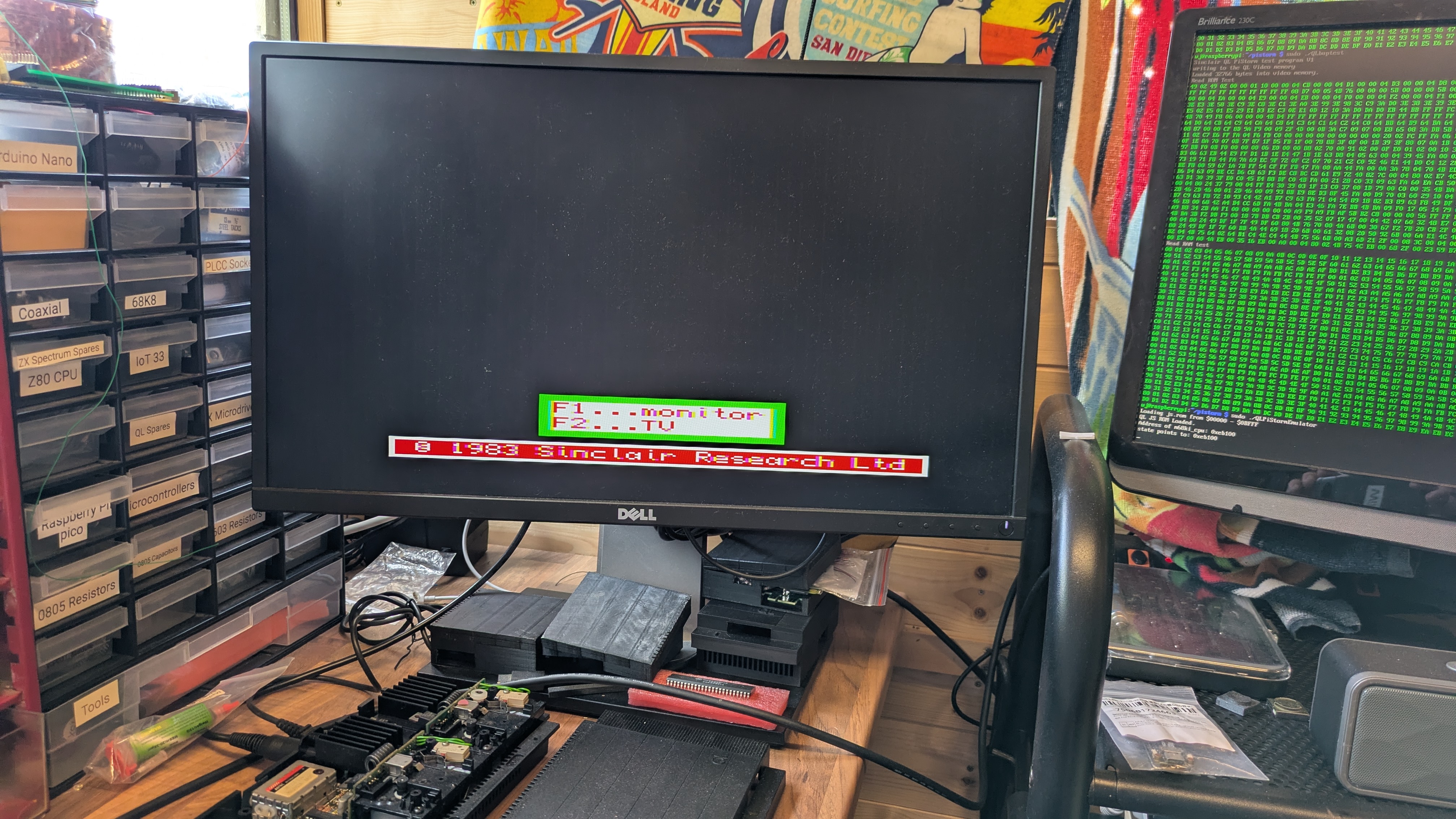

Woo-Hoo!!!! I had to do a little update. The photo is of the first time the QL PiStorm has booted up to QDOS.
After sorting the hardware a few days ago I've been scratching my head since then as to why it was locking up instead of booting
today at work I had a revelation - A18 and A19 are not decoded on a standard QL causing the RAM test to go into an eternal loop of doom.
Also, I stupidly failed to remember that the QL doesn't have just a 128k address space, it is 256k, 128k of ROM and IO with 128K of RAM on top of that.
I made a couple of simple changes, hit return and guess what popped up...
