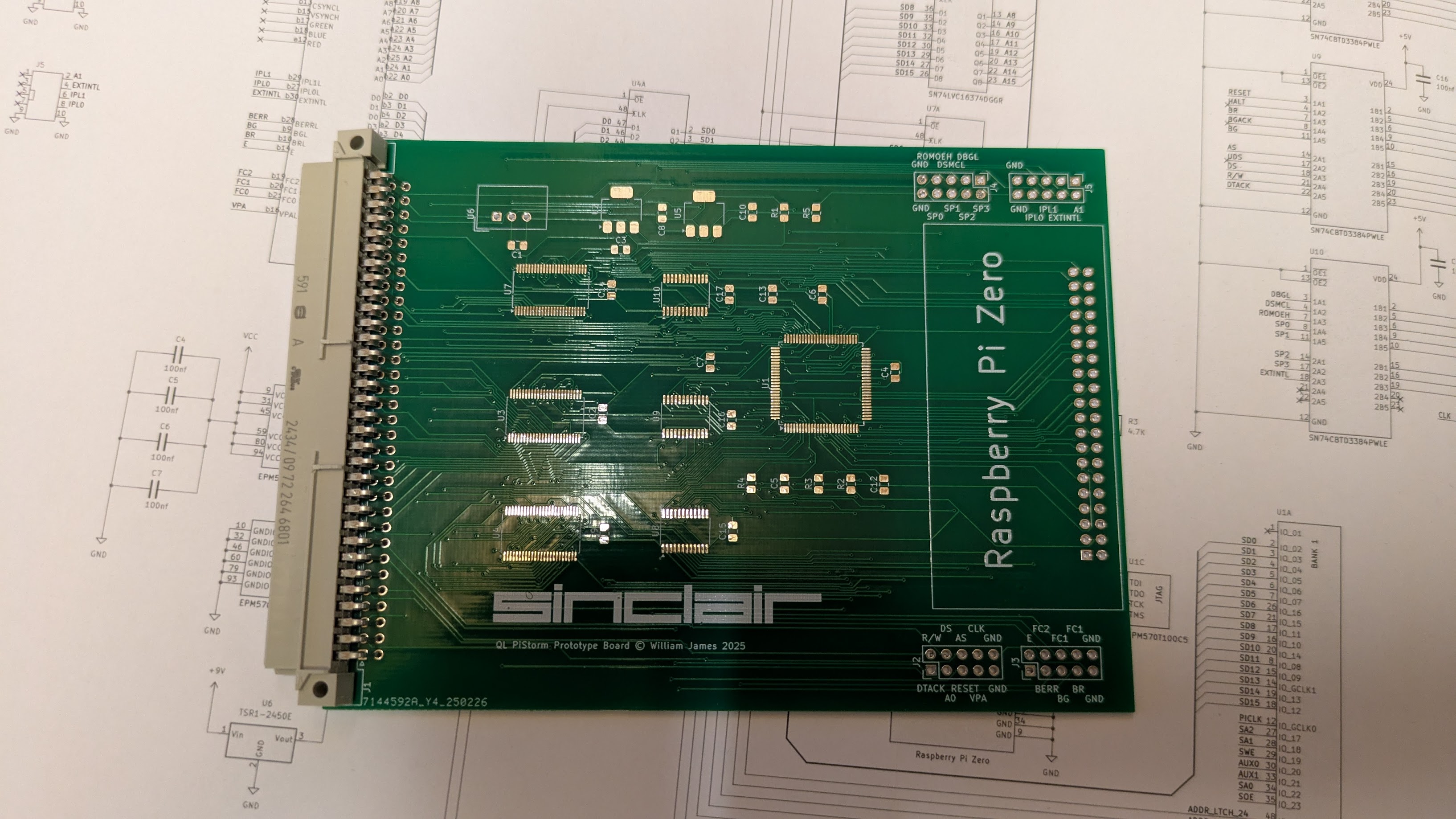

Hi all, I decided to follow Peter's advice and not bother with making a 68000 board for the QL, I went straight for a PiStorm in the expansion socket, once it's working I'll do a CPU Socket version.
I am trying to make the minimum of changes to the PiStorm source code to make it 8 bit and to the Verilog CPLD code.
Once it's running, it I will need to strip out the Amiga stuff and make virtual HDD, RTG and Network stuff for the QL.
I had to 5 boards made if anyone else would like to join in the fun, message me.
Please let me know if you can see anything wrong on the schematic that I may not have thought of,
I am not sure how I will disable the 68008, as there is no Halt on the expansion port but I guess I could just take it out altogether.
Will![Image]()
Will
