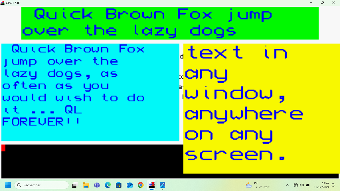

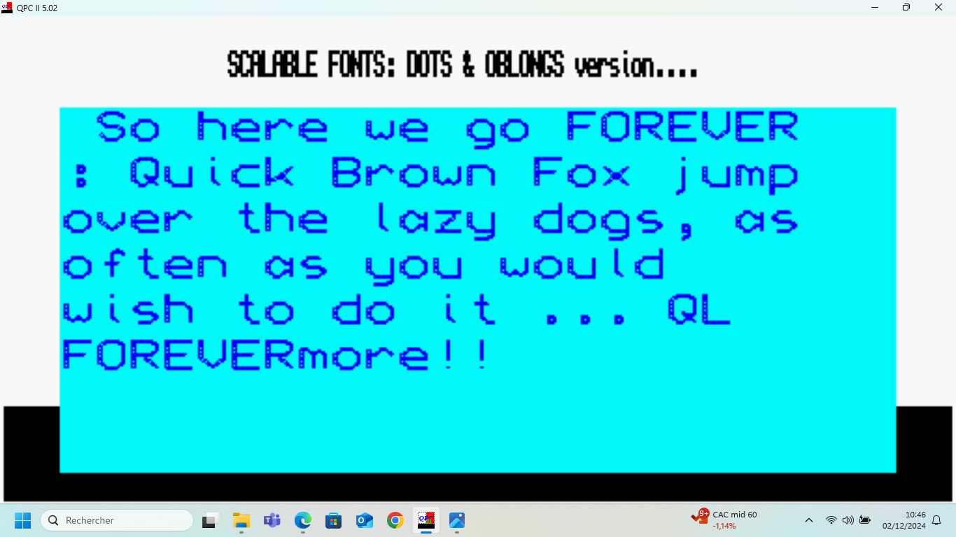

Here is the final (I hope) version of the font-enlarger program.
UNZIP, LRESPR chans_code, and LRUN the demo, Tested OK on QPC, SGC and QDOS.
Fits words onto the chosen screen, splits them if too long. Fills randomly here.
Should be OK with any font ?
Modify line 150 for your own text, or Line 160 for your own window needs.
If your enlargement won't fit the screen, you get an out of range error. Steve.

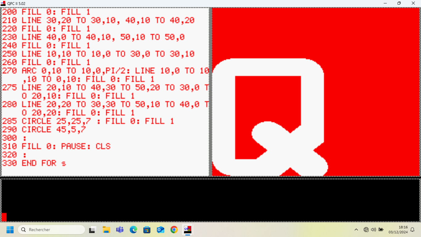

This is the sort of enlarged character I achieve using ARCS, CIRCLEs and oblongs.
It uses masses of code to produce unsatisfactory results. (eg: no aspect control).
And FILLing using ARCs is cumbersome. Every Character would need its own routine...
I shan't experiment any further down that road... Regards, Steve.

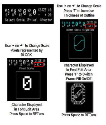

Well QBITS_FontEditSEPlus has the option to scale the Bitmap in Pixel or Vector Graphics. The later using a version derived from Steves QL Bitmap converter. You can increase the thickness of the outline and switch On/Off the Frame fill to more appreciate it construction. Speed of execution will depend on your platform.
A busy time of year hope you all have a good time with your own festivities.
QBITS

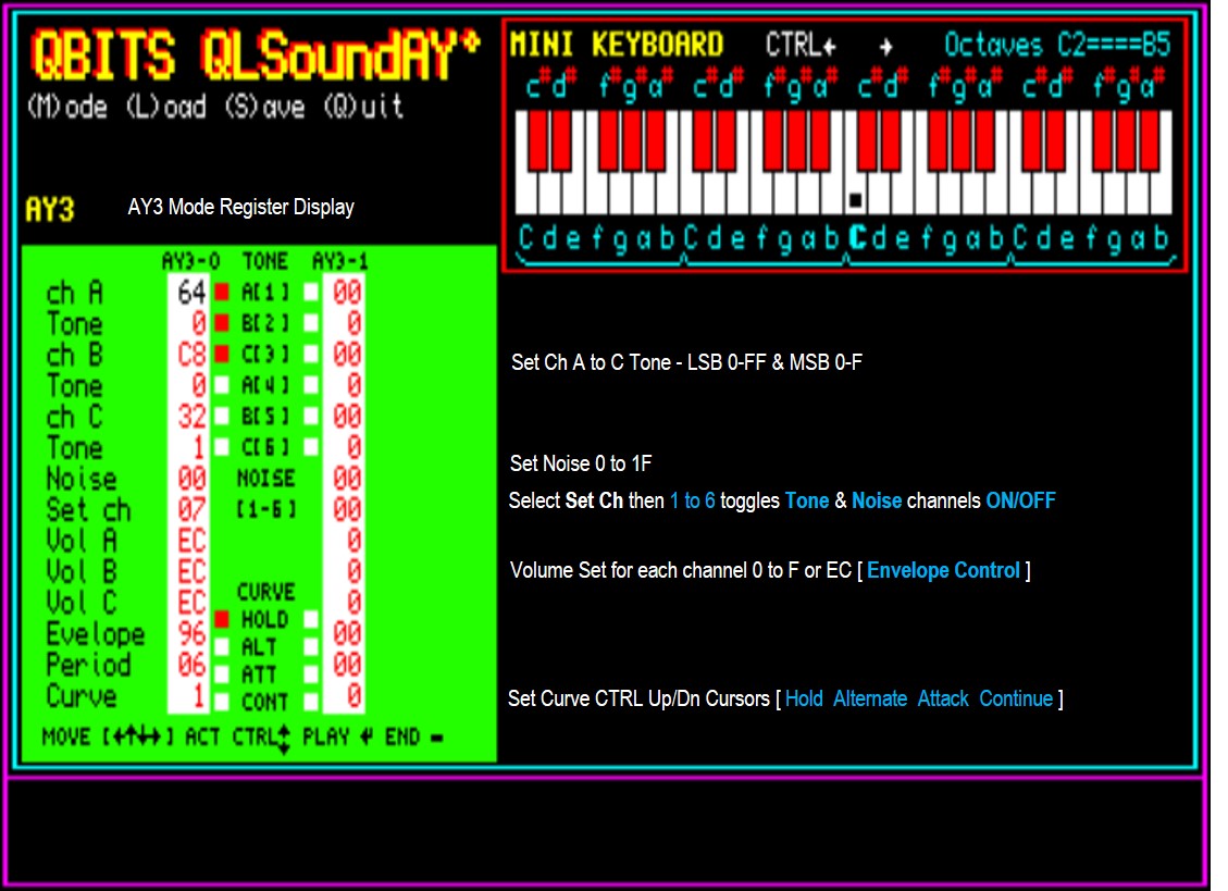

QBITS Project 2025 Utilising QPC2’s AY3 emulation.
QBITS QLSoundAY3_WIP provides an AY3 Register Settings Mode.
Step One:
Accessing and changing the AY Registers the output actioned with Enter key [End with Spacebar].
The functionality might be described as similar to changing the Attributes in BEEP Mode except the AY3 emulate has three Tone channels and volume control settings or defined wave shapes. Plus, a white Noise component.
Step Two:
Unfortunately, my limited exploring of variation in generated output has not proved very rewarding and hence a request for register setting or calculating thereof for the keyboard Notes so I can add them as defaults.
Step Three:
Plan for output sounds to be added to a scrolling list for Playback similar to the Tracker in BEEP Mode.
Progs: QBITSBoot_bas used to generate QBITSConfig which is used by QBITS_QLSoundAY3_WIP to identify accessible Drives:
Note: Run QBITSBoot_bas from default Drive - Check and set Drives accessible for your set up
Test Files for TRACK SCORE Modes: TrackDemo_qbs : ScoreNotes_qbs : SFPT1_qbs : SEPT2_qbs
