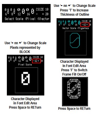

Well QBITS_FontEditSEPlus has the option to scale the Bitmap in Pixel or Vector Graphics. The later using a version derived from Steves QL Bitmap converter. You can increase the thickness of the outline and switch On/Off the Frame fill to more appreciate it construction. Speed of execution will depend on your platform.
A busy time of year hope you all have a good time with your own festivities.
QBITS
FontFiles.zip
(6.79 KiB) Downloaded 158 times
