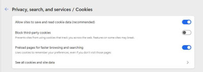

That's my browser's cookie settings.
Always had this problem with the Forum, never with other sites.

dilwyn wrote:That's my browser's cookie settings.
Do you have some bonus ad blocker, virus checker, firewall software though. As none of the moderators can repeat your problems?
Posts: 3139
Re: Help with Q Liberator
Just the usual Windows Defender (or whatever the inbuilt AV is called nowadays in Win11) and ICBM Security Rapport, the recommended thingy for my internet banking.
