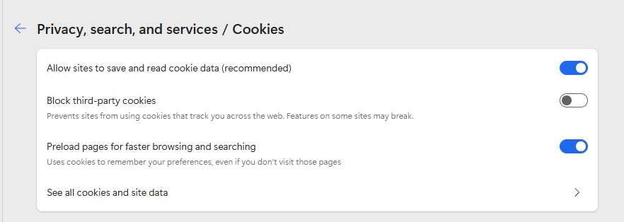

Re: Help with Q Liberator
That's my browser's cookie settings.
Always had this problem with the Forum, never with other sites.
- XorA
- Site Admin
- Posts: 1646
Do you have some bonus ad blocker, virus checker, firewall software though. As none of the moderators can repeat your problems?dilwyn wrote:That's my browser's cookie settings.
Just the usual Windows Defender (or whatever the inbuilt AV is called nowadays in Win11) and ICBM Security Rapport, the recommended thingy for my internet banking.
