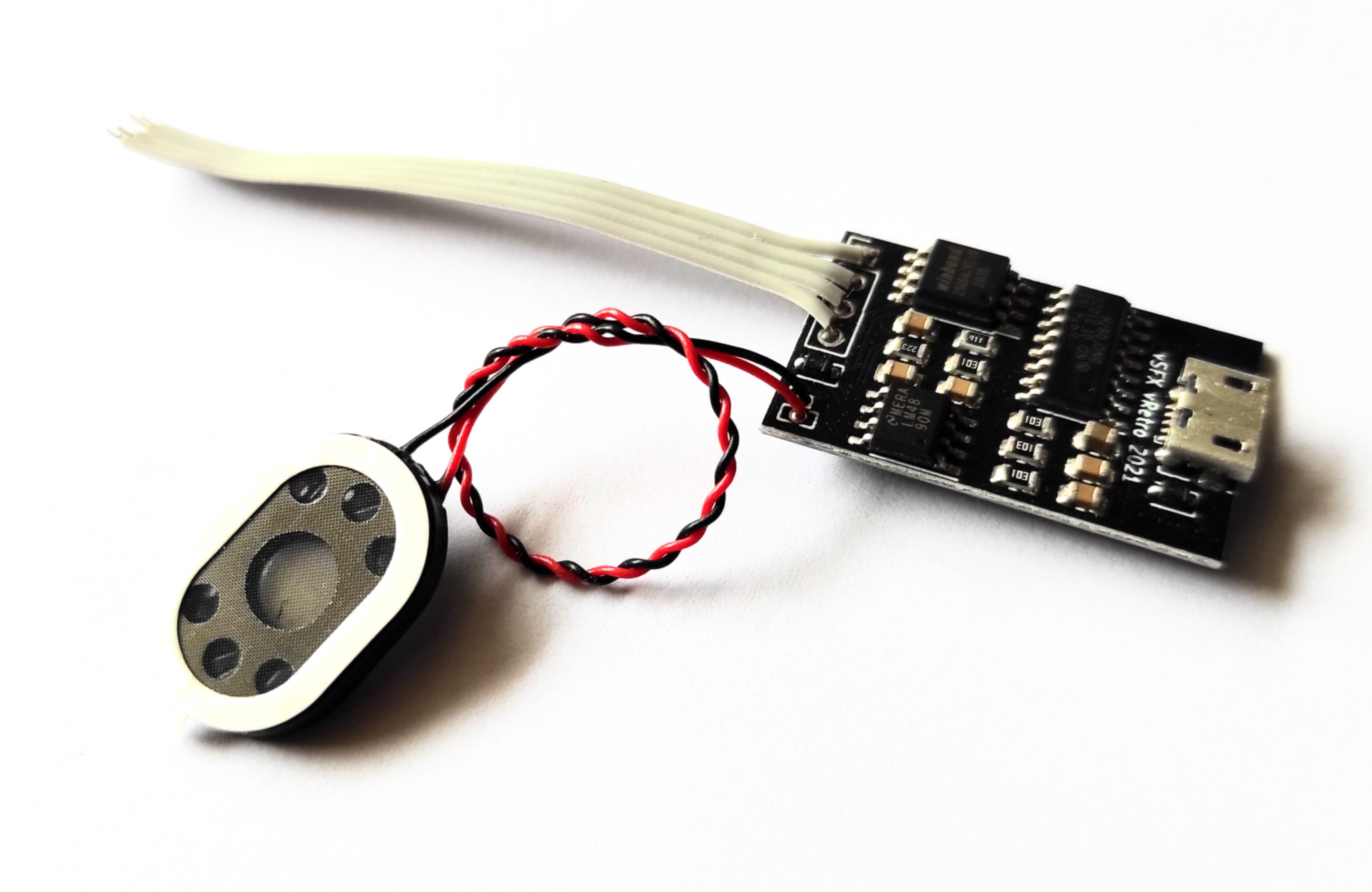

The sound module:
vSFX Hardware
vSFX Hardware

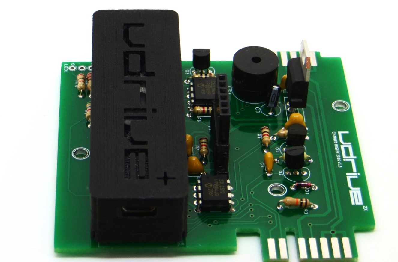

After installation in a vDrive:
vSFX Installed
vSFX Installed

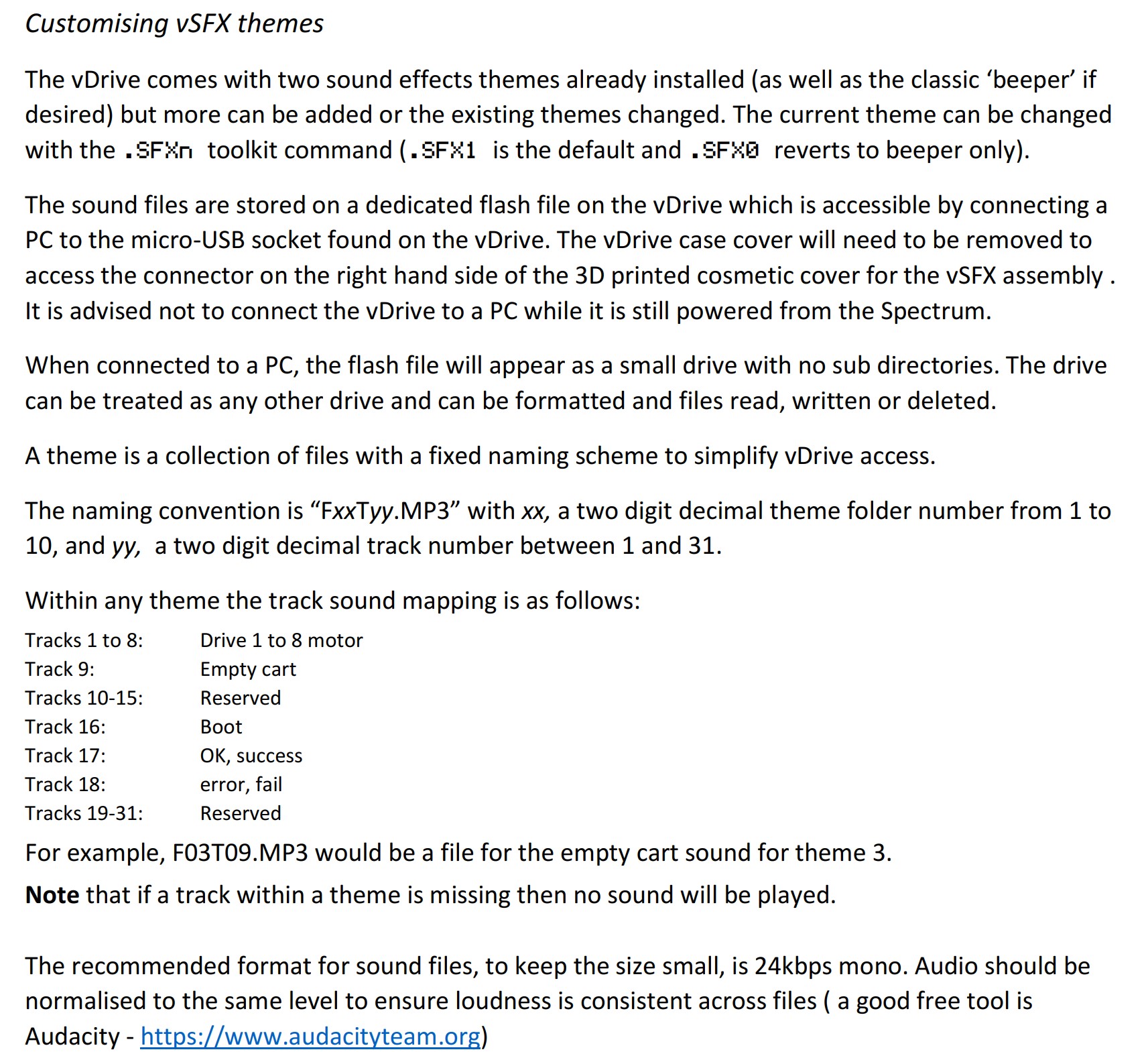

An excerpt from the vDrive ZX user manual describing how vSFX is implemented:
vSFX Info
vSFX Info

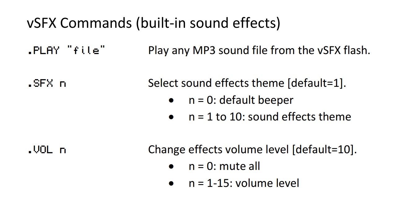

And the new commands:
vSFX Commands
vSFX Commands
The install guide is attached for those interested in checking out what is involved to upgrade (it would be the same for vDrive QL).
vSFX Install Guide v1.1.pdf
vSFX Install Guide
(1.54 MiB) Downloaded 440 times
