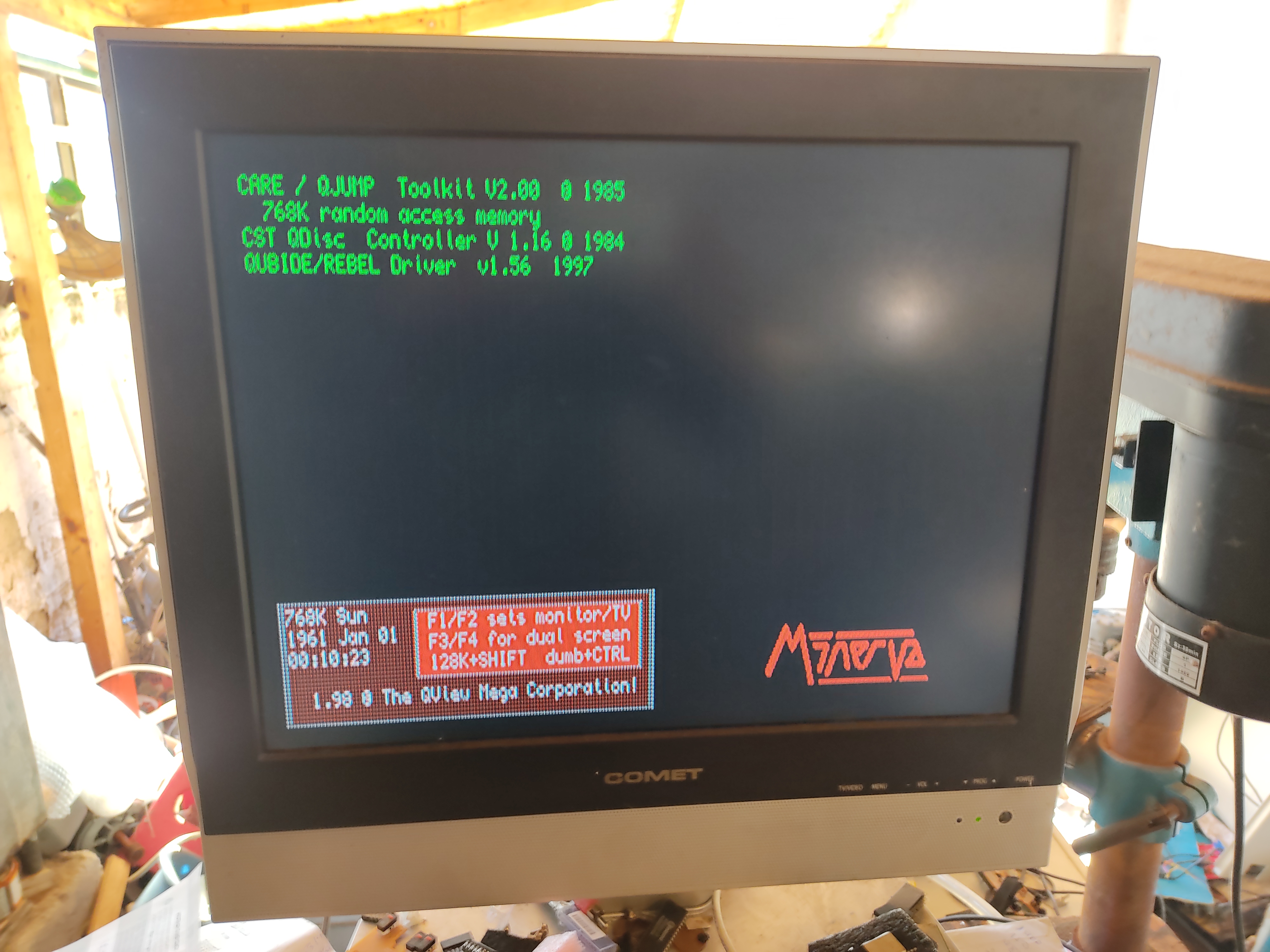

so i found something else in q-disk..... several times the ql freeze...on booting...
i solve it removing the PIN3 OF THE 74LS03 (THIS GOING TOY EXTINT) AND NO PROBLEM
Q-DISK WORKS LIKE SWEET....
nikosdoykas
Posts: 134
Re: schematics for floppy disk interfaces
Post by nikosdoykas »
SECONT THING THAT I FOUND ON QDISK
this confugaration works with 128k-640k......
but NOT WORK ΟΝ ΜΥ QUBIDE 640K(768K TOTALMEMORY....)
QDISK IS MAPPING ON END OF THE MEMORY....(I THINK IN ADDRESS C000H)
AND IN THAT MEMORY STARTS THE...128KB AFTER THE 512KB OF FIRST EXPRATION...TOTAL640K
SO I PUT THE QUBIDE IN FC000H AND REMOVE THE A17 FROM 74LS266...AT QDISK....(ACTUALLY I REMOVE THE SP3-PIN5 SP0-1-2-3 ARE GROUND)
AND IT WORK...
SO I LOWER THE MAPPING ON QUBIDE TO SEE IWERE QDISK WAS...
TO E4000H... AND WORK AGAIN....I ASSUME THAT THE QDISK ITS ON...E0000H(BECAUSE THEN QUBIDE WAS THERE I HAD GARBAGE ON STRINK ON THE SCREEN)

Hi, I made the interface based on the scheme of nikosdoykas, but I have some problems:
If I use the version 1.13 of the rom from the dilwyn, work ok, I do some test with floppy and a gotek and seem to work correctly.
But if I use the version 1.16, the work is erratic, for example the boot part do not work, usually hang, and if I try to load or save a big file, it hang.
Has somebody similar faults? (I was using a WD1772, that is the only one that I have available now).

Well, I have time to do aditional test, and found something interesting:
* The erratic operation with version 1.16 is related with interruptions, so cut the leg 3 of 74LS03 fixed it, curiosly with version 1.13 work ok.
* 74LS03 can be swapped with 74LS38, both are NAND gates with open colector output and identical pinout.
