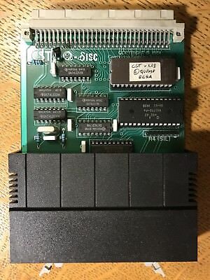

any schematics for this????
Posts: 1624
Re: schematics for floppy disk interfaces
what's the part number on the large black chip underneath the Eprom with the white label on it ?
nikosdoykas
Posts: 134
Post by nikosdoykas »
wd1770......
Posts: 1624
that makes sense - that's the disk controller chip

Posts: 1624
It doesn't look to have address jumpers like the qubide board - and as an official interface that's got the sinclair stamp, it would have to decode SP0-SP3 slot address used in combination with A17-A14 to locate the board's position in the memory map - by default this would be at 0x0C0000 - the first expansion card address with A19=1, A18=1. The Eprom chip would start at that address, and there should be an 8 bit latch with drive I/O signals, plus the WD1770 chip itself probably decoded in the last 256 bytes of that 16K block, starting from the base address. It will be similar to many of the Disk interfaces built around the WD177x series chips. I am not sure if the manuals give anything away about the I/O addresses ?
Posts: 4866
nikosdoykas wrote:any schematics for this????
Hi
Two options:
1) Remove the cover and take a high resolution photograph of both sides and post it here, I can probably try and get a schematic attempt done.
2) Send the interface to me and I will try and determine the schematic from an examination of the interface.
I have two Q-Disc Interfaces, so maybe a the photo route is best and I can compare the PCBs.
