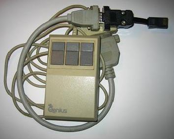

Genius Mouse (year 88?). By default the mouse starts in "PC mode", but when the left button is pressed while turn on the computer then the mouse starts in "MS mode". The QL also works only in "PC mode".
Genius Mouse
Genius Mouse
(In MS mode, Sermouse not work with QL).

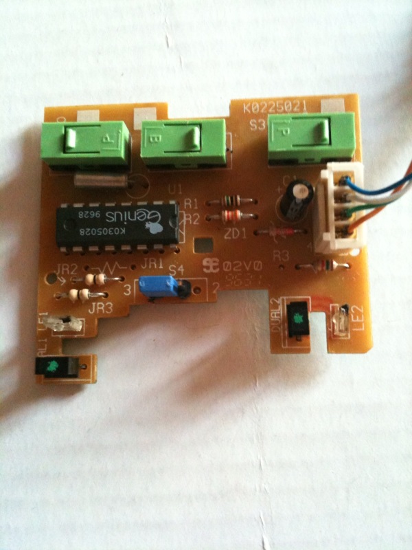

I had a second thought and took the mouse appart. On the PCB I found a vacant placeholder for a switch marked S4, with three connection pins 3 x 2. There was a permanent truck between 2 and x, that I tripped. I have soldered in a three pin switch, and bridged 3 and x.
Please see picture.
3 pin switch
3 pin switch
I remembered your earlier suggestion, and kept the left mouse button depressed at power on.
I am now getting PC mode 8bit data packets.
So it seems Genius late models with 2-3 switch, EasyMouse, MyMouse, Mouse-3, etc, are good with QL, after all. There are two flavours, with or without a mechanical switch, but the switch can be soldered in.

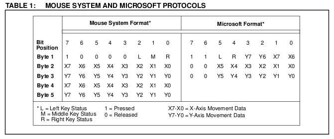

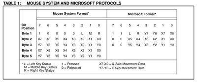

I found this definition of mouse protocols usefull, it defines plain MS (M*Soft) and PC (Mouse Systems) protocols. Neither MS extension of Logitech with a third button, nor weeler in the middle.
mouse protocols
mouse protocols
