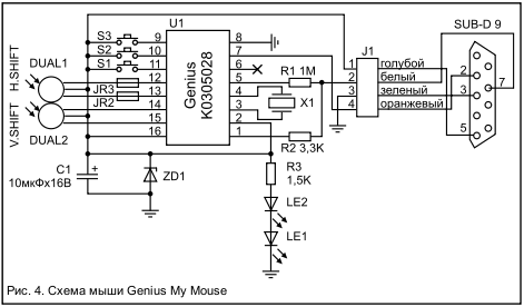

I have got the Genious My Mouse model, using pins 2-3-5-7, I beleive I need to take the second option from your list.
Sorry about the Rusian, the only picture I found on the net.
I wonder if the DIY TOOLKIT by Simon Goodwin will accept this particular three button type of mouse.

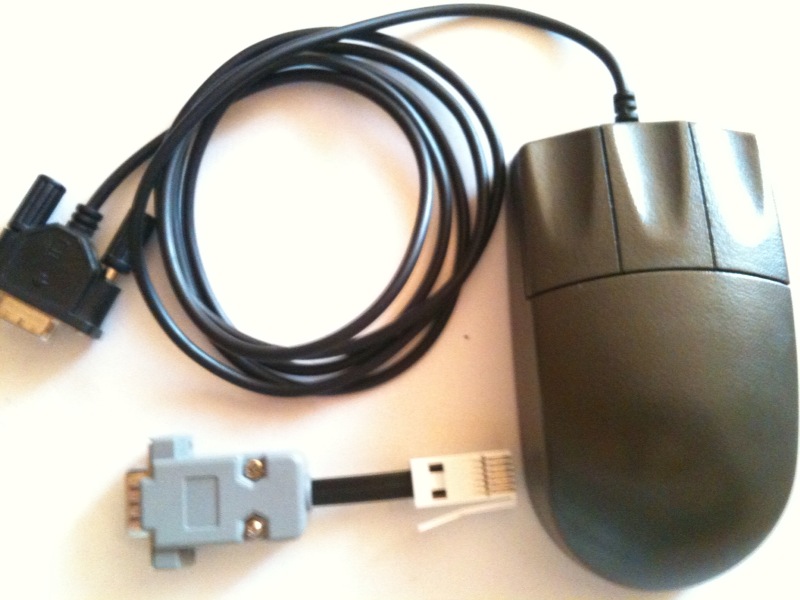

I use these connections http://sinclairql.speccy.org/articulos/ ... rs232.html
I use these retro-mouse (these are not PC mouse).
In my boot file I load the driver
LRESPR D_SerMouse
From the SuperBASIC command line
SERMON
(SERMOFF disables the mouse)
And here's the mouse in action in my QL (GoldCard + RomDisQ + SerialMouse):
http://www.youtube.com/watch?v=N0VGlRl3S-8

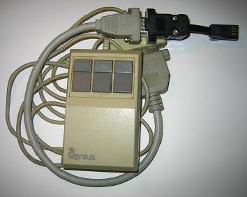

Genius MyMouse
Genius MyMouse
However so far I cannot get it working with DIY mouse TOOLKIT by S.Goodwin.
Any ideas?
TCAT
