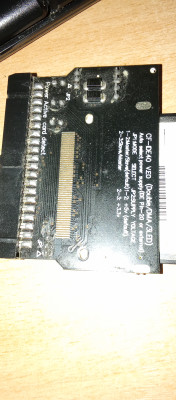

if you can , test the adaptor in a pc, just to make sure it's not faulty. jp2 on the adaptor switches 5v to 3.3v. you currently have it on 5v

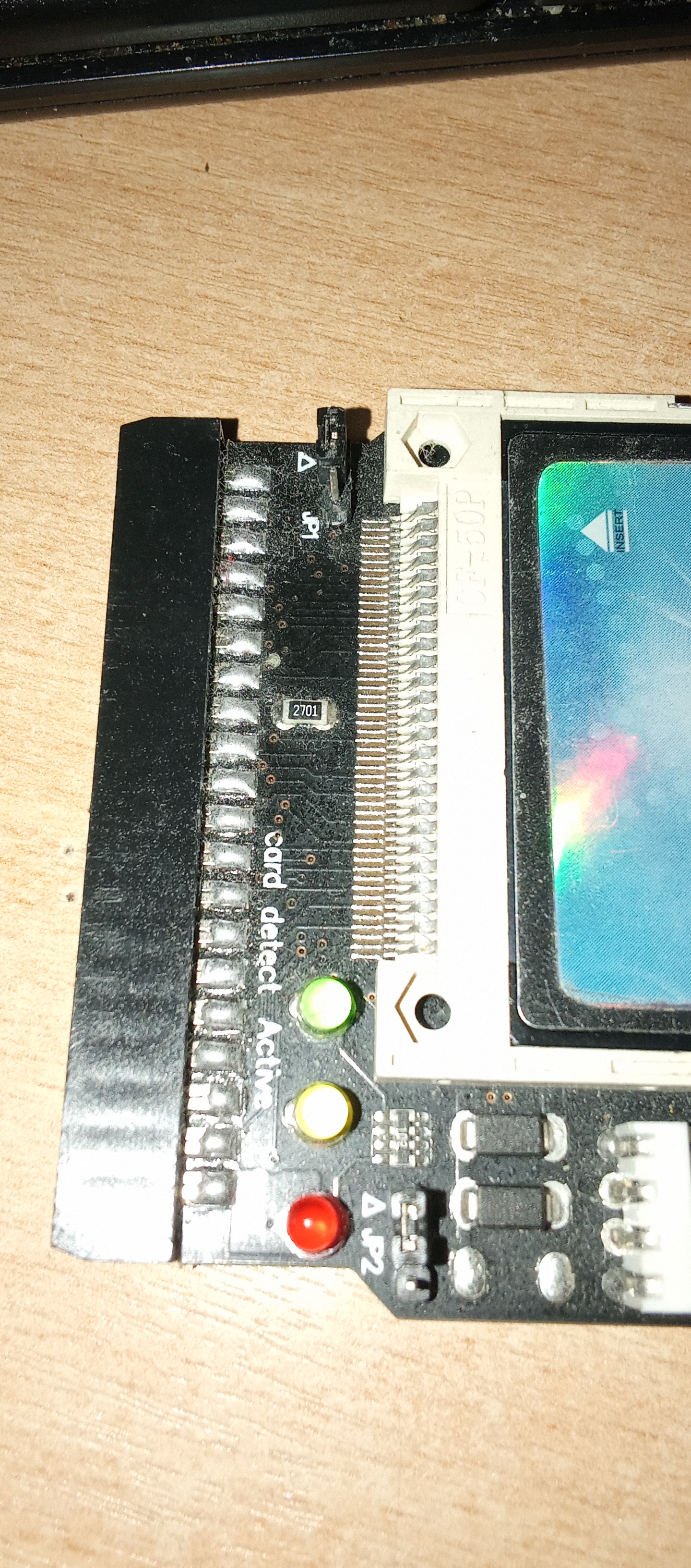

I've just seen something. On the front of your adaptor is a ceramic capacitor. on my card this looks like a resistor and is marked '2701'. I'll post some pics in a bit

Some pics

Thanks. I’ve ordered another card, this time from eBay, in the hope the images match what I’ll get (no blocked hole and a transistor)

I'm tempted to buy one with a ceramic cap to see what it does and if replacing it with a 2.7k resistor makes any difference

New CF adapter arrived today and it’s working perfectly taking its power from pin 20
(Has no blocked holes and has the resistor)
