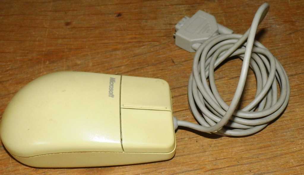

Would anyone know, are these old Microsoft mice, reported known good for QL?
Many thanks so far.
Tom
Microsoft two button mouse
Posts: 4762
Re: DIY SERIAL MOUSE
Hi Tom,
Microsoft Mice are a Bus protocol and need a special interface, which seems t be different from Serial Mice.
Maybe more info' on the Internet.
Posts: 4762
Here is a link to the Micrsoft Bus Mouse details:
http://www.oldmouse.com/miscellanea/mousebus.shtml
But your mouse, has a 9 Pin D connector on, so maybe it is a serial mouse, which should work in a stanadard serial port.
Posts: 3131
Derek_Stewart wrote:Hi Tom,
Microsoft Mice are a Bus protocol and need a special interface, .
Derek,
Microsoft bus mice, yes. But amongst the hordes of mice Microsoft has produced over the years are also quite a number of serial mice where Microsoft has (of course) invented their own protocol. See links above for details.
