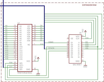

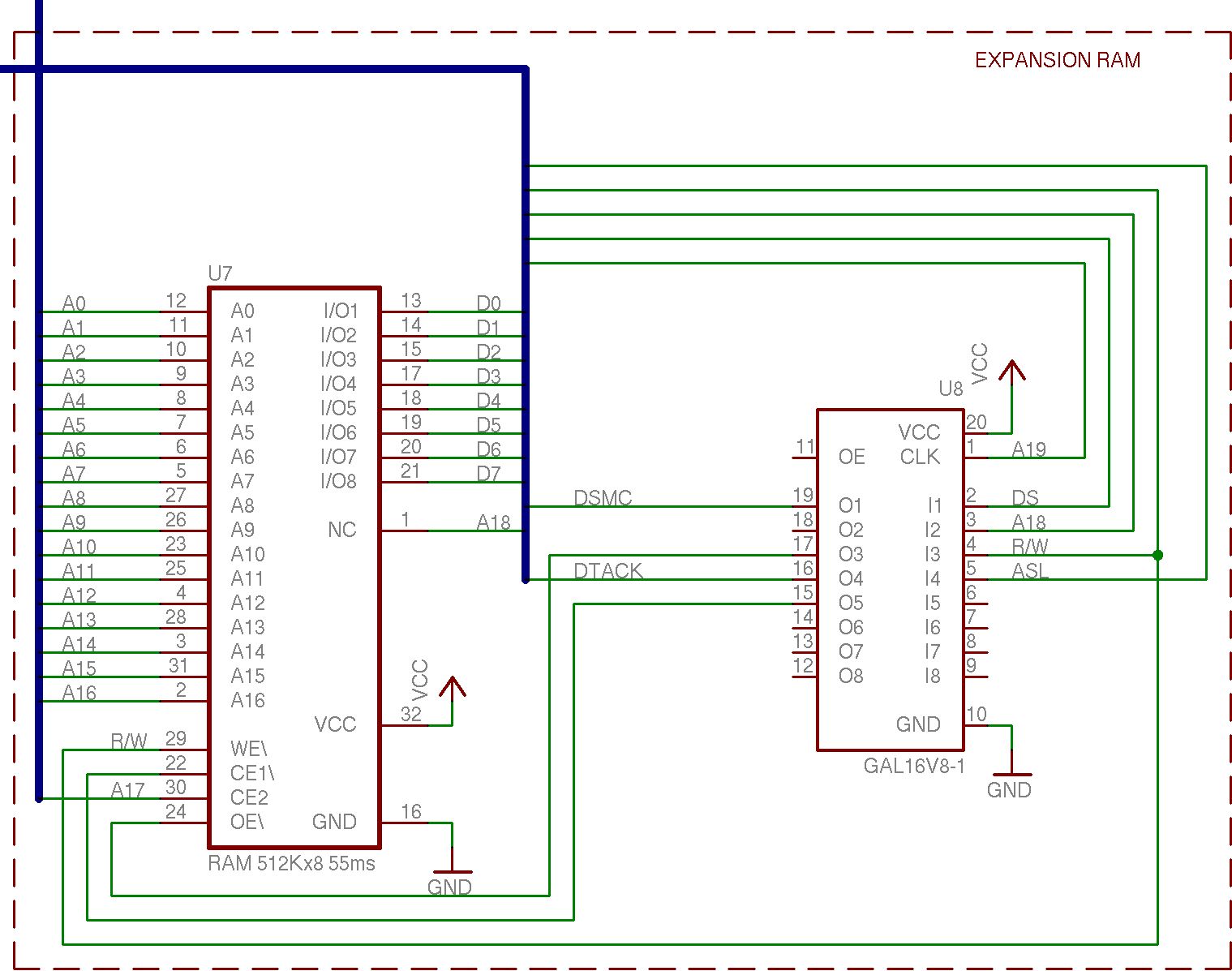

So, what is going on here?
The 640K internal expansion is SO simple and "well documented"
This is part of the QubIDE schematics. Just connect a 512KByte SRAM chip to the bus and the 16V8 GAL code is here:
Ampliacion.zip
(754 Bytes) Downloaded 218 times
It works, I did that in my QL and it is working perfectly.
Anything else? :)
Greetz from Brazil

Also the schematic for the Miracle Expanderam 512K does not use the FC2,FC1,FC0 signals.
Schematic available from http://www.dilwyn.me.uk/docs/hardware/QLperip.zip file name "expram_sch.pdf".
Mark
