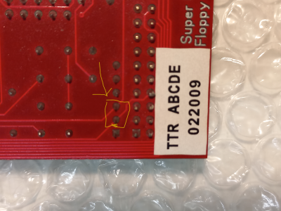

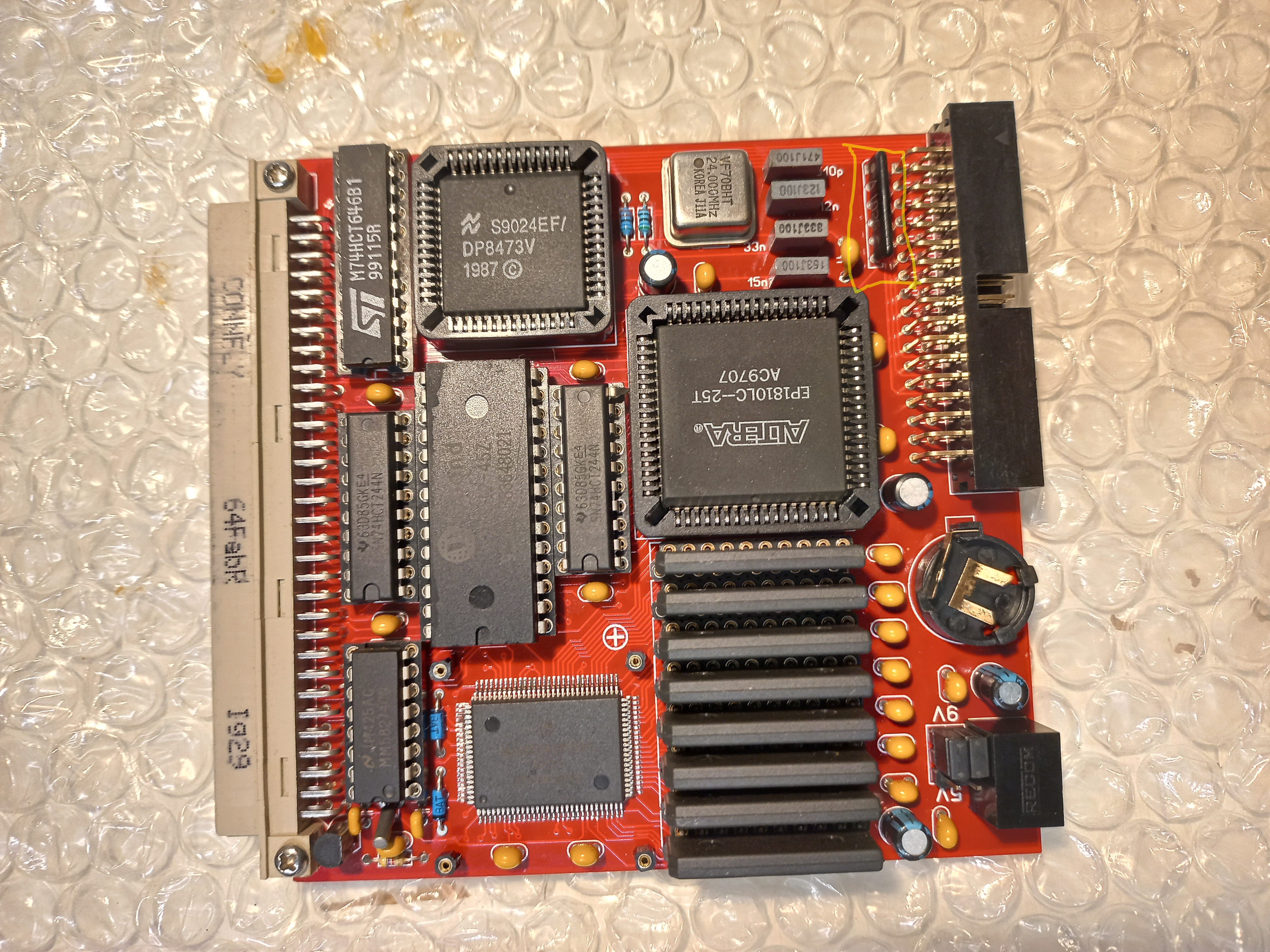

Hi Dave,
These are the pictures, probably I am wrong, you must know that my soldering capability and undestanding is very very low.
Give me your opinion.
Thank for your help.
Marco
Problem with floppy drives
Re: Problem with floppy drives
It looks fine to me. It's not a dry joint, as far as I can tell from the potatograph.

If you want I can look at the SGC, I have some spare parts and verify the disk operationTesla wrote: Fri Sep 19, 2025 5:17 pm Hi Derek.
I get the cable by you, time agoand the 3 wires are twisted. Initially everything worked well, SGC + Qimsi + floppies, but, then there was a lot of increasingly serious malfunctions.
When I replaced the SGC with an old GC everything came back ok, except one of the floppies that does not work. I think your cable is ok.
I will try to put back the original floppy that I had replaced thinking it was broken and then we see. The new one was purchased on ebay and I am not sure it is fully functional.
I'll let you know.
Thanks for the help.
Marco
I
Hi Derek,
Thank very much for your kindness.
Send me your address by PM, I will send you the card.
Best regards
Marco
