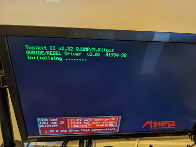

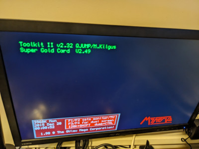

I am adding a couple of pictures showing the boot up screens with the SGC and the modified QUBIDE
There was an error in the QUBIDE - on the little piggy back board carrying the other GAL - A4 and A5 were shorted, so the QUBIDE produced the boot banner and then just filled the screen with garbage - the picture attached shows the interface now corrected.
