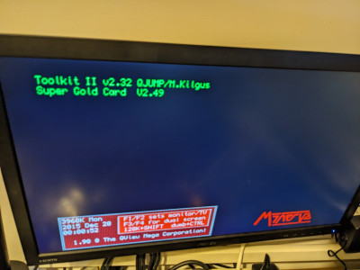

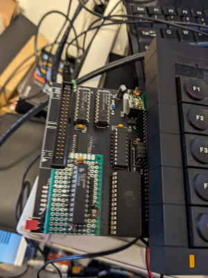

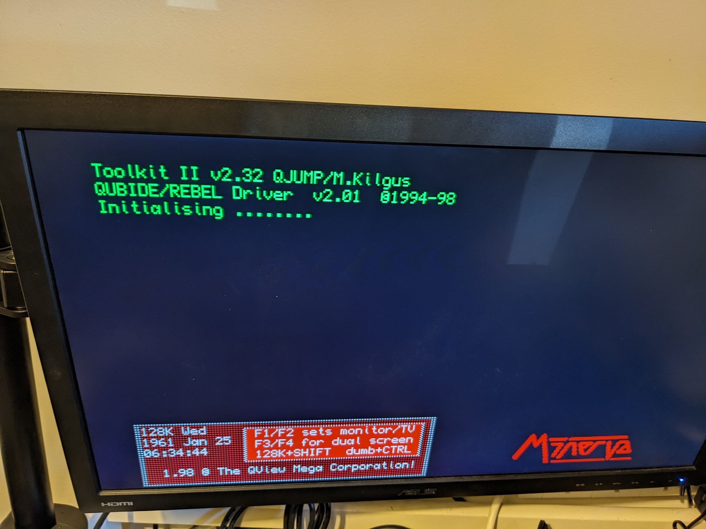

I am adding a couple of pictures showing the boot up screens with the SGC and the modified QUBIDE
There was an error in the QUBIDE - on the little piggy back board carrying the other GAL - A4 and A5 were shorted, so the QUBIDE produced the boot banner and then just filled the screen with garbage - the picture attached shows the interface now corrected.
I still need to tackle the ROM not recognized, which must be an issue on the Aurora board. Today has been mostly testing the address lines to the MACH chip and ROM socket on Aurora - which are all ok with the exception that A15 is via a 470R resistor - and I am wondering if this is not driving the Flash chip properly. It's one area where I might consider reducing this to 300R
Also plan on removing cleaning and reseating all 3 of the PLCC Logic chips, and re-sweating the solder joints as there was a lot of varnish like material just on these pins on the underside of the board. I will test the board before mounting it back in the pandora housing - as it's a pig to get to once it's in there!
Oh - that red jumper on the Qubide board selects between Rebel 2.01 firmware and the QUBATA firmware
