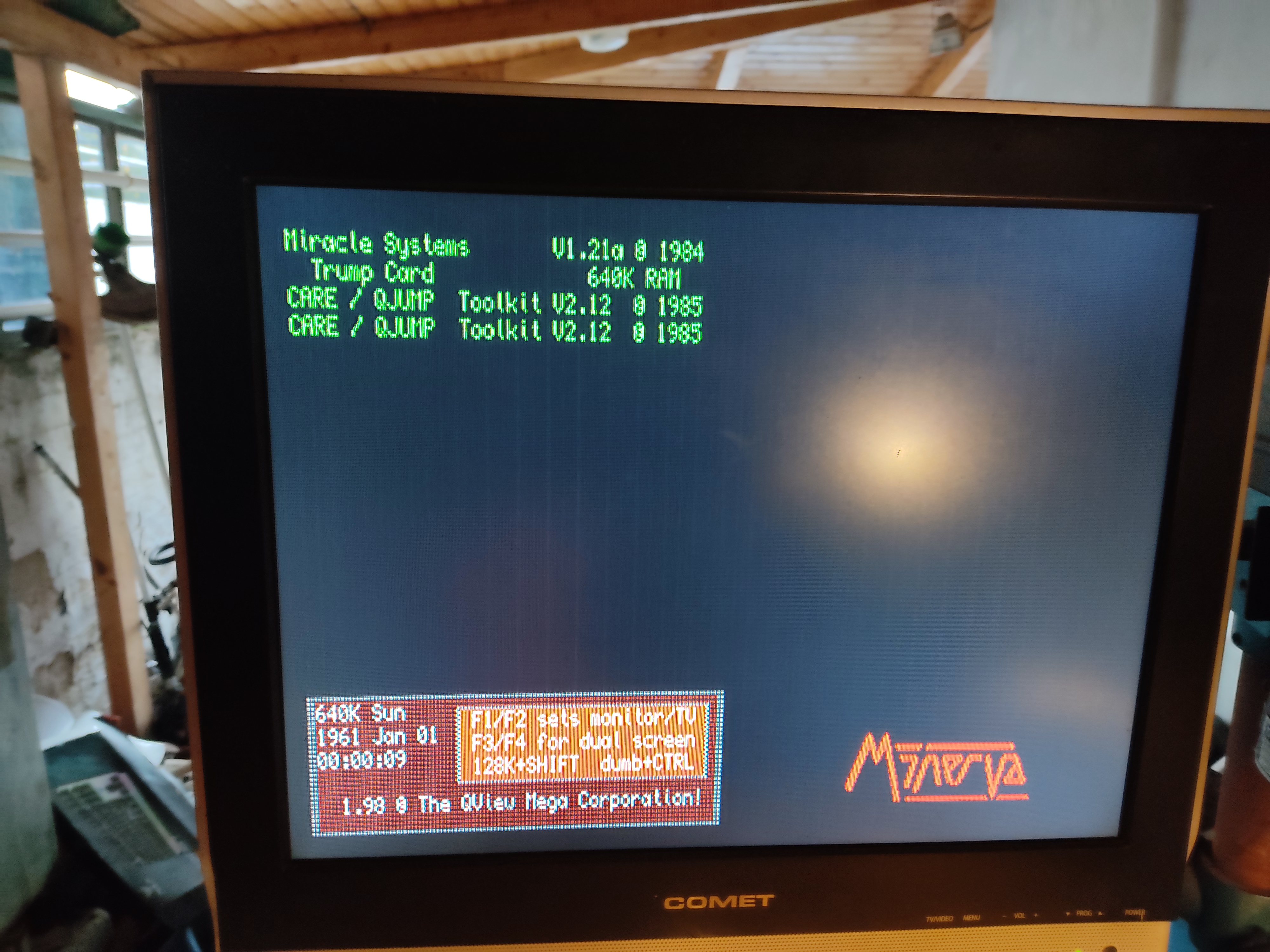

nikosdoykas
Posts: 134
Re: trump card disk card 0(zero) kb
Post by nikosdoykas »
so after many expiriment i have this....
question i have 27w512 with 2 times write the 121a rom....
why it show 2 times the tk??
then the ql stuck....
i measure dcmcl and is 3.56 volts
but in booting the dcmcl change 3-4 times on the out put of the gal to low and then stand high
any ideas??
