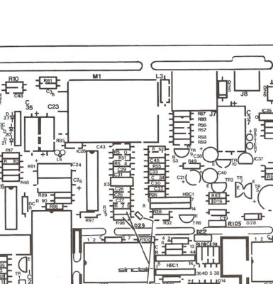

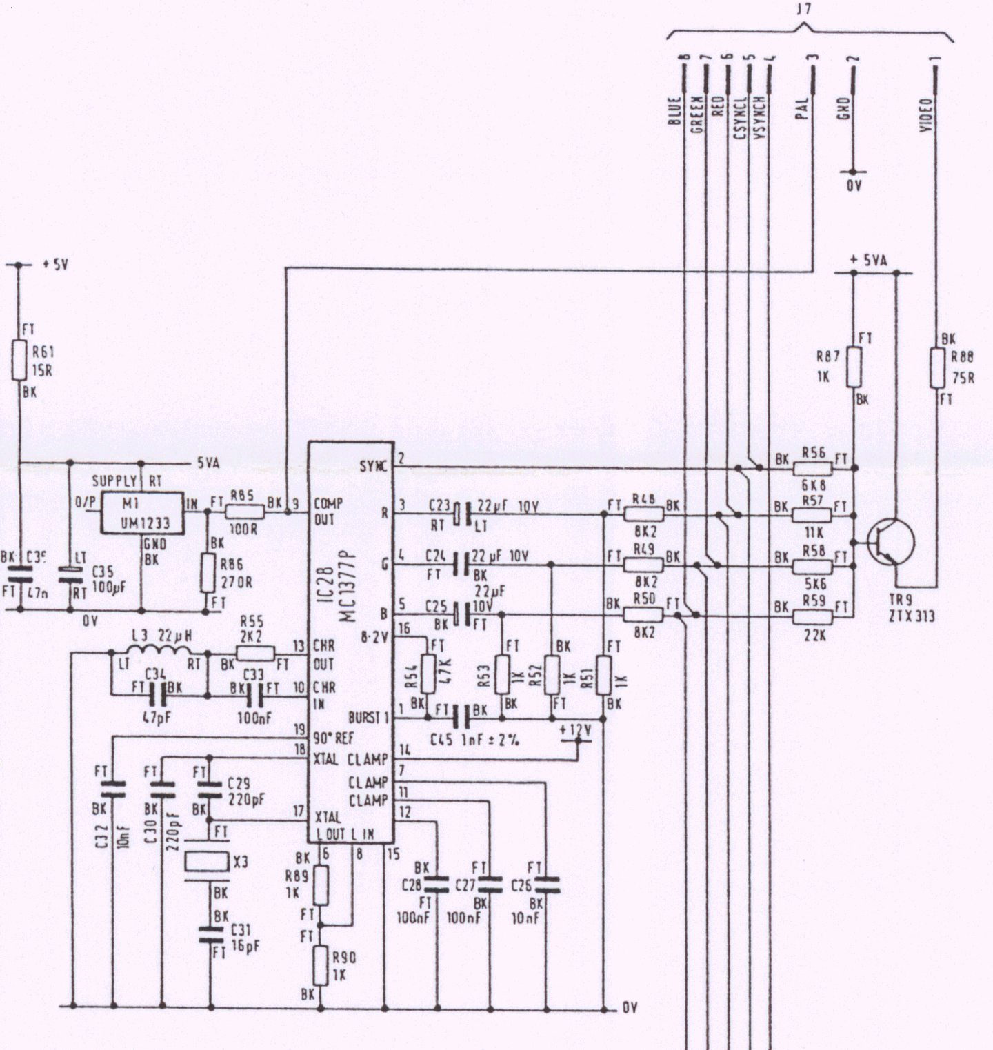

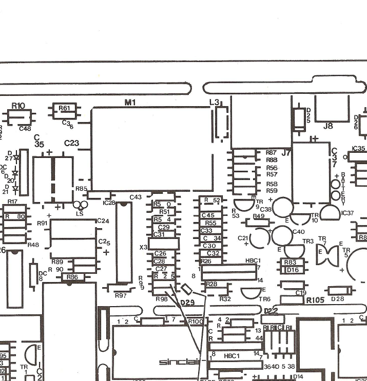

That was informative. The chroma is broken, and not just in the V plane.
L3 looks like a resistor but is a 22uH choke, located between the modulator and the RGB socket, at the very back edge of the board. L5, just below the reset switch, should be the same type/value of component. L5 is used for microdrive power, so you could remove it temporarily if you just want to swap/test parts.
Schematic:
Schematic (Iss. 5)
Schematic (Iss. 5)
Component position:
Component position (Iss.5)
L3 is due north of right edge of R55, at top of PCB.
