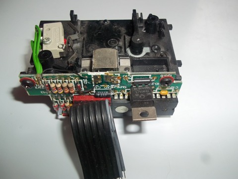

First the more common (at least in Europe) microdrive unit with the two keys on the edge:

Now the less common microdrive unit with straight edges - note the extra red wire on the PCB - I have seen the one in a plastic sleeve on some of the units with 2 keys...

Finally the very rare unit with just one keying piece - I actually have two of these, so will have to try them in a QL some time... (the keying piece is bigger than the one with 2 keys)
