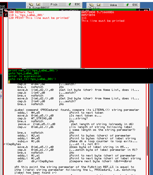

Currently only "tested" on QPC2. Before I can publish it, I must write real tests. As the filename of the picture says, the screenshot is the first successful run of the "L_" PROCedure and the REF_L% FuNction, i.e. there may still be errors in the code.

Unfortunately there seems to be an error. It seems REF_L% (which searches a label) only searches up to the first label, and does not continue to search for following labels if the first label does not match, i.e.:
100 REM A label (L_) MUST NOT be the first line!
200 L_'LABEL_1'
300 GOTO REF_L%('LABEL_1'):REMark This should work
400 L_'LABEL_2'
GOTO REF_L%('LABEL_2'):REMark This does not work the line number returned is always 0 (REF_L% returns 0 if a matching label cannot be found).
It seems my code only searches for the first L_ PROCedure and compares the label string and if no match it starts again from beginning of program (instead of continuing the search from the next line after the label). So a second label (with a different string) will never be found, cause the string of the first label does not match.
I hope this will be easy to fix.
EDIT: The string parameter of the label (L_) PROCedure MUST BE a literal string ("string" or 'string')! Variables (e.g. label='myLabel':.. and later L_ label) will NOT work. As L_ is no S(uper)BASIC keyword but just a MC procedure, the S(uper)BASIC editor (parser) will NOT find this error(!). There won't be an error at the L_ procedure, not even at runtime, but such a label cannot be found by the REF_L%() function(!).
