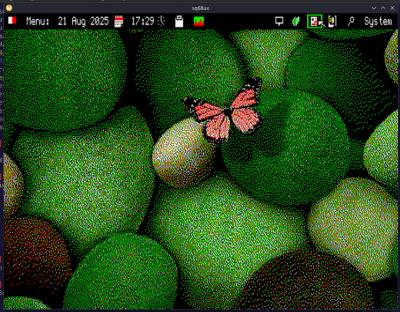

Posts: 1744
Re: sq68ux gains sound and writing to disk
So stumbled on the problem after some debugging with hardware breakpoints (an absolute lifesaver).
Verified the fix with the MAME code the SD emulation originally came from and a similar change was made there.
So I think the corruption issue is fixed.
Also this has fixed BlackPhoenix 1.5 booting on s68ux, so it can actually run real software now!
