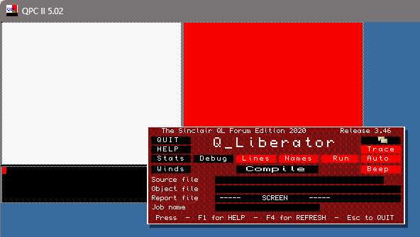

Per Witte has supplied a minor update to the Q-Liberator BASIC compiler distribution.
This latest release of v3.46 contains no functional code change to the compiler itself from the previous release. The main difference is Martin Head's comments in the toolkit sources. a few changes to the documentation in the zip files. No changes to the main manuals on the website.
