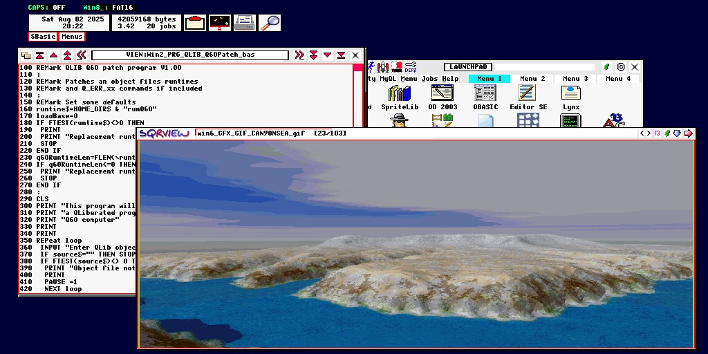

I have thrown together a BASIC program that takes a Qliberated object program. And if the runtimes are included, it overwrites the runtimes with my Q604F runtimes (renamed for this program as runQ60). By luck, the new runtimes are slightly smaller than the old runtimes, so it will fit over the old ones.
The program will also scan the object file looking for the Q_ERR commands. And if found will rename them as Q_XXX. So the QERR601B_bin will need to be LRESPRed before starting the object file.
I did a quick test with Qtrans2 and SQRview, and they still seemed to work OK in QPC2.
Note this program will probably not work with Qlib object files made with versions 1 and 2 of QLiberator.
Q60Patch.zip
(10.4 KiB) Downloaded 2 times

Artificer
Posts: 170
Re: Q_Liberator malaise
Post by Artificer »
Q60Patch :
Qtrans_obj, SQRview102_obj and Launchpad_obj after patching and looking good. Early days.
Cheers
