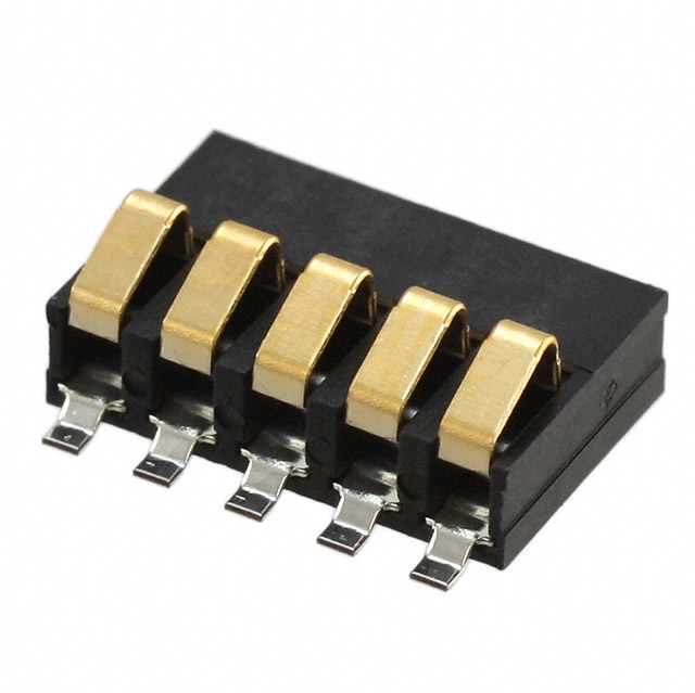

For ease of use and longevity, would sprung pins be better than a pin header, with the SD carrier having contact plates onto which the pins press?

Pogo pins are too fragile. I tried regular pins. They do wear loose. I have decided to try spring leaf tabs on the underside, like the spring leaf contacts used for cell phone contacts to battery pads.stephen_usher wrote: Mon Jul 07, 2025 10:25 am For ease of use and longevity, would sprung pins be better than a pin header, with the SD carrier having contact plates onto which the pins press?
These specifically:
