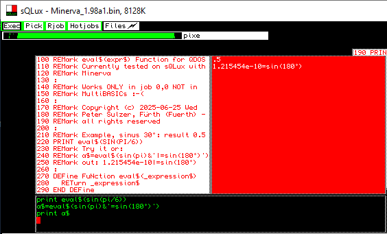

eval Function (eval$) for SuperBASIC (Job 0,0 only?) (does <EDIT>or does not(?)</EDIT> work in Minervas MultiBASICs)
SORRY! This is bullshit, this i no eval (VAL/VAL$) function (as. e.g. on Spectrum or eval() in Python)! See the following answers in this thread.
Oops, suddenly it also works here (sQLux 1.1.1.) also in a Minerva MultiBASIC job:-)

Re: eval Function (eval$) for SuperBASIC (Job 0,0 only?) (does <EDIT>or does not(?)</EDIT> work in Minervas MultiBASICs)
It works in your first example since you give it a numeric argument (SIN(PI/6)), which is evaluated and coerced into a string before the function is called.
But when you give it a string argument, it simply returns the string itself.
I guess you want it to evaluate the string as a numerical expression, much like the VAL function on the Spectrum.
There is no easy way to do that. Perhaps one way would be to create a file with a BASIC command like 'result=<expression>' (where <expression> is substituted from the argument given to eval$) and running it with a DO command?
(sorry, currently have no time to test this

You're of course right, don't know what I have thought when writing this. It's not an eval function because you cannot pass it a string, which a user has input. It can only evaluate an expression which is coded in the program. Sorry.janbredenbeek wrote: Wed Jun 25, 2025 12:05 pm It works in your first example since you give it a numeric argument (SIN(PI/6))...,
