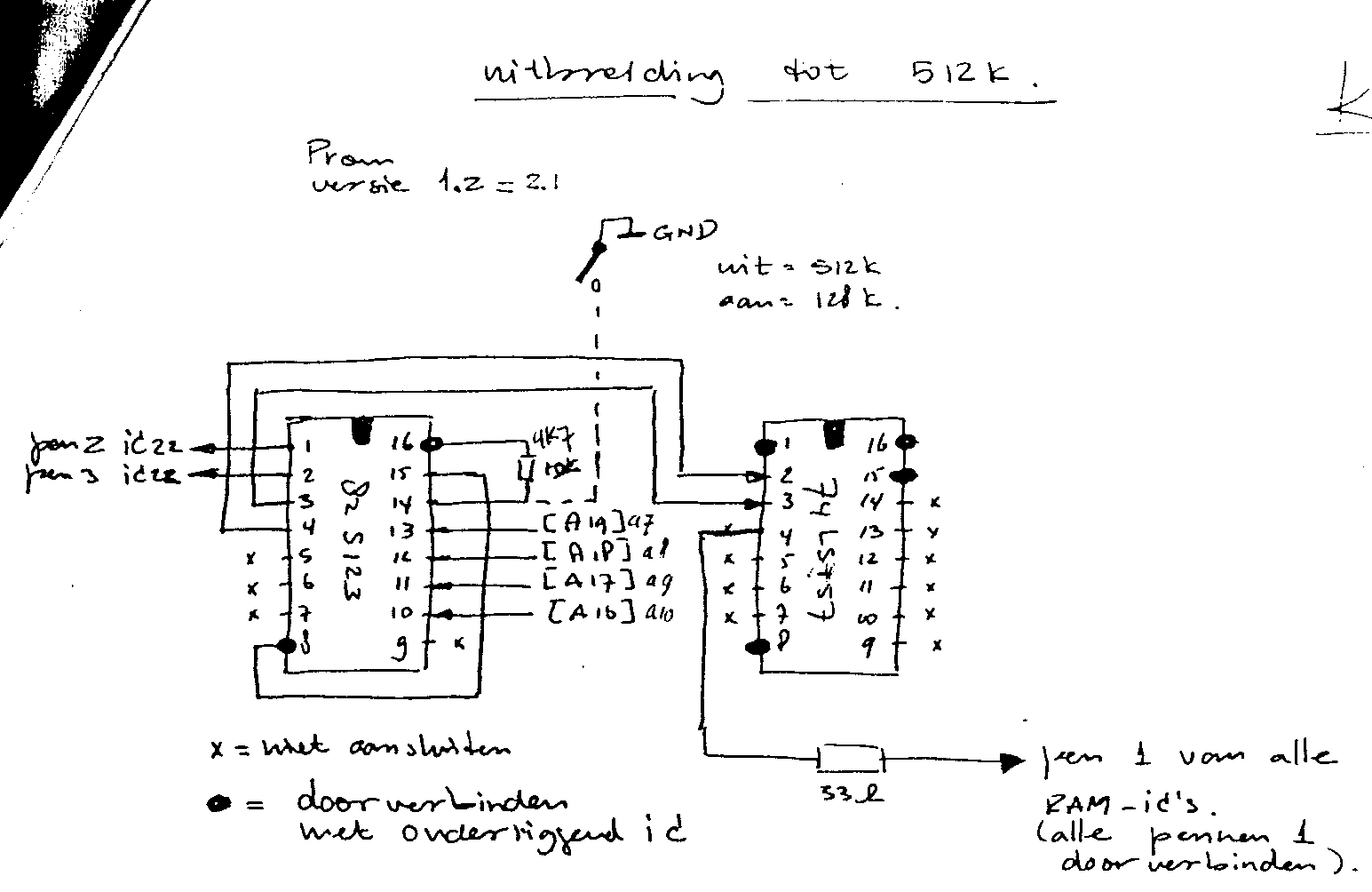

This is the famous 'Spanjer' RAM expansion, named after the father and son who supplied (and optionally fitted) it.
They soldered out the old 64K chips, fitted 256K chips, and added a bit of extra logic (74LS157 multiplexer and PROM for address decoding). The result was 512K internal RAM, which could be disabled by a small switch on the back (it was connected to a line on the PROM which activated the original address decoding).
No surprise that your Trump Card still works with it, it's still internal RAM connected to the ZX8301 with all its drawbacks. Your Trump card simply conceals it with its own RAM, which is on the CPU side of the bus.
(I can supply the schematics if you're interested).

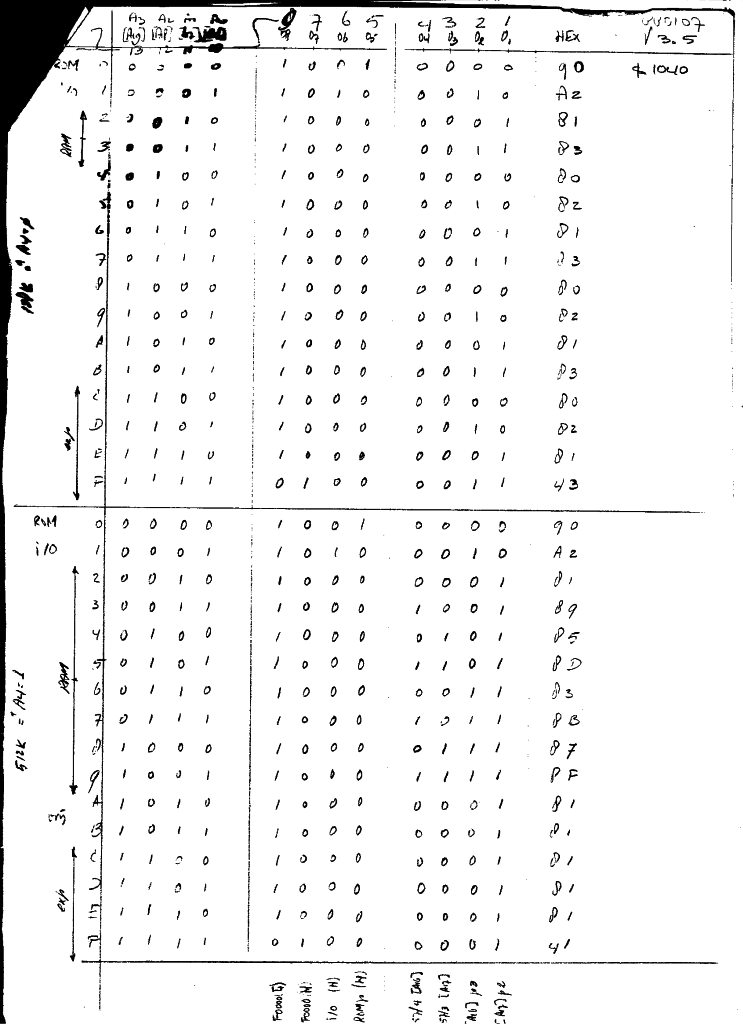

Probably something similar; here are the schematics:
