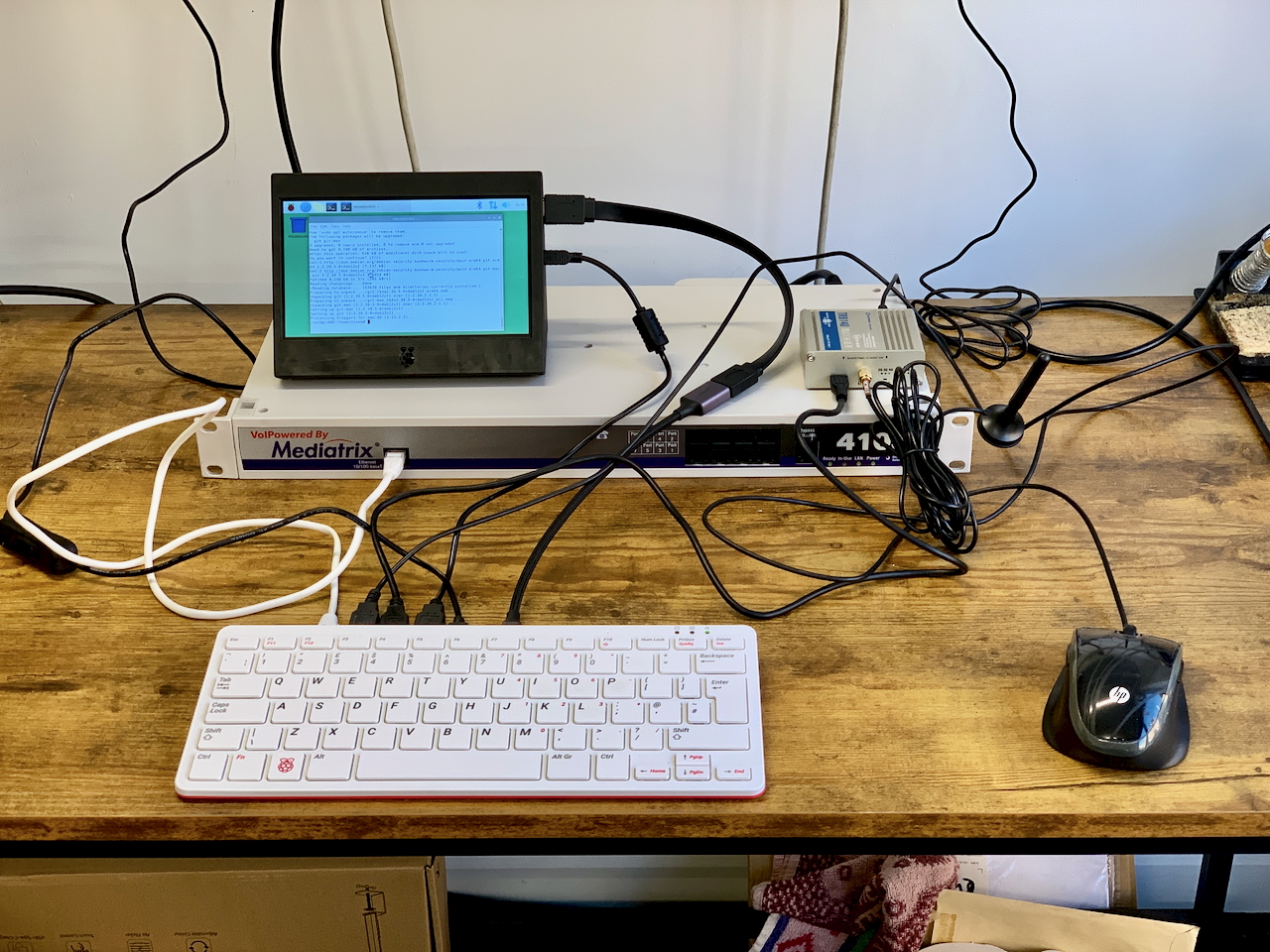

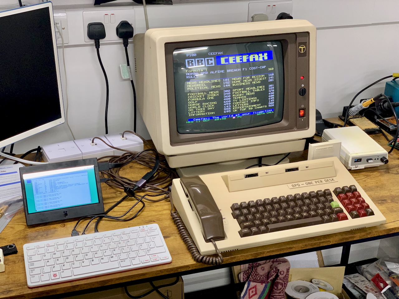

tofro wrote: Sat Jun 14, 2025 10:21 am The Tonto/OPD has its own in-built telephone modem and doesn't need any server back-end or "minicomputer" to communicate directly to another OPD. Messaging between OPDs should work without any other equipment in-between than a working analogue phone line (which you won't find anywhere in developed countries anymore) or a digital phone line capable of creating analogue modem connections (which you might find in developed countries - but rarely -, depending on your and your peer's telco)
You can buy copper to VoIP gateway boxes cheaply on eBay (or less cheaply new) and hook them up to Asterisk virtual PBX with virtual 1200/75 modems easily enough.
https://glasstty.com/building-a-standal ... bled-pabx/
Here's my OPD connected up that way... With a Raspberry Pi 400 acting as the PBX, virtual modem and serving Viewdata pages.
And here's the copper-to-VoIP gateway which I picked up for less that £30 on eBay delivered.
