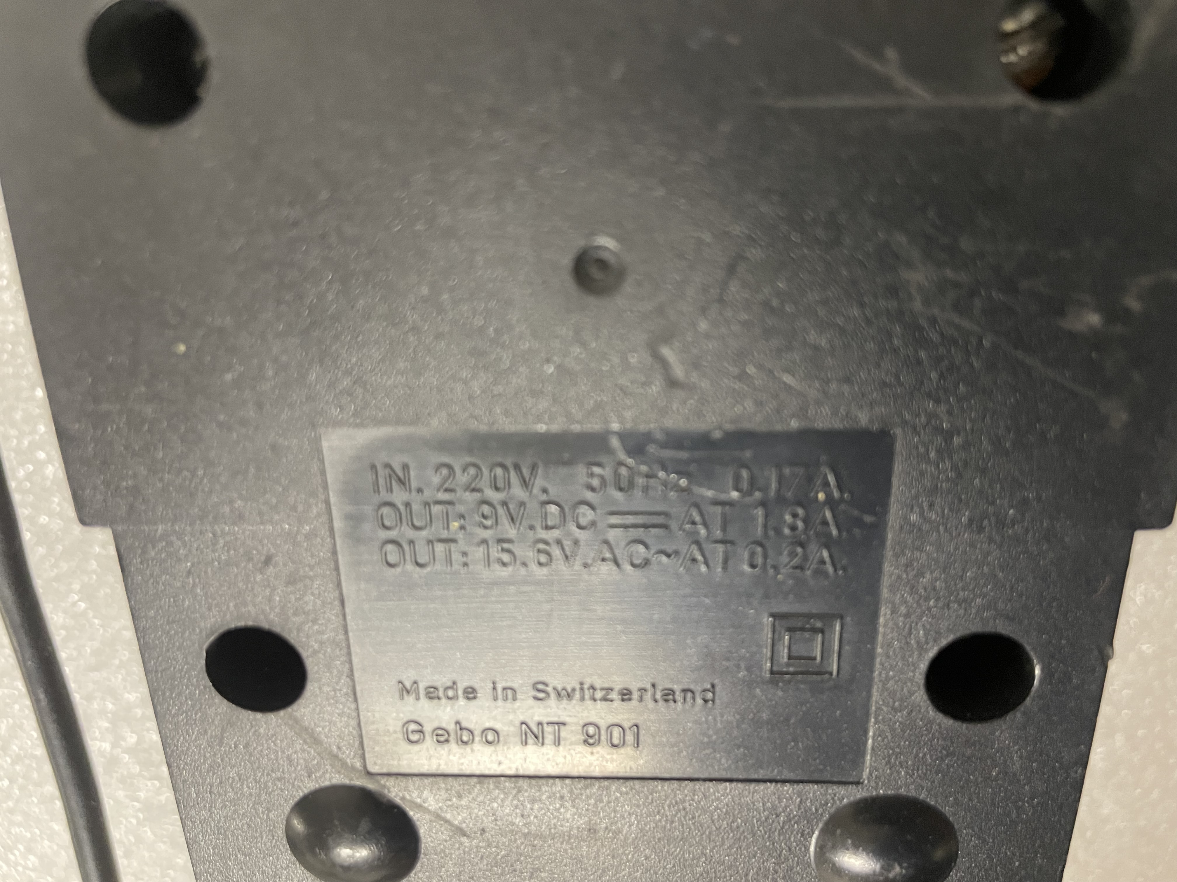

As much I understood the video it was planned and made for German (and/or Swiss) market but never issued due the problem with already existent packaging (it was bigger, hence no room). But it was prepared for serial production (mouldings for serial production were ready, at least some examples produced) by Swiss company Gebo (Gebo NT 901 was the notification on type shield). I’m aware that it is ultra rare, I heard for the first of it in the mentioned video, and I was unable to find any pictures of it…

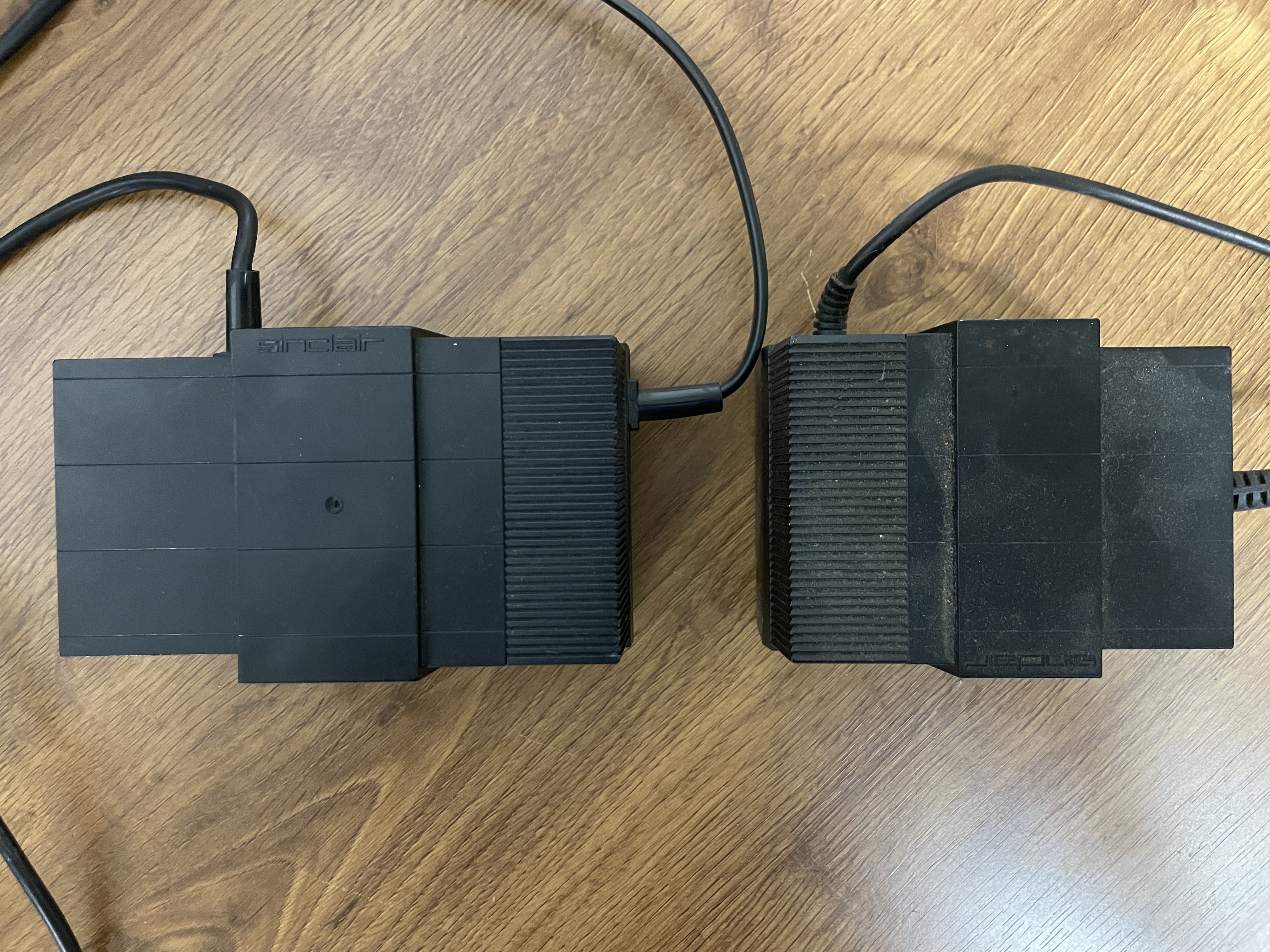

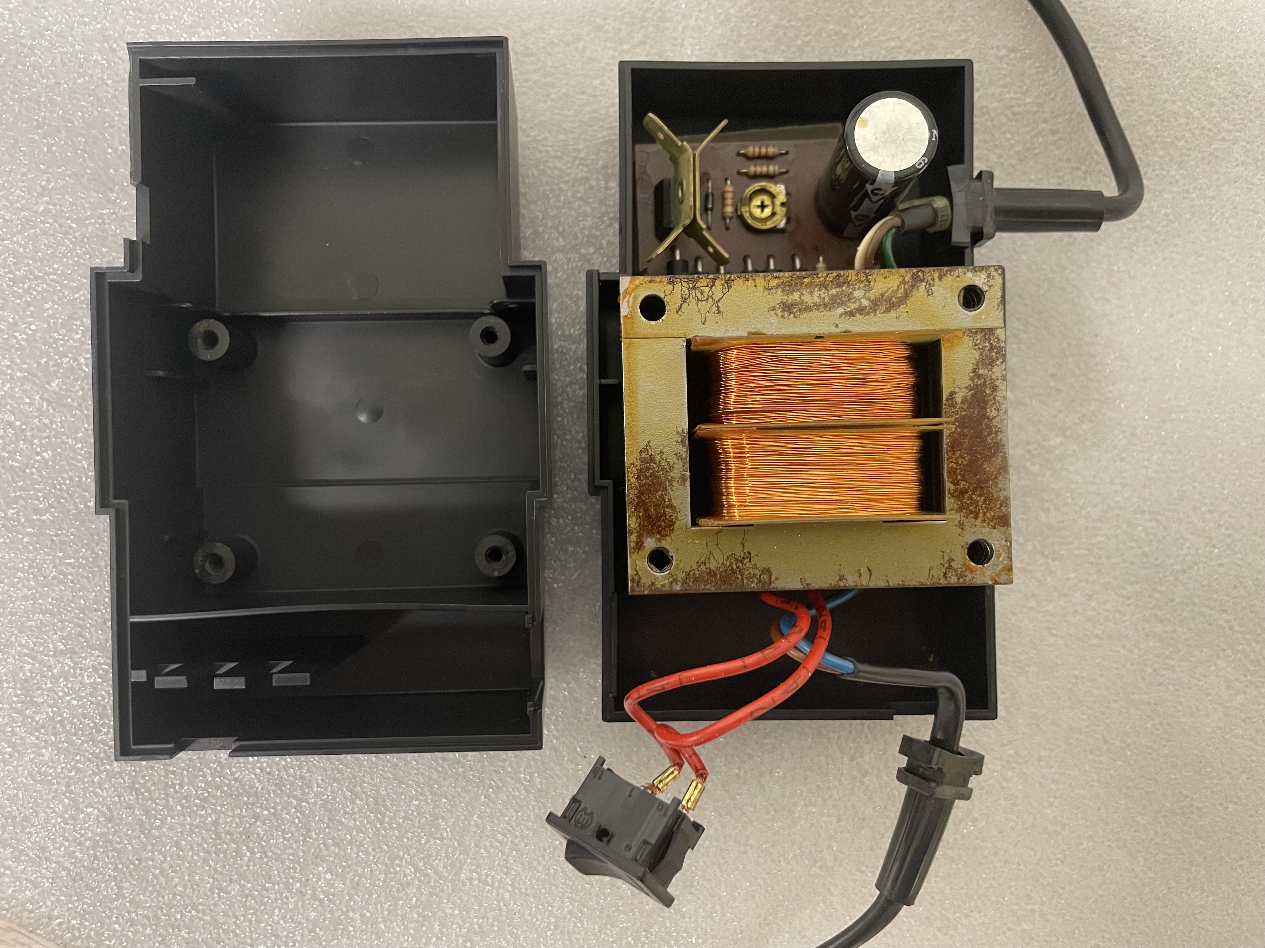

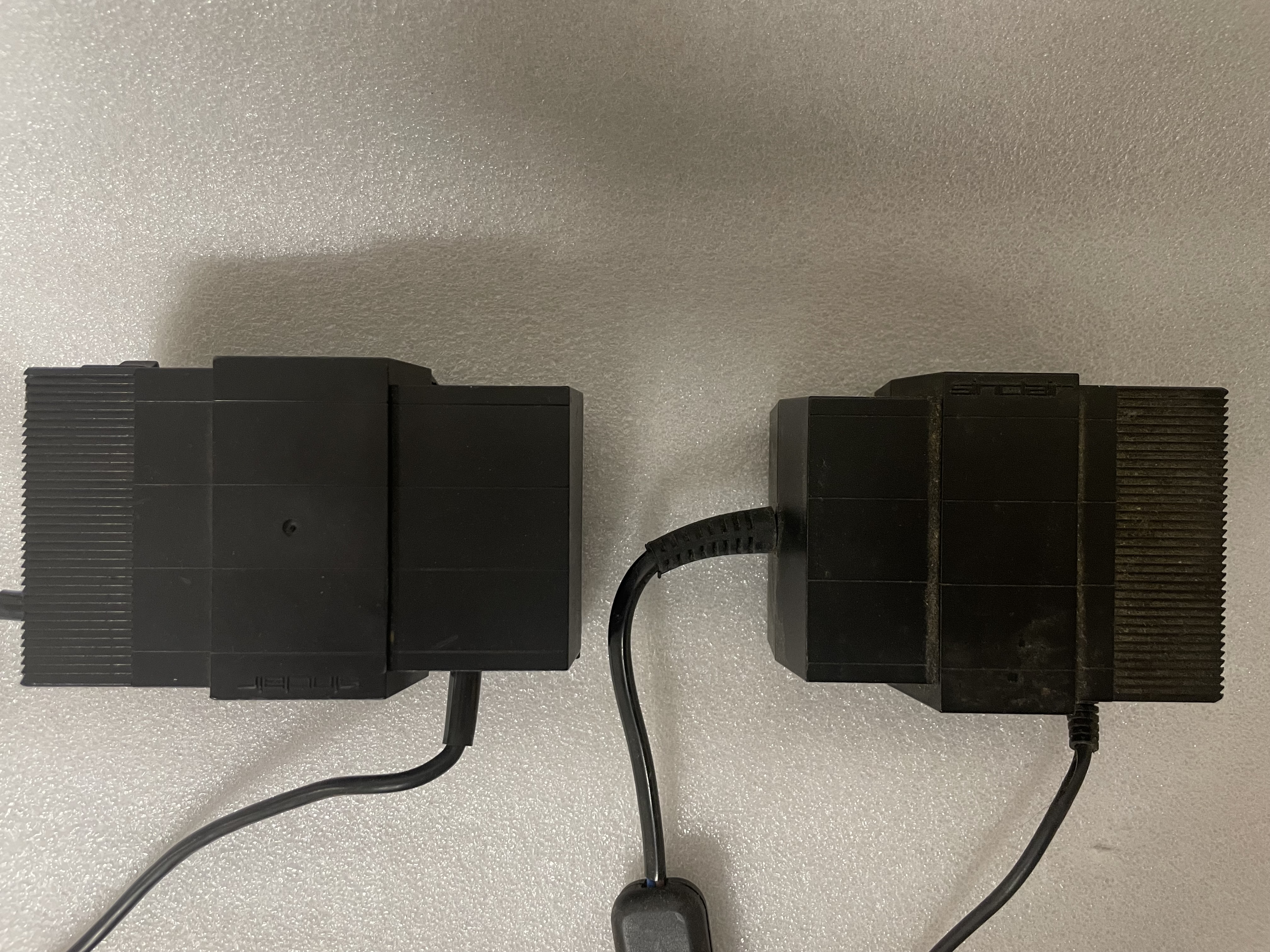

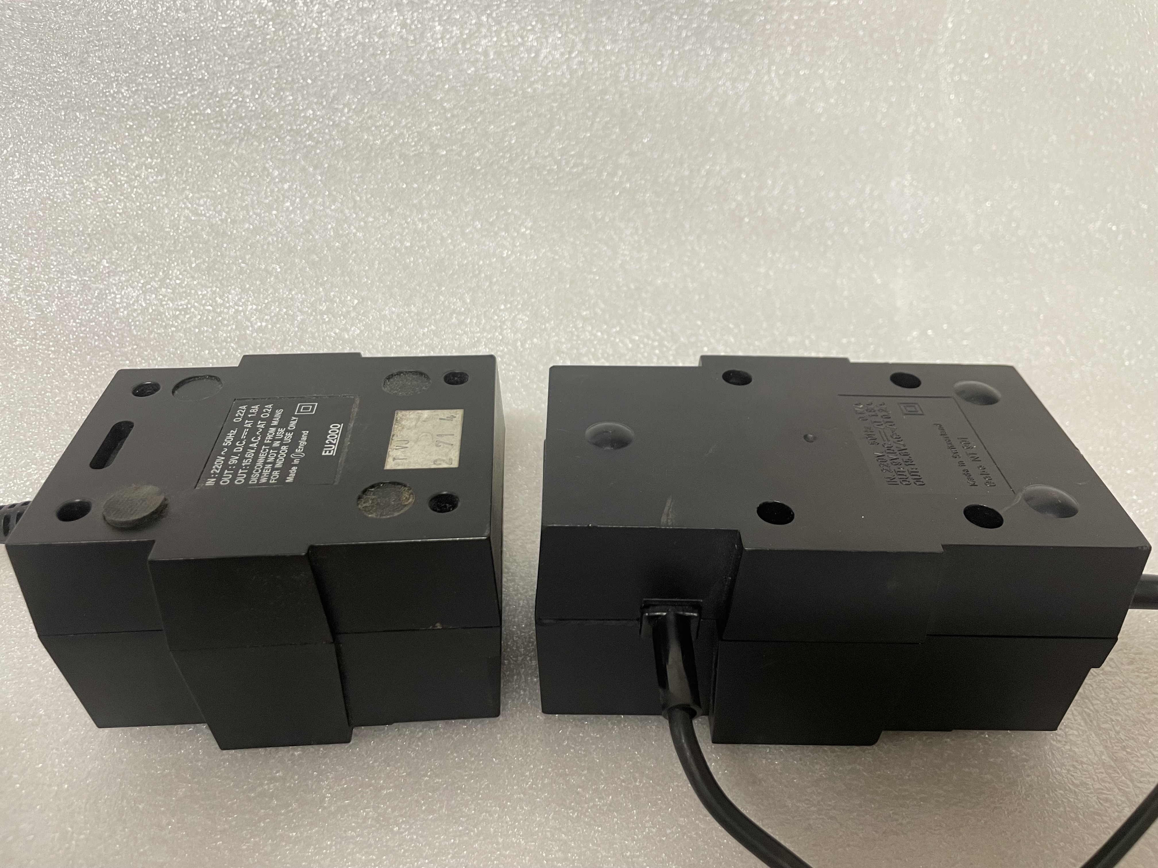

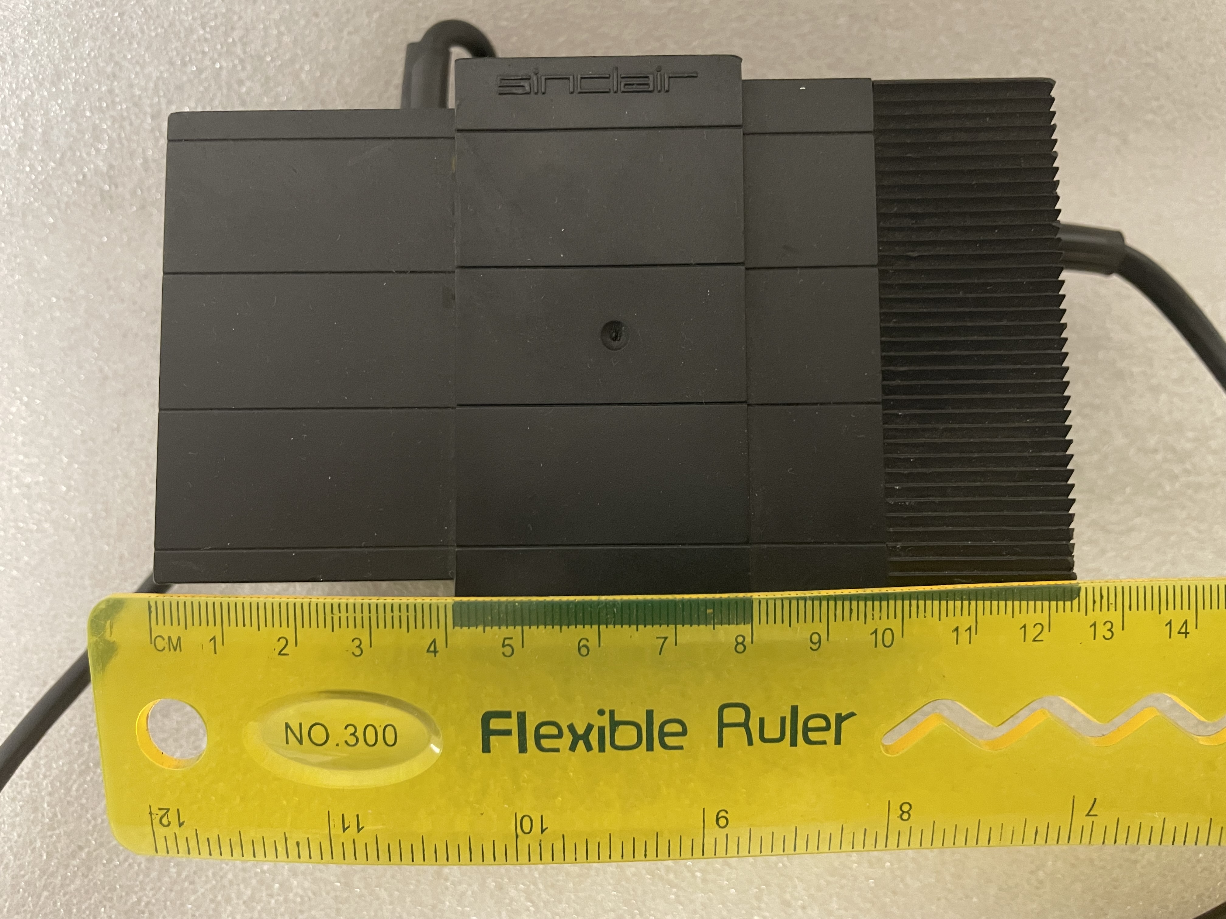

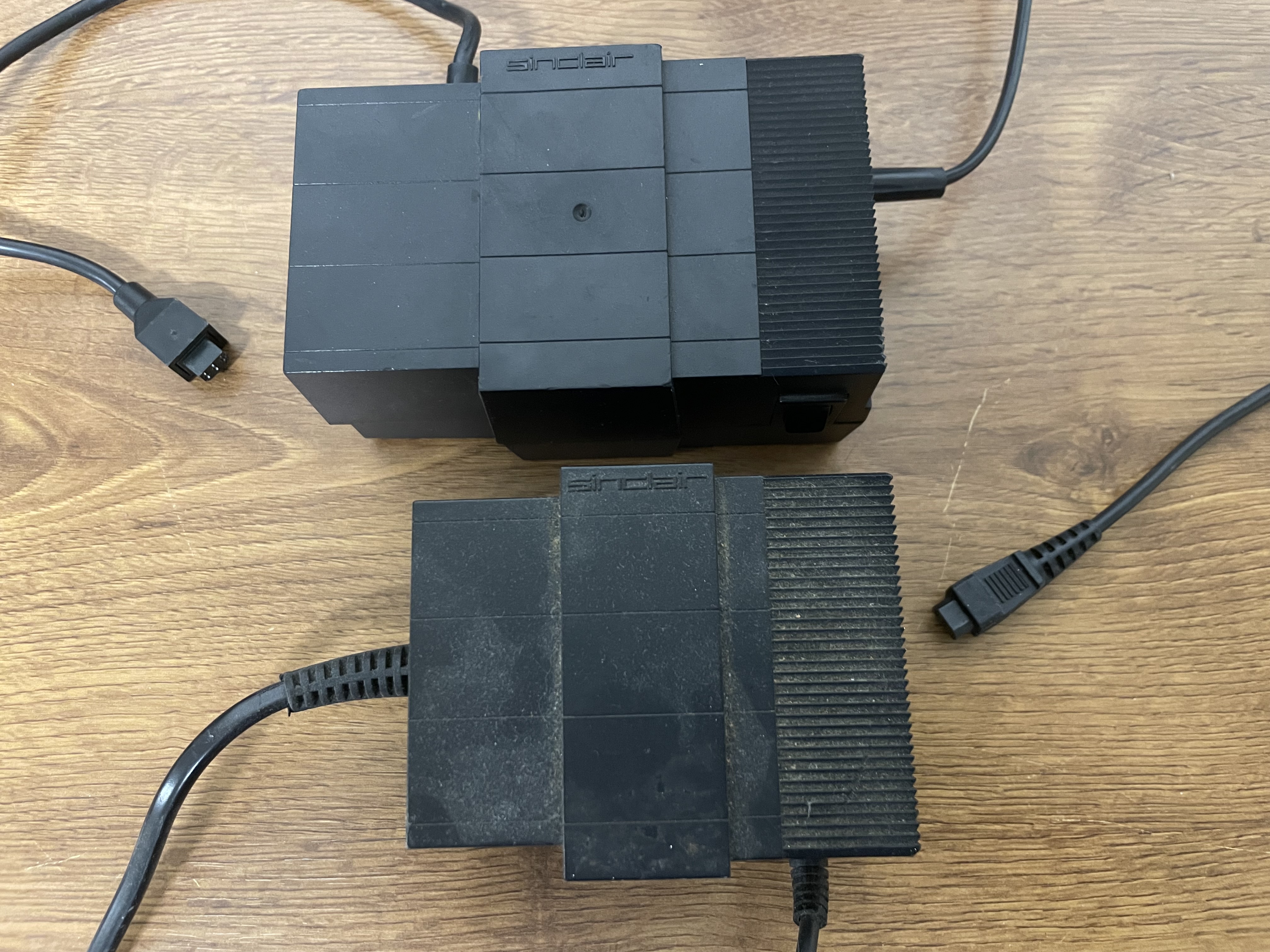

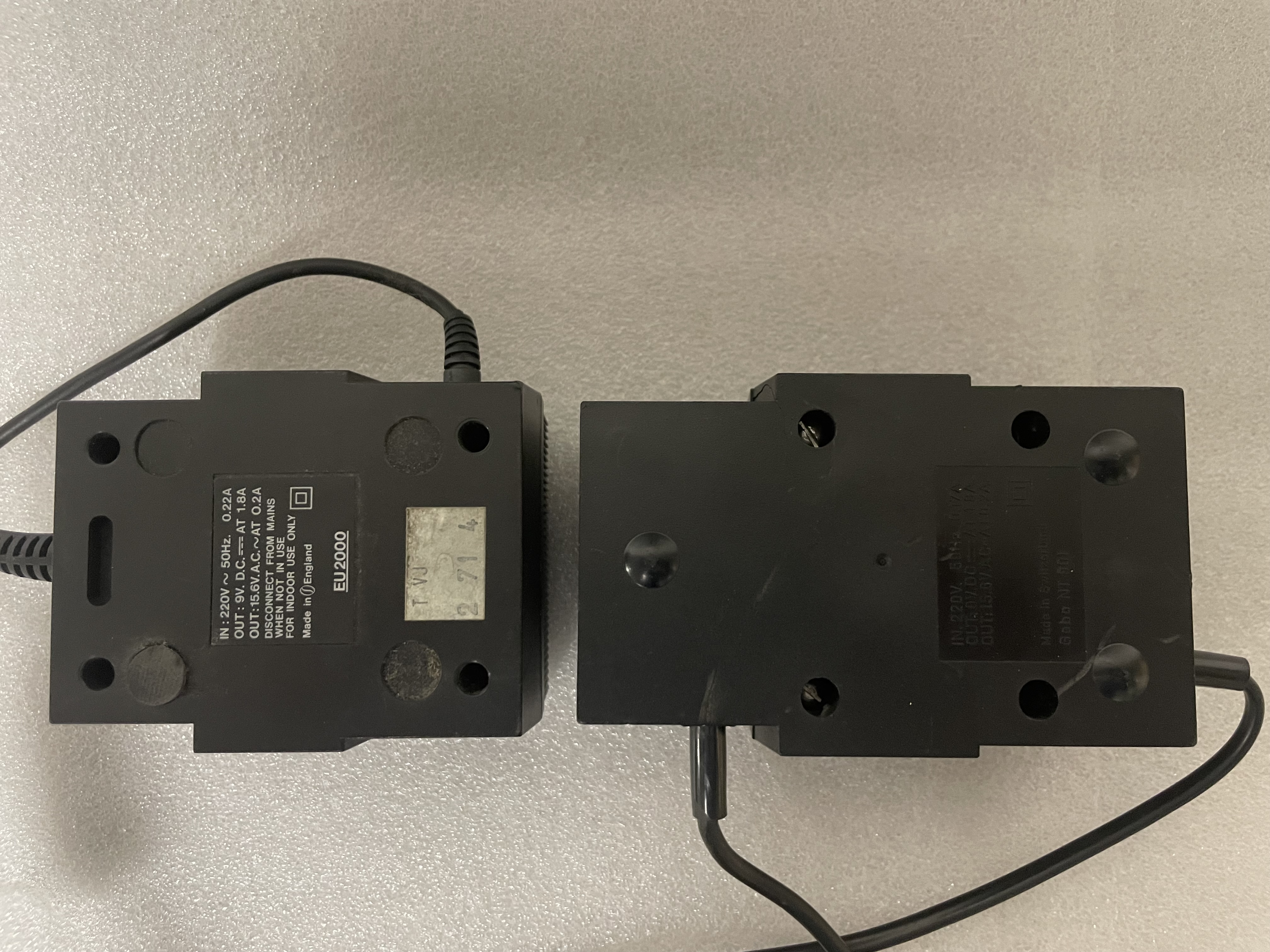

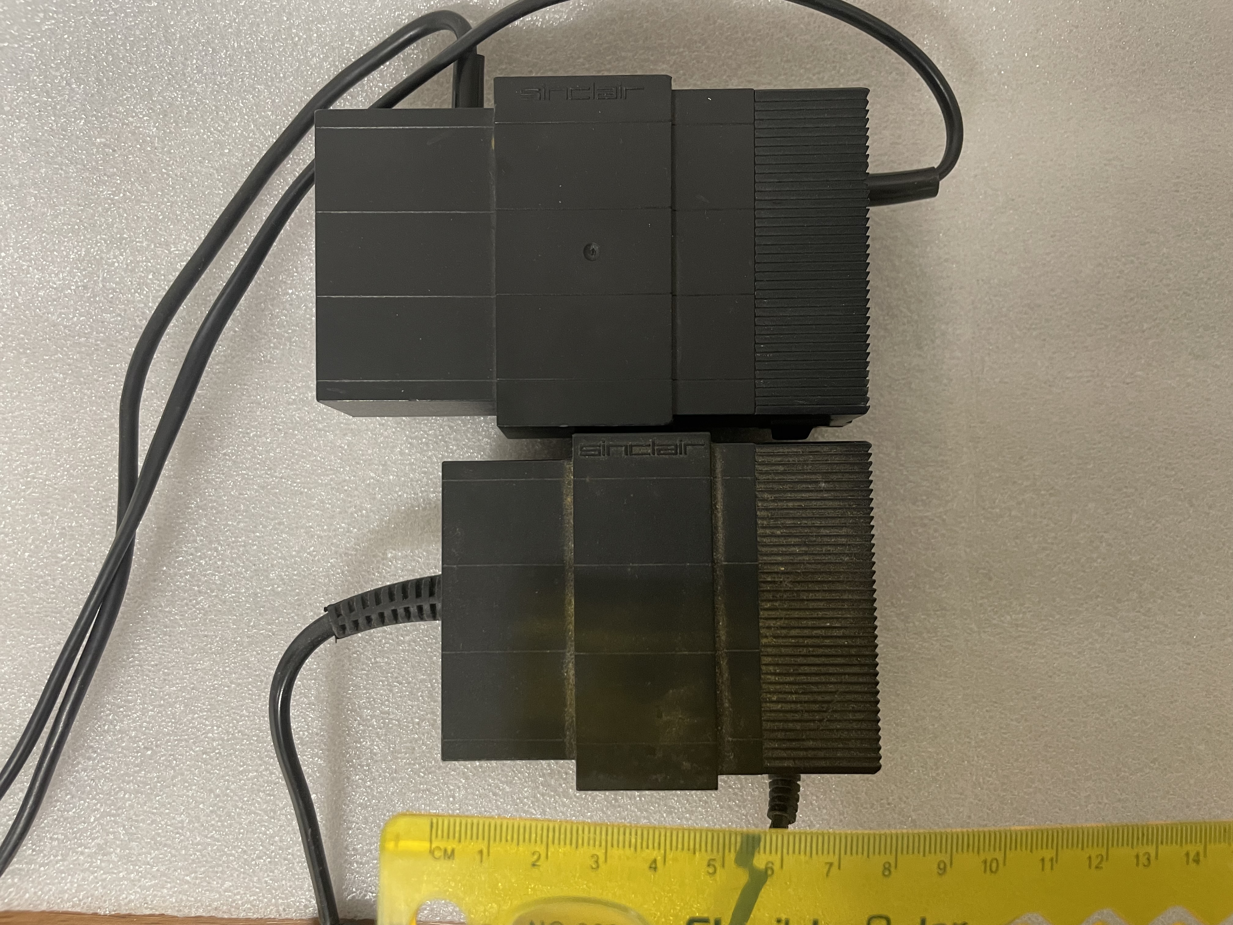

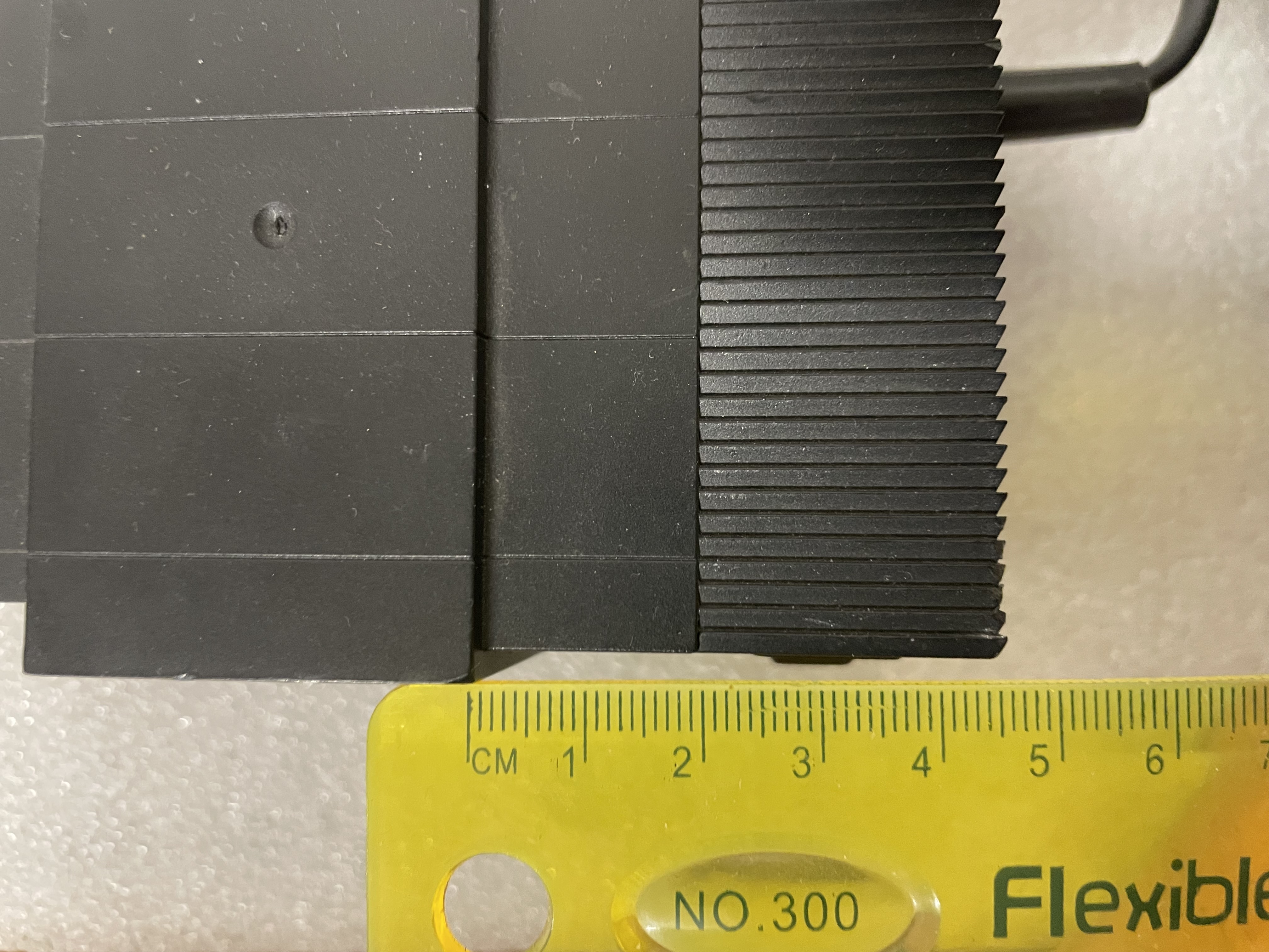

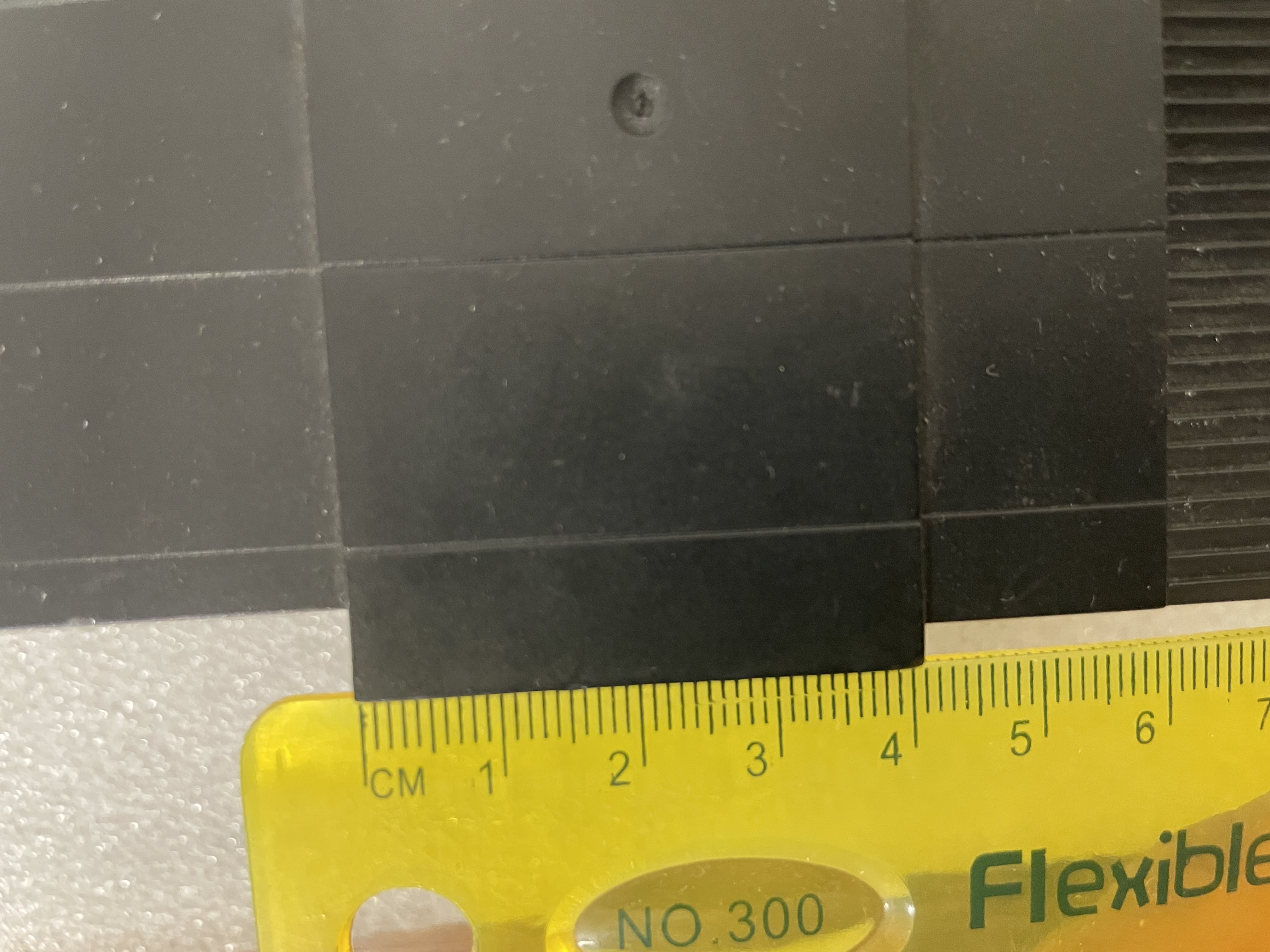

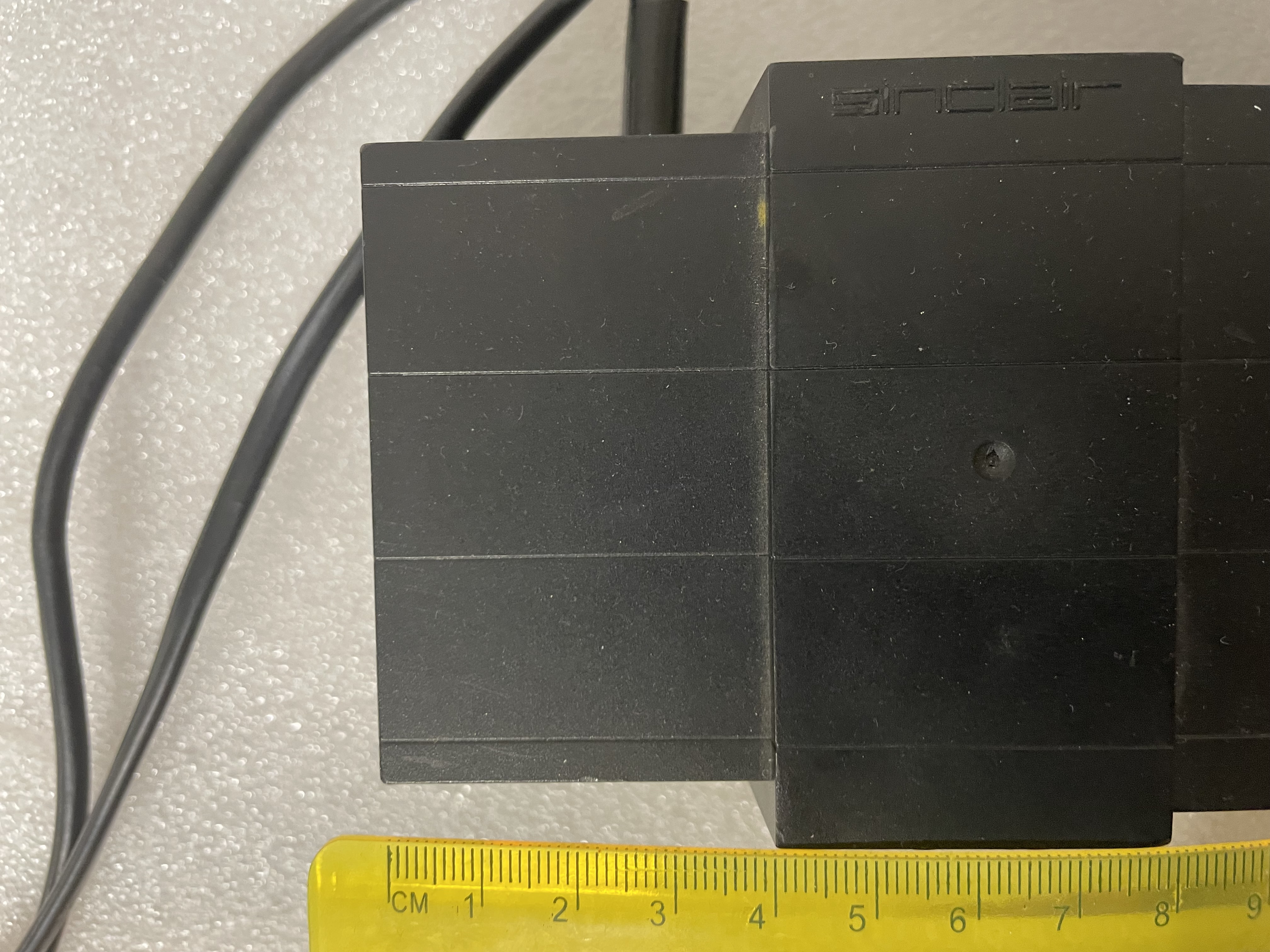

I have taken 15 photos.
The power supply is bigget than the usual one (which has 9-10 cm) with 12.5 cm, divided into 3 sections by 4, 4 and 4.5 cm.
Other dimensions (width, height) are the same as for the old one.
It was manufactured in Switzerland, I have photographed the internals, too.

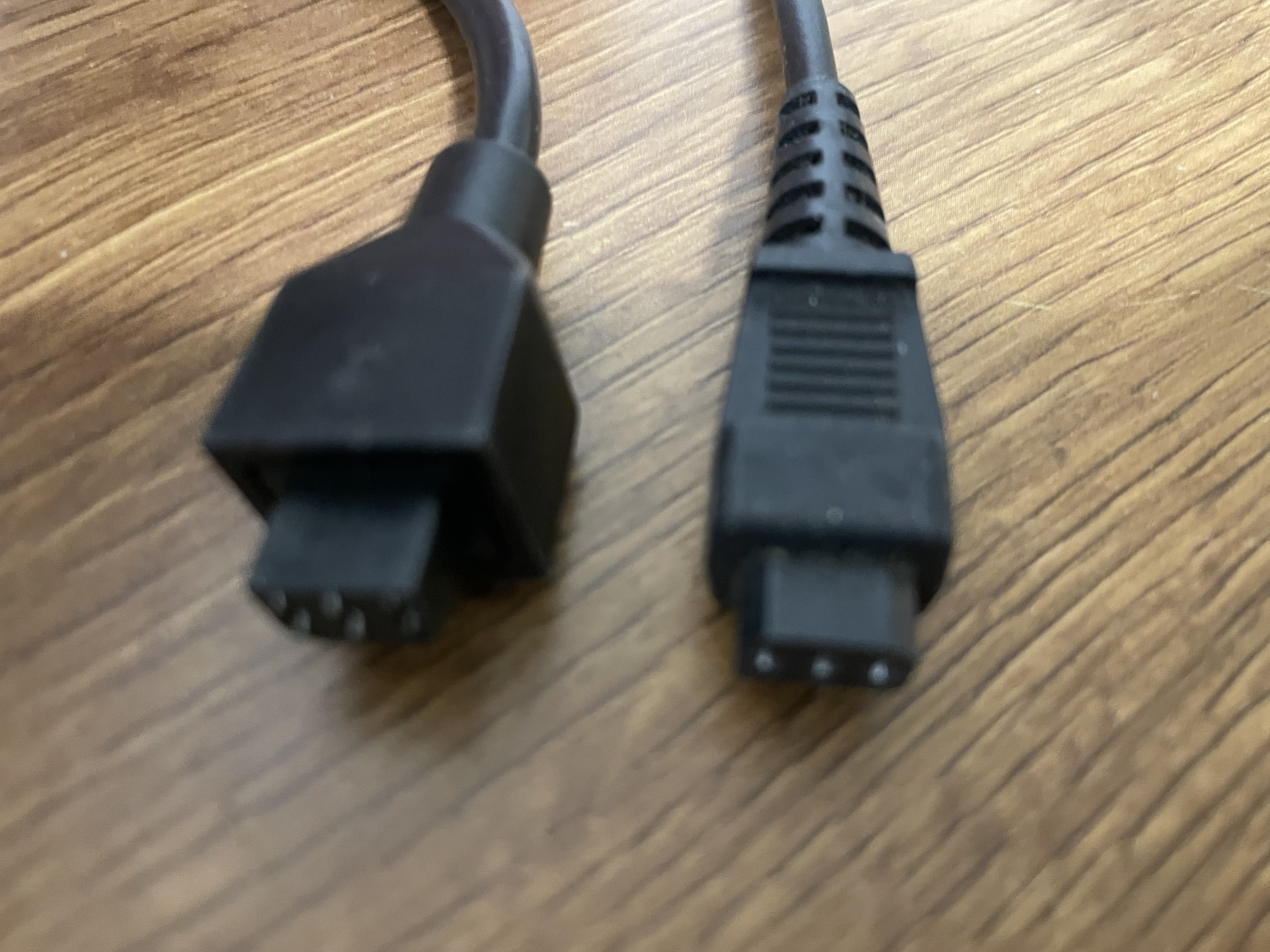

Interestingly the power supply connector is different (bigger), too.

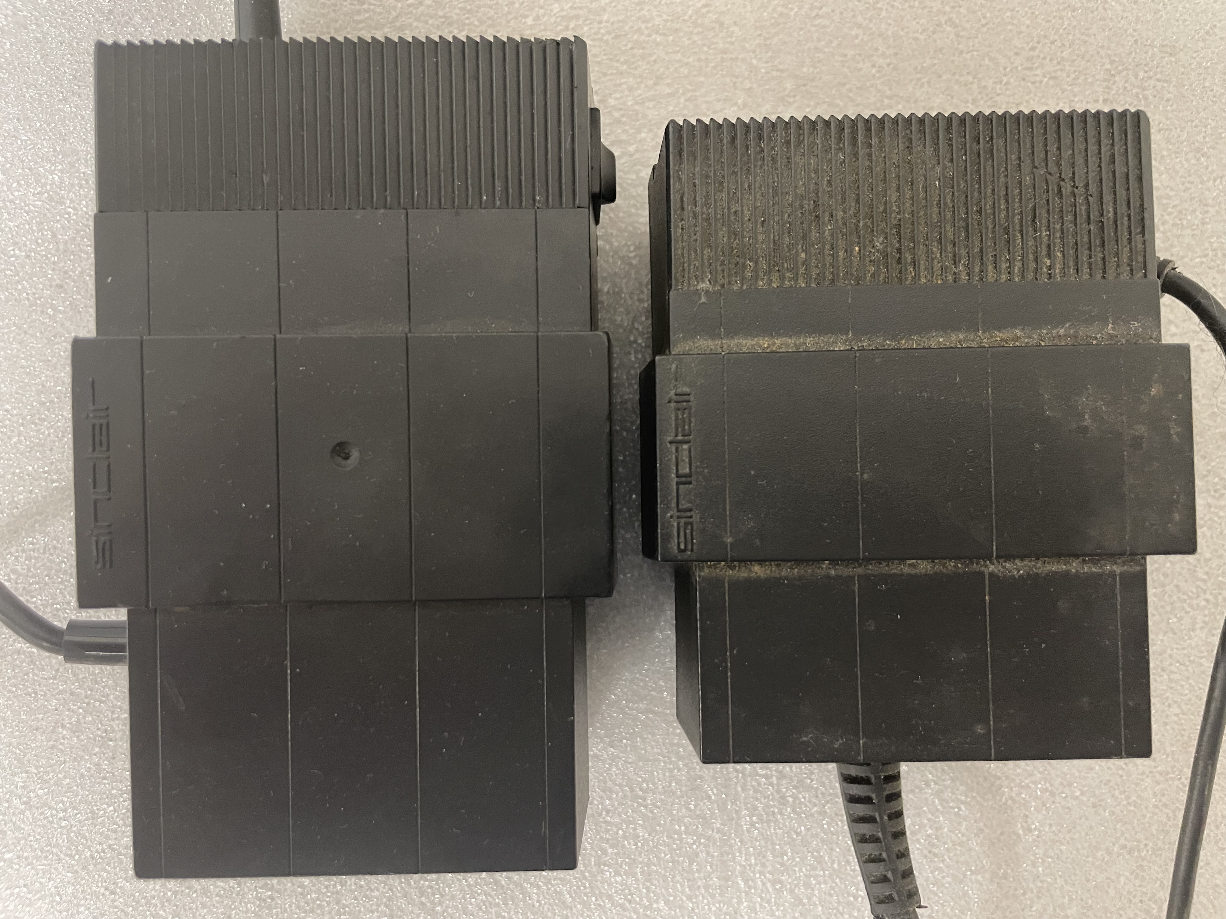

More pictures:

Last batch:

Excellent, it’s so much more than I expected! Thank you so much! Plan is to do a 3D model of it and build one with some extras…
