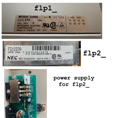

Thanks for the suggestions. Here's some more info...
The power supply runs to the case for flp2_, and there is no 12V line that I can see.
I bodged a spur off this to power flp1_ and sellotaped the two drives together to make a dual unit.
I have taken it apart and taken photos to show the relevant bits below. I'm sure I haven't taken anything away from the setup since mothballing it.

Posts: 1222
Re: Floppy drives not working
From the NEC 1037 Datasheet

Posts: 3159
Interesting. The data sheet for the NEC drive says it wants 12Volts

Posts: 1006
That FLP2 is clearly marked as 5v version both on the case and PCB
