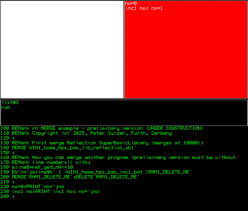

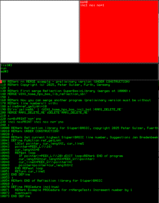

It seems you are not the only one who don't understand what I want to achieve. I have now written (currently only in SuperBASIC) the function ref_getLnHi which returns the currently highest SuperBASIC line. Jan's example unfortunately didn't work, but his explanation is correct and I found the SuperBASIC program structure in Jan Jones book in appendix C.Martin_Head wrote: Sat Apr 19, 2025 10:23 am I'm not sure exactly what you are trying to do. But could you pull the 'ED' code from the SMSQ/E sources, and modify it to take it's input from a file instead of the keyboard.
So here's another example, which hopefully makes it clearer what I want (and it's working). NOTE: Preliminary version. The program to merge must currently be without line numbers. I will extend rn so that it can renumber programs with line numbers. BUT I WILL NEVER SUPPORT GO TO, GO SUB (except perhaps for a special kind of computed line numbers). As ref_getLnHi is currently written in SuperBASIC it must be (of course) normally merged. I decided to load it at 10000 and all subsequent merged programs (without line numbers) are merged after it.

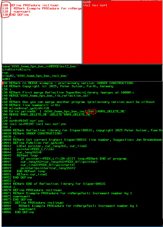

Edith (2025-05-14 Wed): Unfortunately I have detected, that this version of the rn program does NOT work correctly. DUNNO why it worked, when I have had tested it (I wrote: Tested it only once). More unfortunately: I cannot find the source, only that of the version, which only is working with "_bat" files (SuperBASIC programs WITHOUT line numbers), which I have attached in a previous message in this thread. This seems to work. I will have a look at it, but I'm currently extremely short of time.

Yeah! I think I have completed the rn version which ALSO(!) accepts line numbers (it should be even possible to give it a file, where some lines have line numbers and others not) - that's really a beta version (OK in my mind but tested only once):
Edit: The Change in Source Code (rn_c):
Edit:
It was really just one fscanf() in C (eat the line number from source [SuperBASIC] file) to correct the original rn program (which only worked with BASIC files without line numbers [_bat files]).
p.s.: If it really will be working –just tested once ;‑)
