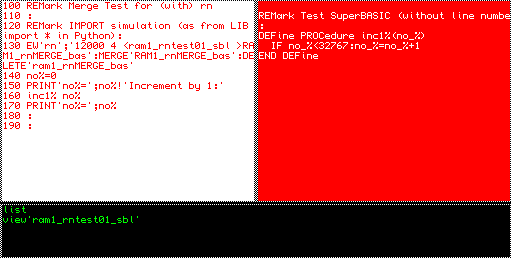

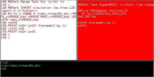

Posts: 3211
Re: My "from PACKAGE import *" (Python) simulation project
Well I'd guess that a
RENUM 1 TO;1,1
MERGE <to highest possible line number for inserted code (i.e 32767-line count)>
RENUM 1 TO;10,10
Should do as well. Admitted here's no chance to catch errors, but that shouldn't fail more often than any more sophisticated method. This is the pragmatic approach: Just make as much room as possible for the inserted code and when that turns out not enough, any other hugely more complicated method wouldn't have worked as well.....
