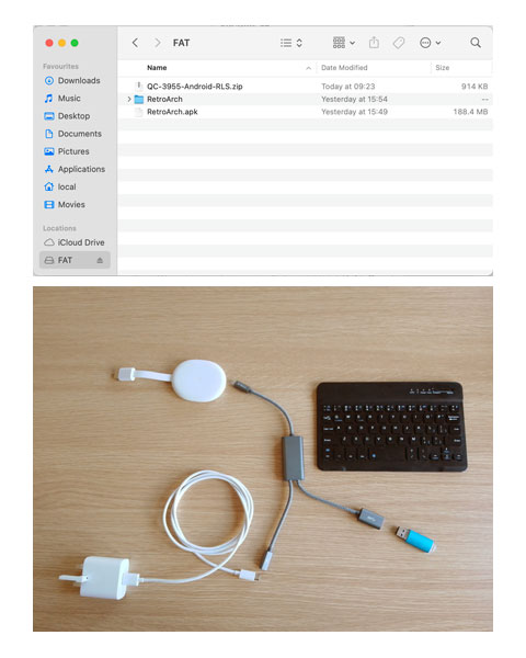

1. Download RetroArch and QDOS Classic onto a USB stick and connect it to the Chromecast.
1.1. Download the RetroArch.apk file from this URL.
https://www.RetroArch.com/?page=platforms
1.2 Copy the RetroArch.apk file onto an FAT formatted USB stick.
1.3. Download the following zip file.
It contains a current version of the QDOS Classic KickROM for UAE within a RetroArch settings folder.
1.4. Copy the zip file onto an FAT formatted USB stick and unzip
1.5 Connect the USB stick to the Chromecast by way of a Type C USB 3.0 Charger Splitter

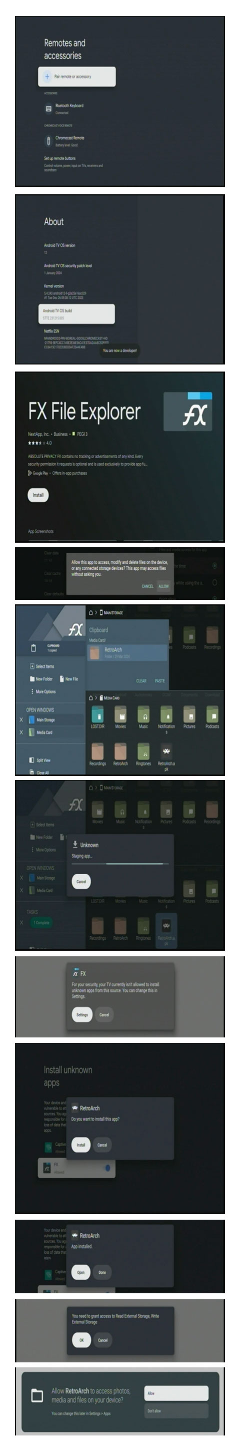

2. Connect a keyboard, enter developer mode, download a file browser and install RetroArch
2.1. Power on a Bluetooth Keyboard and place it into pairing mode
2.2. At the Chromecast Home page,
Select "Settings>Remotes and accessories>Pair remote or accessory"
2.3. Select and pair your keyboard.
2.4. At the Chromecast Home page,
Select "Settings>System>About>Android TV OS Build"
keep clicking until you see "you are now a developer"
2.5. At the Chromecast Home page,
Select "Apps>Search for apps and games"
2.6 Look for "FX" which is a decent file browser with a split screen option.
2.7 Install the App, and give it the appropriate permissions to read and write the filesystem
Select "Settings>Apps>See all apps>FX>Permissions>Files and Media>Allow..."
2.8 Copy the RetroArch folder from the USB stick onto the Main Storage
2.9 Double-click the RetroArch.apk file to install.
2.10 You will be told that the File Browser doesn't have the permissions to install unknown apps.
Assign the permissions and install

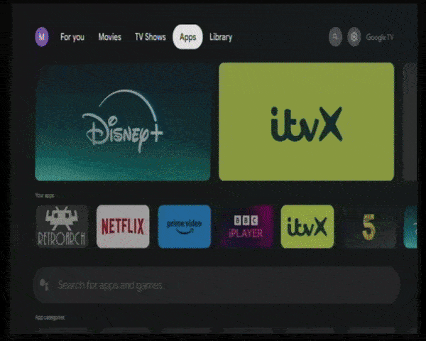

2.11 Open RetroArch
2.12 You will be told that the RetroArch doesn't have the permissions to read storage. Assign the permissions
Once RetroArch is installed, you can remove the USB stick and Charger Splitter and connect up the Chromecast as normal.

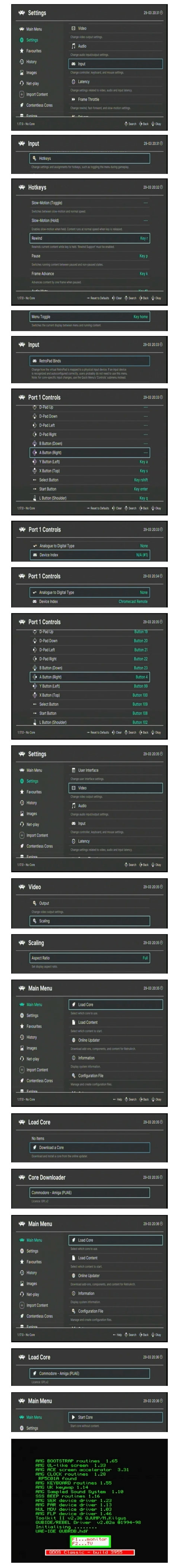

3. Disable RetroArch Hotkey mappings and launch QDOS Classic
3.1 In RetroArch, select "Settings>Input>Hotkeys"
3.2 In order to use the keyboard in QDOS, we need to disable all Hotkey keyboard mappings.
Hover over every option that says "key" and press the "a" key on the keyboard.
The option will change to "---"
3.3. Hover over the "Menu Toggle" option then press "Enter"
Hit a key on the keyboard that you would like to use to get you out of QDOS.
I use the "Home" key.
3.4 In RetroArch, select "Settings>Input>RetroPad Binds>Port 1 Controls"
3.5 Hover over any option that says "key" and press the "a" key on the keyboard.
Do the "key a" option last, as this is the key used to clear the options.
3.6 Hover over "Device Index" and press a button on the Chromecast remote.
It should change from "N/A #1" to "Chromecast Remote"
3.7 Hover over "D-Pad Up" and press enter. When asked, press up on the Chromecast remote.
3.8 Do the same for other keys on the remote
"D-Pad Up" = "Up"
"D-Pad Down" = "Down"
"D-Pad Left" = "Left"
"D-Pad Right" = "Right"
"B Button (Down)" = "OK"
"A Button (Right)" = "Back"
You can now use the Chromecast remote to set RetroArch options
3.9. Select "Settings>Video>Scaling>Aspect Ratio", and set it to "Full"
3.10. Select "Main Menu>Load Core>Download a Core>Commodore - Amiga (PUE)"
3.11. Select "Main Menu>Load Core>Commodore - Amiga (PUE)>Start Core"
QDOS will load.

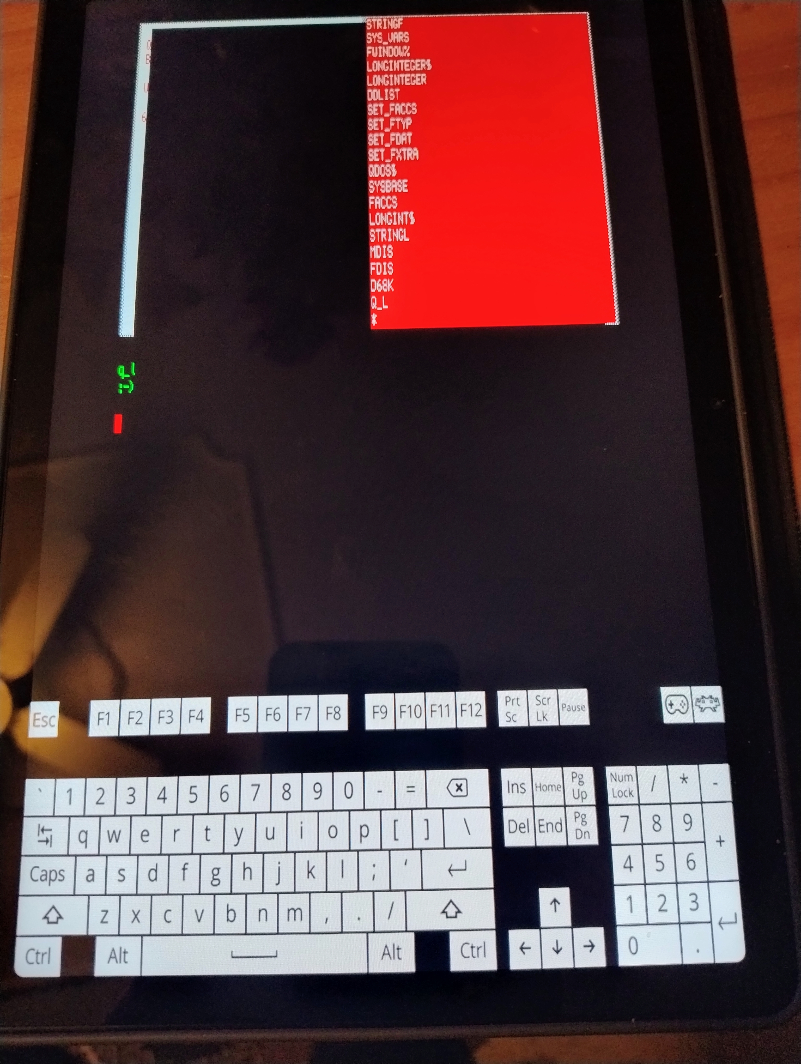

I have been using this on a Samsung Galaxy A9+ SM-X210 11" Android Tablet.
Bluetooth keyboard not shown.
There is an on-screen keyboard by pressing Select, but it overlays the emulator window, still have to use an external keyboard.

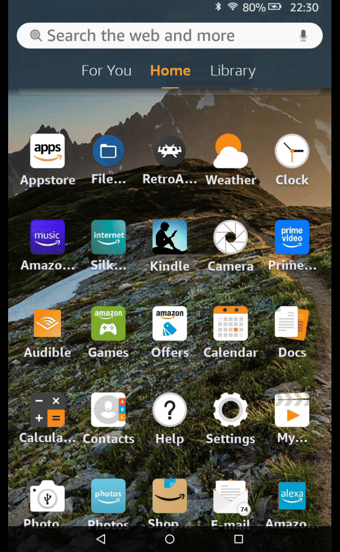

I have this working on an old Kindle Fire 7 running FireOS 5 (android 5.1) that had been relegated to the tech drawer.
I had to copy "puae_libretro_global.uae" from the "saves" directory into the config directory, then rename that copy to be "puae_libretro_android.cfg".
Configuring RetroArch is notoriously difficult as they seem to be always moving the goal posts.
The download I used from the Amazon store was the latest at the time at version 1.20.0.
If you use a tablet in the vertical orientation, it's possible to have the on-screen keyboard at the bottom of the screen. There is a site that explains various keyboard configurations here some of which proved useful when I was setting it up. I still prefer a physical keyboard though.Derek_Stewart wrote: Sat Apr 05, 2025 7:46 pm There is an on-screen keyboard by pressing Select, but it overlays the emulator window, still have to use an external keyboard.
Although of limited use, it's still cool to see QDOS running on old tech.

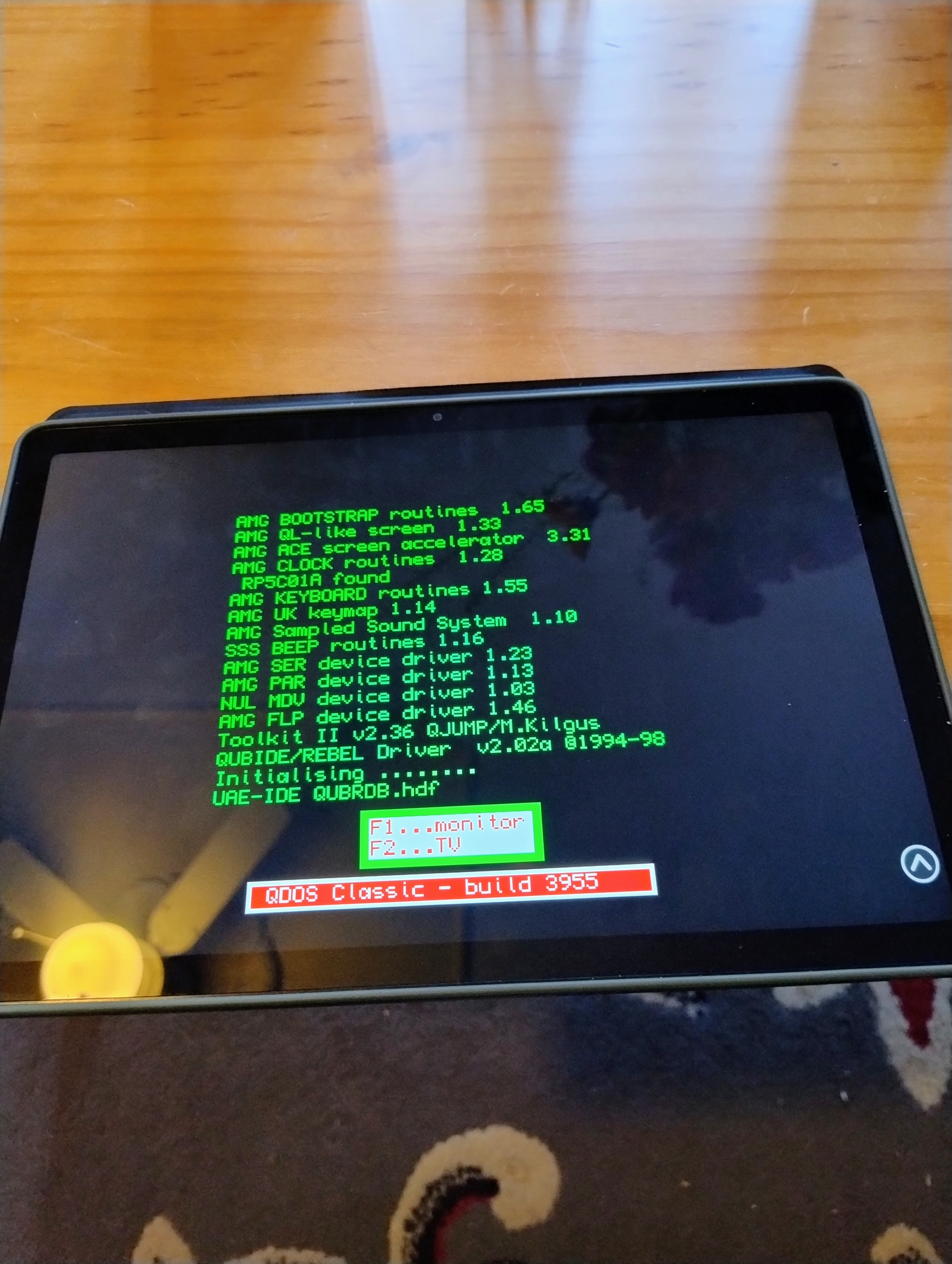

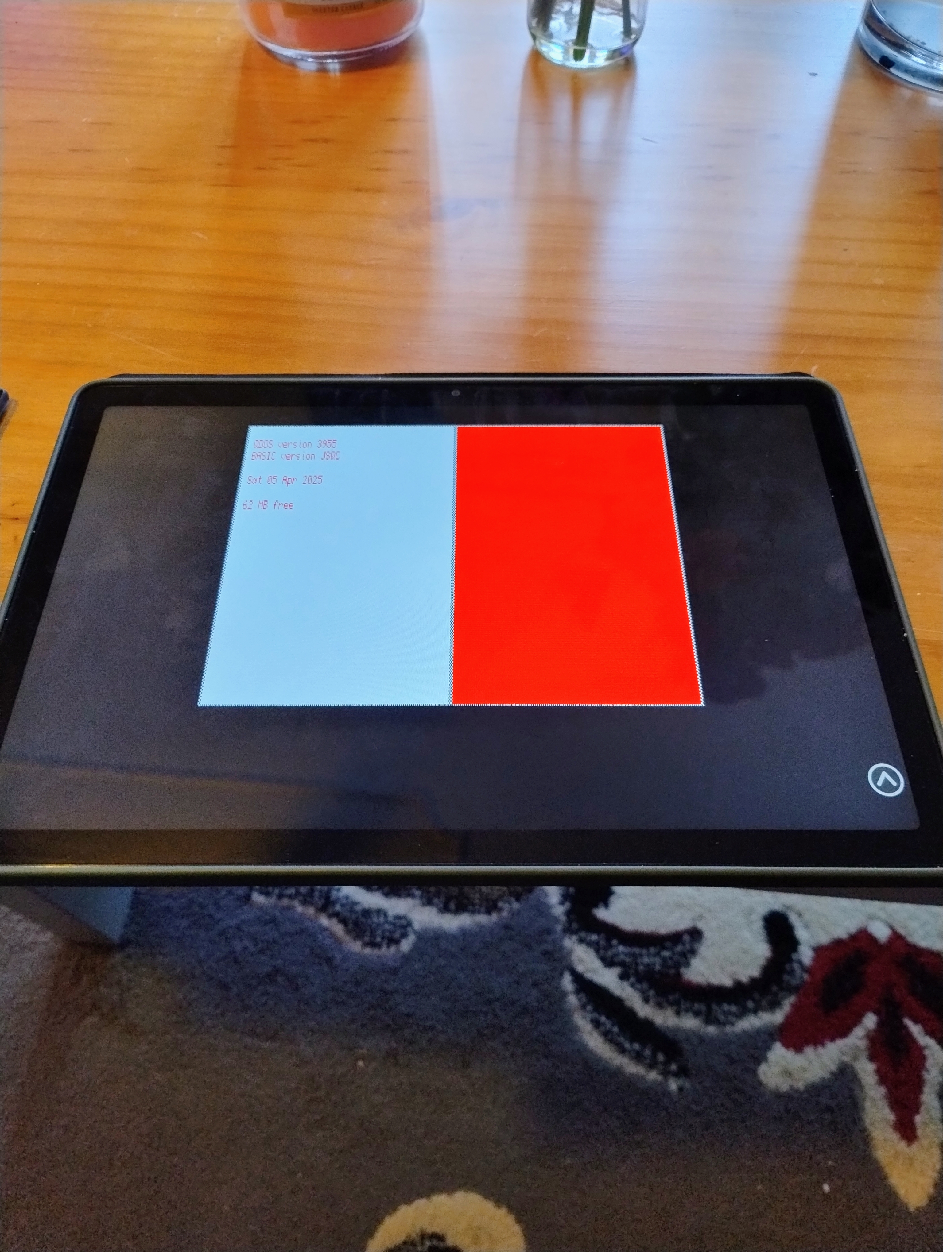

- Posts: 4809
Re: QDOS on Google TV walkthrough
Had a little fiddle around with the setting, gave :
