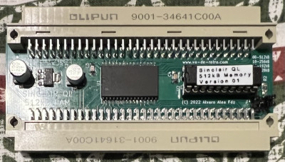

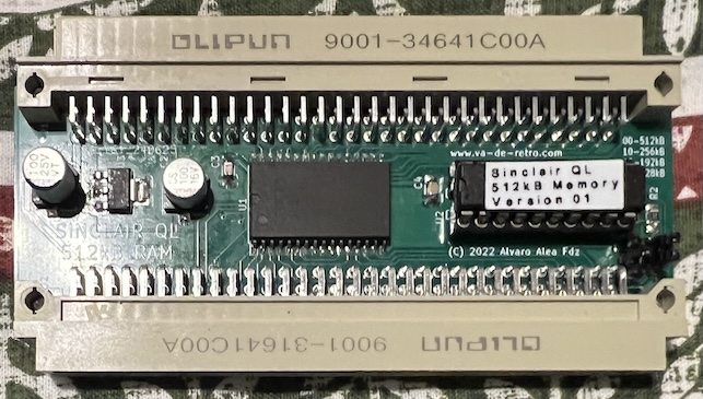

My memory expansion board (available in GitHub) is about 5cm, (I can design you one of the dimensions you want, is very simple).
Using a unpopulated PCB of memory expansion is also a solution, but you are extending the wires more than necessary and in some cases can cause problems (reflections).

But do you mean I could just remove the memory chip from one of my expansion boards please? (I'm assuming the memory IC is the socketed IC)
Just realised the socketed IC is the GAL
Don't want to destroy the card so will leave it "as is" and look for another solution

Removing the gal and put a jumper of cable between pin 19 and 20 of the gal socket shall be enough to disable the ram, but I was talking about a new PCB without any soldered but the 2 connectors.

Though having said all that, as it's non-destructive, I may try modding the memory board as per your description, as a stop gap, to allow SGC removal for MDV recoveries
