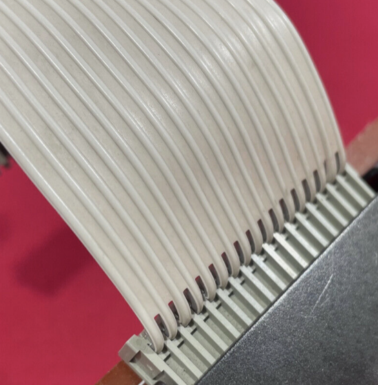

I was wondering if anyone knows what type of ribbon cable this is please?
When searching the web all I find is normal ribbon cable which is the wrong width between cables
The image is actually a BBC ribbon cable but they are too short length wise
I think it would be a simpler job to repair with the correct ribbon cable

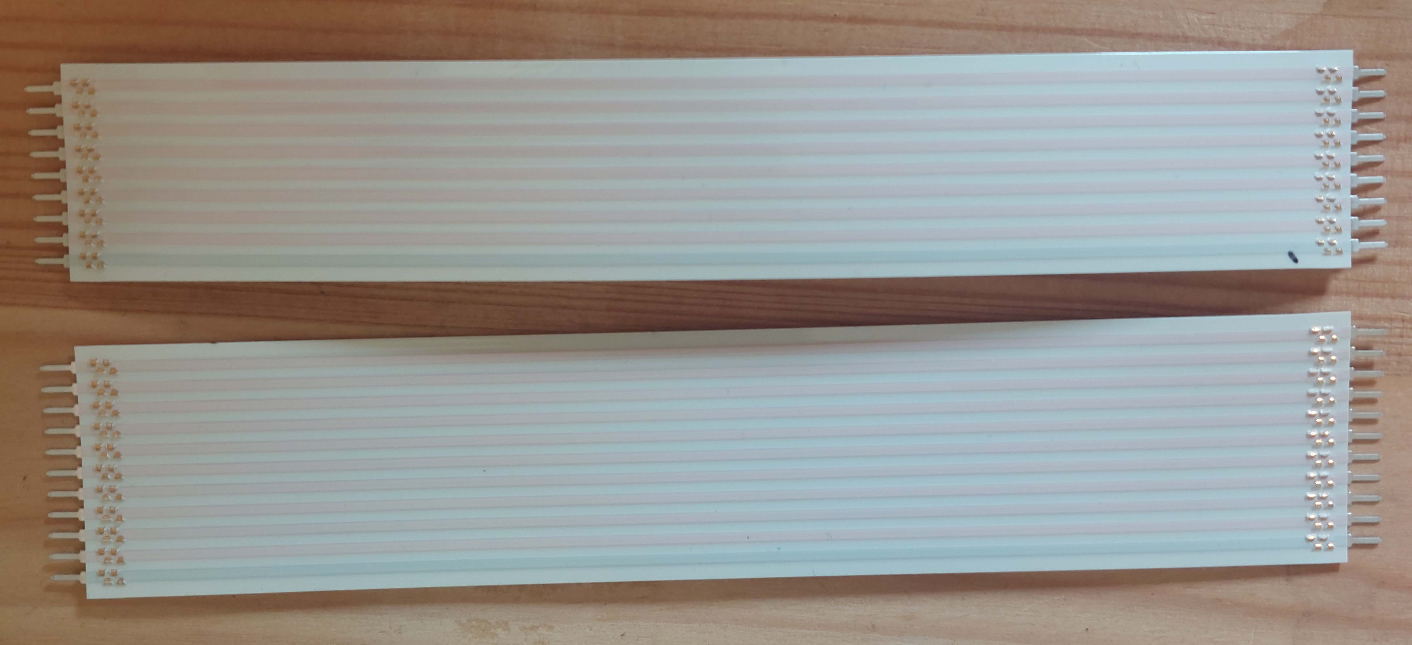

The actual Schon cable (with a dodgy looking jumper lead!)
Specifically I need to replace the 9 pin at the moment, but may do both if that goes well

I've swapped out the 2 ribbon cables for breadboard cables now and the Schon is working again
The QL case only "just" fitted back together though because of the extra thickness of the cables. Am hoping I never need to open this QL again

I used the cables below.
Soldered one end to the keyboard and the other end fits tightly in the keyboard connector on the QL board. Its the correct pitch.
Bought from Digikey. Manufacturer code A9AAT-1106F and A9AAT-0906F
