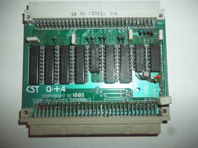

Later, I got a CST Q+4. This could handle up to four plug-in cards, all of which could have onboard driver ROMs even on those early ROM versions - it had an onboard ROM which corrected the defect in pre-JS ROMs to allow them to find more than one such card. A short ribbon cable came from the base unit to its own circuit board which plugged into the QL expansion slot. The Q+4 was a big, heavy beast. Black metal-cased, it sat under the QL and needed its own power supply, which superficially looked like a QL power supply (it probably was a QL power supply, the connector looks similar in the picture below, I sold the Q+4 many years ago). No doubt CST produced it because they sold a range of expansion cards for QL - Floppy disc, Winchester drive, SCSI and Q-Pi parallel printer interface, RAM cards, RAM Plus, for example.
While the CST Q+4 certainly worked, it was a bulky device to add to your desktop - I only ever used it to combine a disk interface and a rare Maurice Computers QSV sound and voice synthesiser and occasionally a Q-Control Board (which was derived from a series in QL User or QL World magazine at the time, forgotten which of the two. When I lost interest in those cards, I sold them all, including the Q+4 as I didn't have room in the house I lived in at the time for all the computer gear I had in those days.
The Q+4's own interface card
Q+4
Q+4
Q+4 PSU side view
Q+4 PSU side view
Q+4 under a QL
Q+4 under a QL

Re the last board: that's very interesting , but to my untrained eye am i seeing ram on the board and only one bus above it, as though it's an early version of the Ramplus?
It seems to have the positions for the 4 rom slots it would have on the board that goes in the QL.
I'll happily admit if am wrong.

I can see the word expander, possibly CST before it, 1985 and issue _ Dilwyn.
Edit. Just checked the QL Wiki for the Ramplus and it looks the same. It has expander written on the pcb.

I assumed it was a 2 slot expander because its filename in my collection of photos was "cst_2slot_expander", wherever I got that name from at the time. Unless I just saw the word Expander on the PCB and assumed.
Yes, in the QL WIki picture by chr$ I can see the words "CST RAM+ Expander" on the PCB.
Ah well, another good idea bites the dust.

Yes, some of the Ramplus photos on the Wiki page are titled that and some as ram expander, possibly because of what is etched on the board.
That, and with the Computermate advert mentioning Q+2 and Q+4, someone has assumed they are both CST I think.
