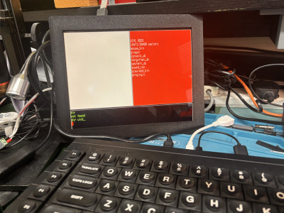

Definitely stuck because of an incompatible mouse. Try without mouse to see it boot.

It was the mouse. I can get it to boot now with a PS2 mouse with a converter but the mouse doesn't work. It boots though and I get the display from the QIMSI board.
I'm going to have to make the 3D printed case more stable though, before the QIMSI PCB pulls out on its own.
